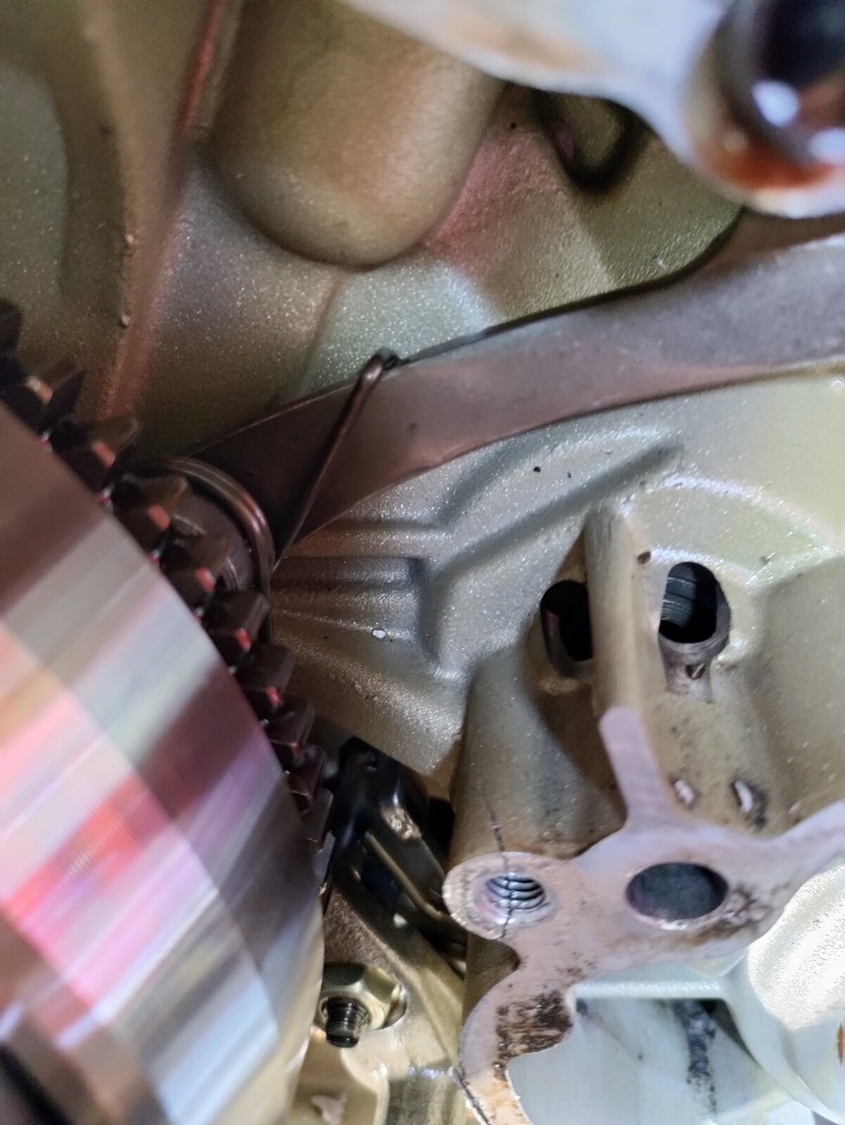

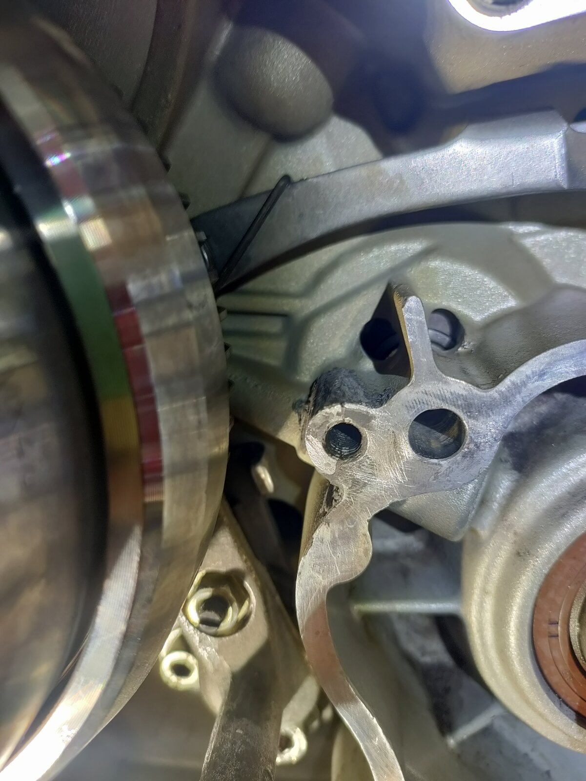

  5. Finally got the parts to start working on the bike and found horrors. The crack is inside the case we're the slave is bolting up. What would you do to solve this? JB weld? Welding? I can't weld here so then it's engine out.
  6. That crack appears to be where the alternator case bolts to the crank case - maybe the bolt that is hidden behind the slave?
    If that’s the case (excuse pun) then it needs to be properly repaired as it is needed to make sure the alternator case is evenly applying pressure to the mating face of the crank cases. If that cannot be correctly torqued up then there will be a large span between the adjacent attachments and you will likely have a leak.
    I think the case needs proper welding and a new thread/helicoil. Make sure that the mating faces are super flat after welding.
    What a pain in the butt!
  7. You're right. It's for the alternator cover behind the salve.
    Total crap. I need to find a welder. Thanks for quick response.

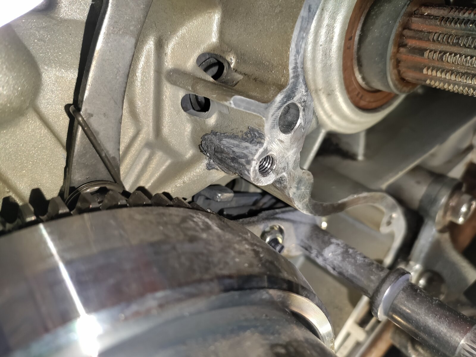

  18. First jb weld was a total failure. Tried to heat it so it would go in to the crack. Which it did, about 0.1 mm.
    Next i tried to open it with a screwdriver resulting in the pice breaking off.
    Now the second time it holds 10 nm no problem. Let's hope it holds over time. What do you guys think of this "professional" work? Thinking heat cycles and vibrations might be a problem. Otherwise I can't see that it would be under heavy load other than the 10 nm.
    After the picture was taken i sanded it down a bit and put a new light coat on extending the repair a little.
