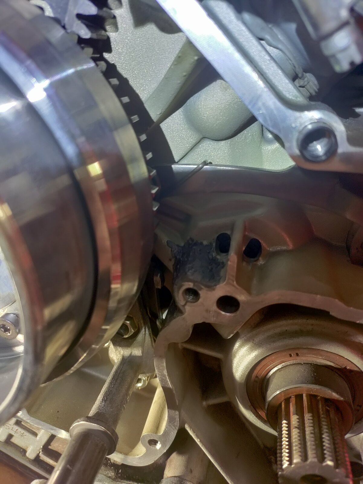

  1. I’d get a lot more built up around it just to support the broken off bit as much as possible.
  2. Alright, i was prepared for people saying I've used to much. I will then add a couple of layers will waiting for a new alternator cover. Once I found my case damage i damaged my new to me used cover in frustration. I'm in to destroying stuff these days.
  3. Just take it steady - make sure the job is done well.
    I agree that a bit more JB Weld around the area of damage would be helpful and for added security.
    #43 RickyX, Nov 25, 2022
  4. Thanks to both of you for the tip, will do. I keep you posted.
  5. What's this magic JB WELD you mentioned? I need to get some of that.
  6. It's the world famous magic epoxy. I've used it alot with great result for many years. Never in an engine tough so this is the first time. Like with sex, the question is, will it work?
  7. JB Weld is just a brand of chemical metal but it seems to work well. Always useful to keep in the tool kit.

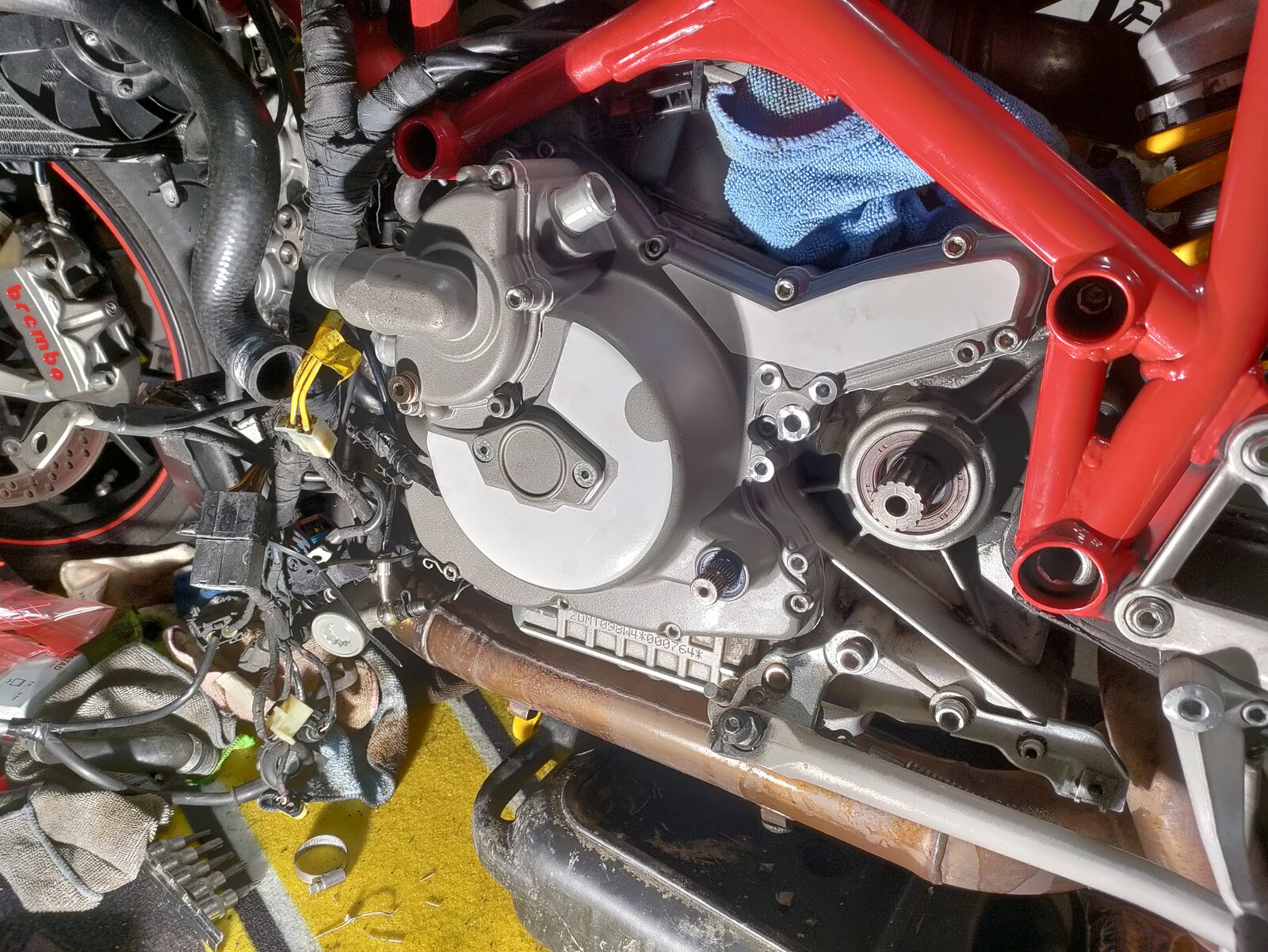

  8. Here is the final part of jb weld and new cover on.

  14. A "case saver" which have been mentioned before could have possibly reduced the damage. I've googled but never found one for our bikes which you can use with the OEM cover but it's pretty easy to make your own
    This is all my fault, I've previously seen that the chain started biding but i thought it can wait a little while. I was wrong.

  15. Update: i can gladly report that the jb weld Ducati has now done over 2 000 km without any issue. Let's hope it stays that way.
  16. Great news!
  17. Thanks for the help RickyX.
    If nothing happens i plan on swapping the case during engine rebuild but so far so good.
