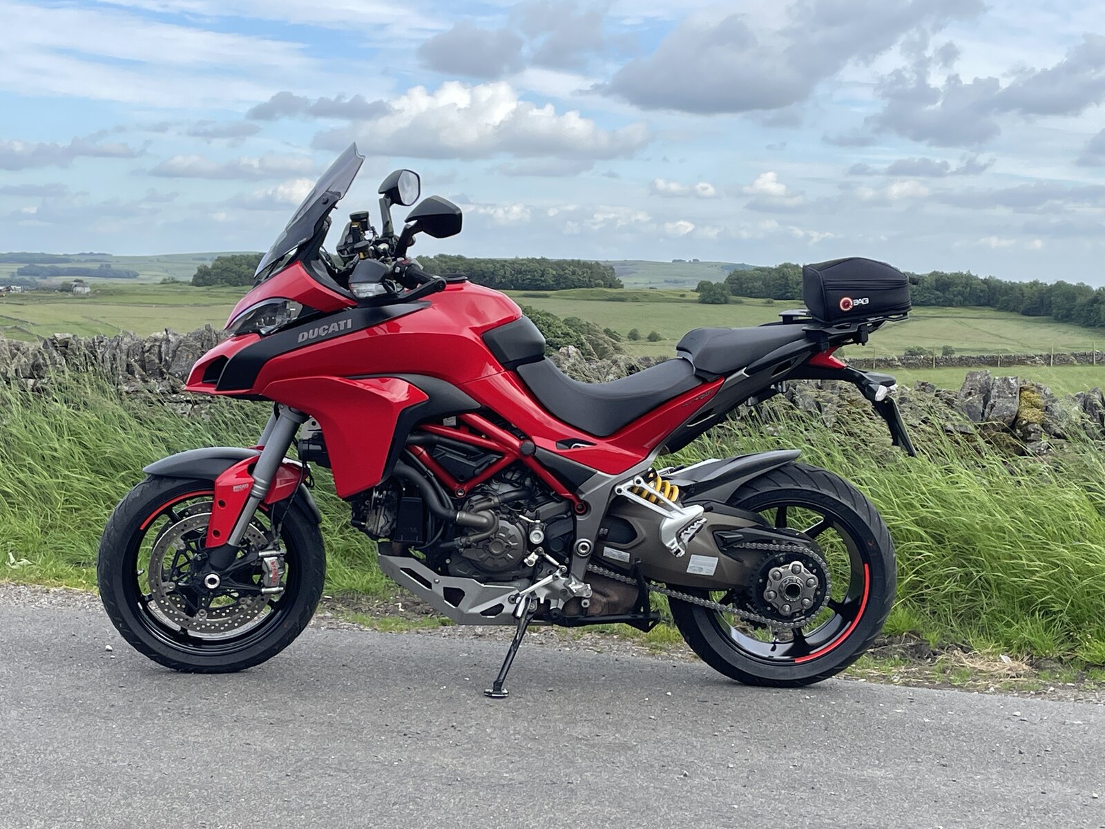

  8. managed to get a few hours blast around the peaks tonight and definitely feels a lot better with the 2 more teeth, even wondering if I could have gone 3 up as I still found it a tad laboured around town at crawling speeds but its certainly improved for sure!!
    took a spanner out with me and adjusted the gearshift position and massively improved that too!
    2 things im not happy with and thats the throttle is slightly snatchy like on/off when im bringing it on its quite jolty, and the rear brake is pants, I tried stamping on it and its very faded, feels like the pads aren't biting enough!
    I did try a brake bleed but the pedals not long, its just not biting so might try some sintered rear pads and try another bleed with some 5.1 brake fluid as the stuff I had was just laying about but pedal doesn't feel bad or long.
    other than that im loving the bike for sure, very different to my little tiger 800 I had. IMG_7628.JPG

  11. That’s a nice tidy bag you have on the back end.
  12. it’s just a cheap bag I bought a few years ago that I had on my tiger and to be honest it’s not been a bad bag at all for the price, think I paid like £20 online from sportsbikeshop!
    Q bag they’re called.

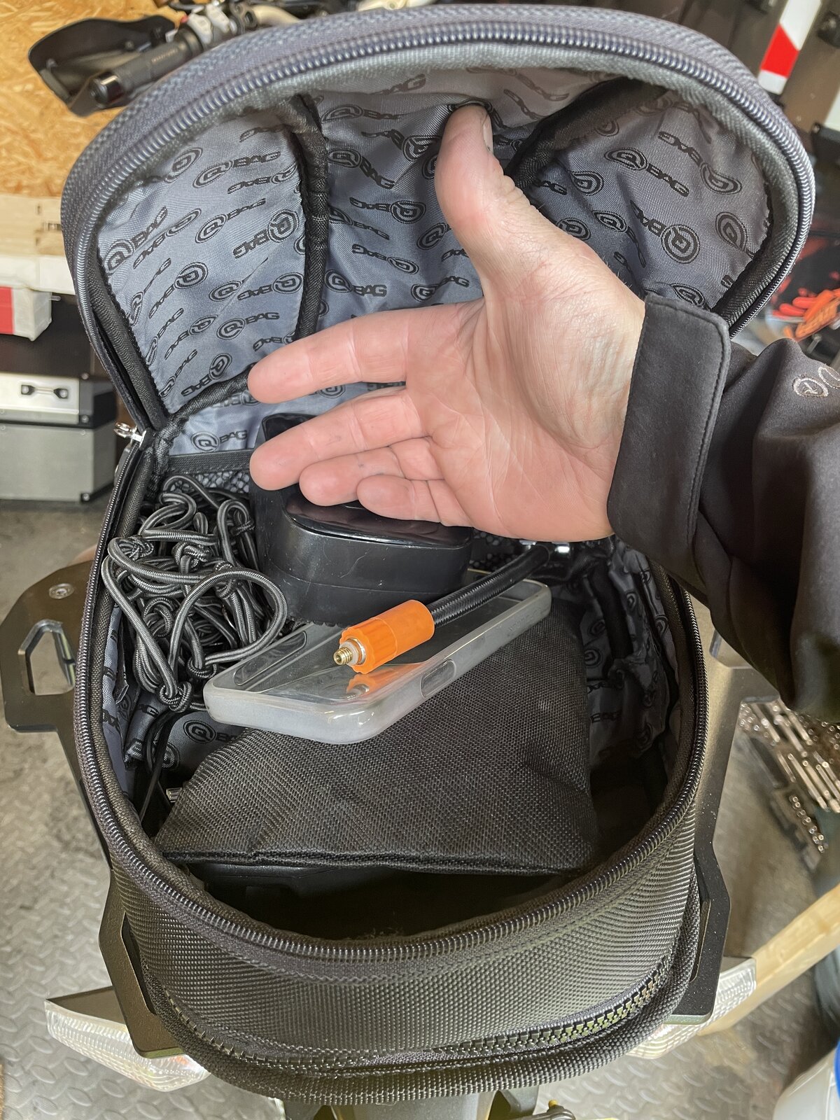

  13. Can you give me some idea of how much it would hold?
    here’s a pic with my hand to show the room pal, not huge but carries all the essential bits like a big bag of chips
  15. Looks good to me, thanks:upyeah:
