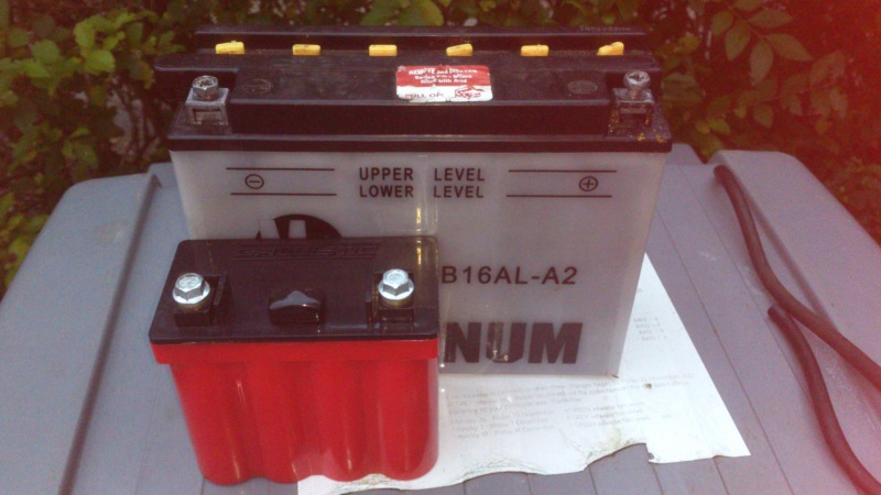

    I picked up the little red battery and looked at either side, bemused by its apparent lack of size or weight? It felt plastic, like a large Lego brick. I was completely flummoxed how this was going to spin a cold twin over?? Battery's were huge things, bubbles and acid, witchcraft?? It said i was a real one but It felt like a toy one, I could imagine a boy "removing" it from his ride-in toy car using plastic spanners... :biggrin:

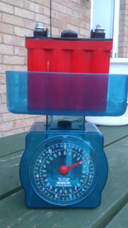

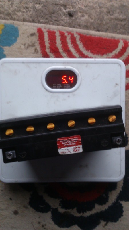

    Weghing in at 800g for the Ballistic, and 5.4kg for the old lead/acid? (Note calibrated scientific measuring equipment) :upyeah:

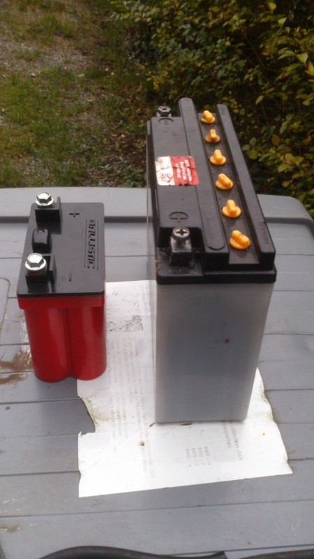

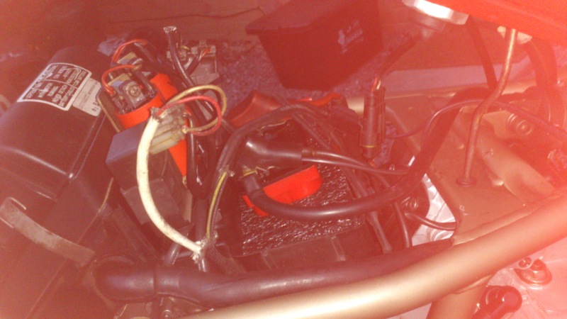

    There was a huge crater for the new battery to fit in?? I considered raising it up so the old rubber straps could be used, but settled for trimming the excess off the foam packing the battery came in to hold it in place.

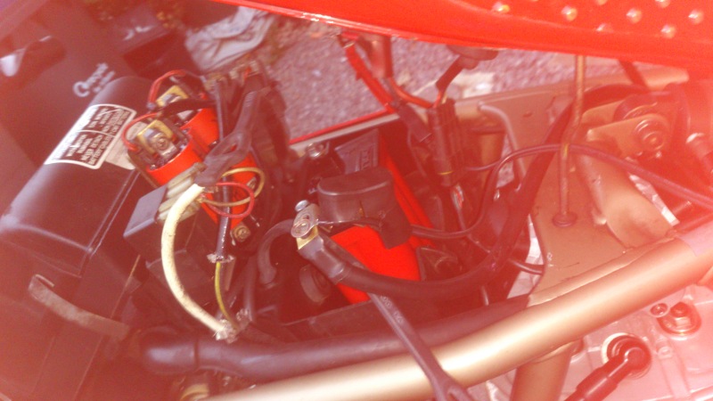

    Minor faff with the leads? I have an extra lead going from the battery neg to the engine earth, and another from the battery pos to the starter solenoid - spins a LOT better!
    The pos and neg contacts were on the wrong side of the battery, meaning I had to trim the terminal surrounds off with a hacksaw so the battery leads would mount with the battery in the "wrong" way round? Had to flatten out the steps in the lead ends so they sat flat then All good!
    Ignition on, all lights up!
