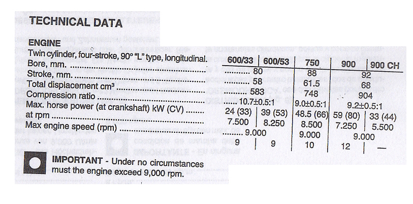

  18. Any help? Not really, I guess - but at least some questions it may answer. SSENG.jpg
    #78 Ghost Rider, May 11, 2017
  19. I'm given to believe that the M600's 2003 change to 620 cc brought it to the same stroke = 81.5mm (and crank?). I could consider a monster 620 engine, could be useful. Not sure if that is a straight swap, or if the monster frame had changed by then.....
