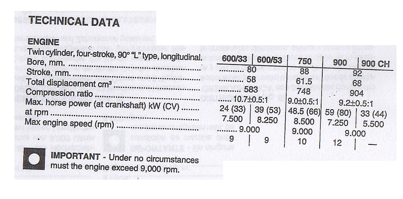

  1. not really ; no revving over 9,000 rpm 'under any circumstances' - the writer lacks imagination. :grin: Hiroshima, 1945?

  8. So you think Ducati lack imagination? The extract is from the 1997 Owner's Handbook.
    Maybe that's why your piston gudegeon pin bosses are shagged - someone has been over-revving it.

  12. That could be true, hadn't quite crossed my mind - something I would never do - overrevving as the cause of it. No I don't think Ducati lack imagination, it was my lame effort at a joke. :)
