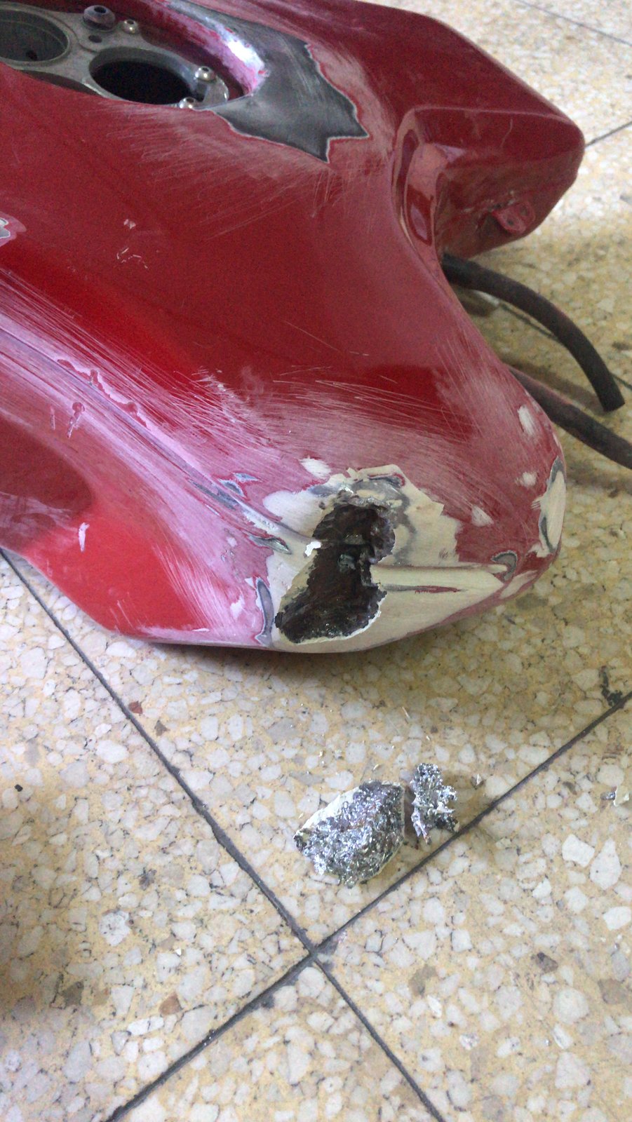

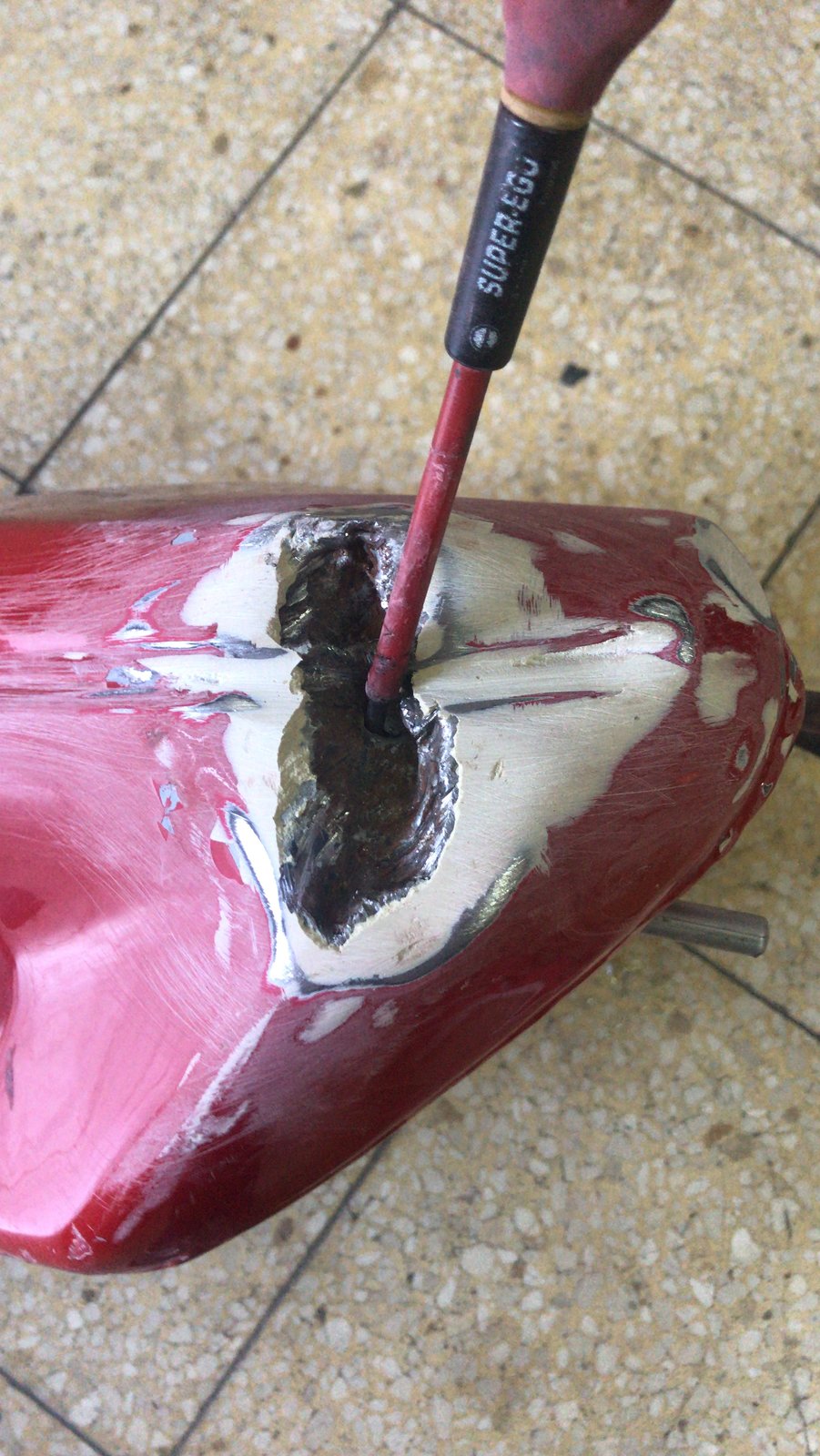

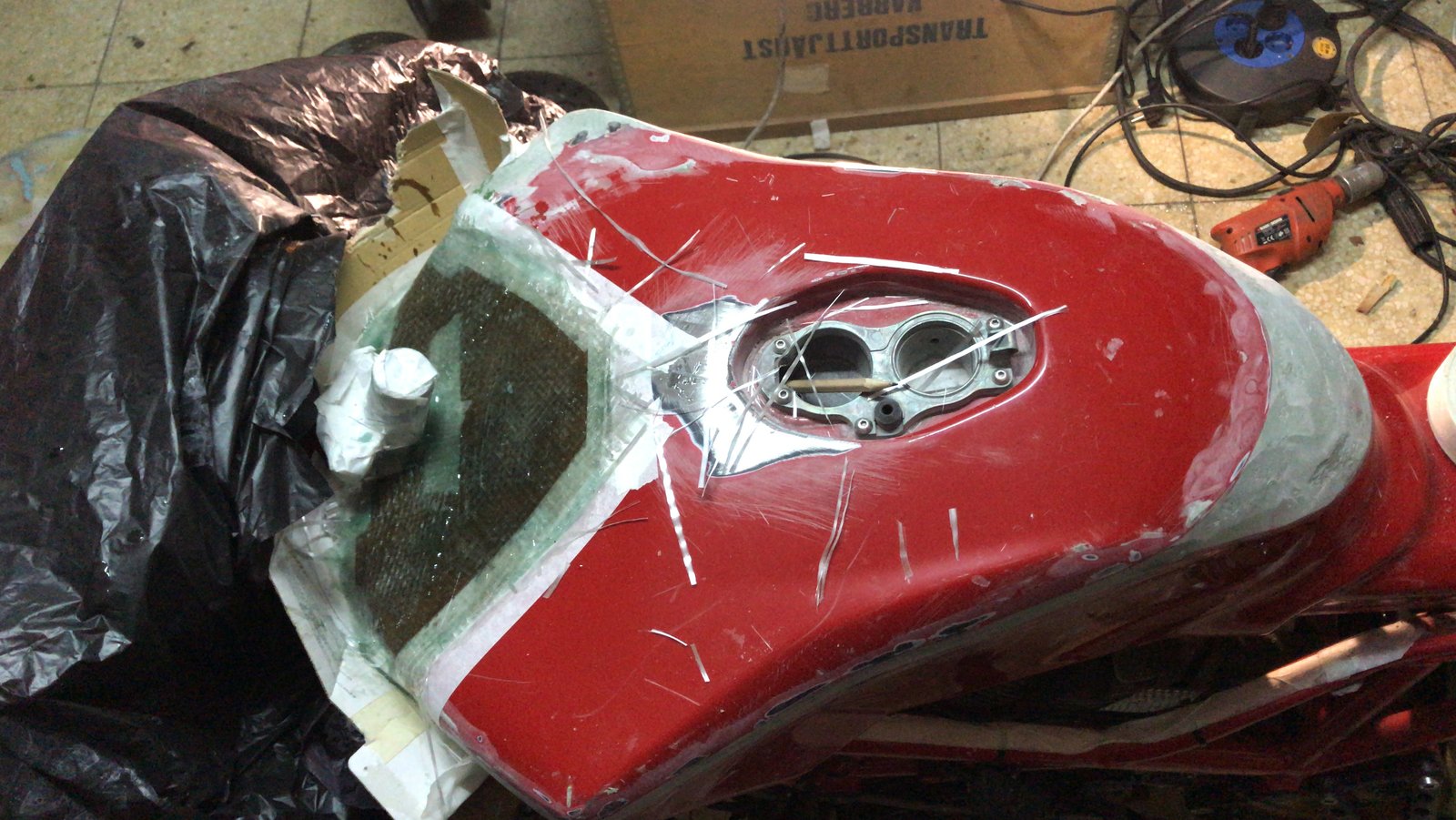

  1. Mmmmmmmm The fuel tank that I purchased had a little secret ventilation hole........
  2. Oooh shit..... :(

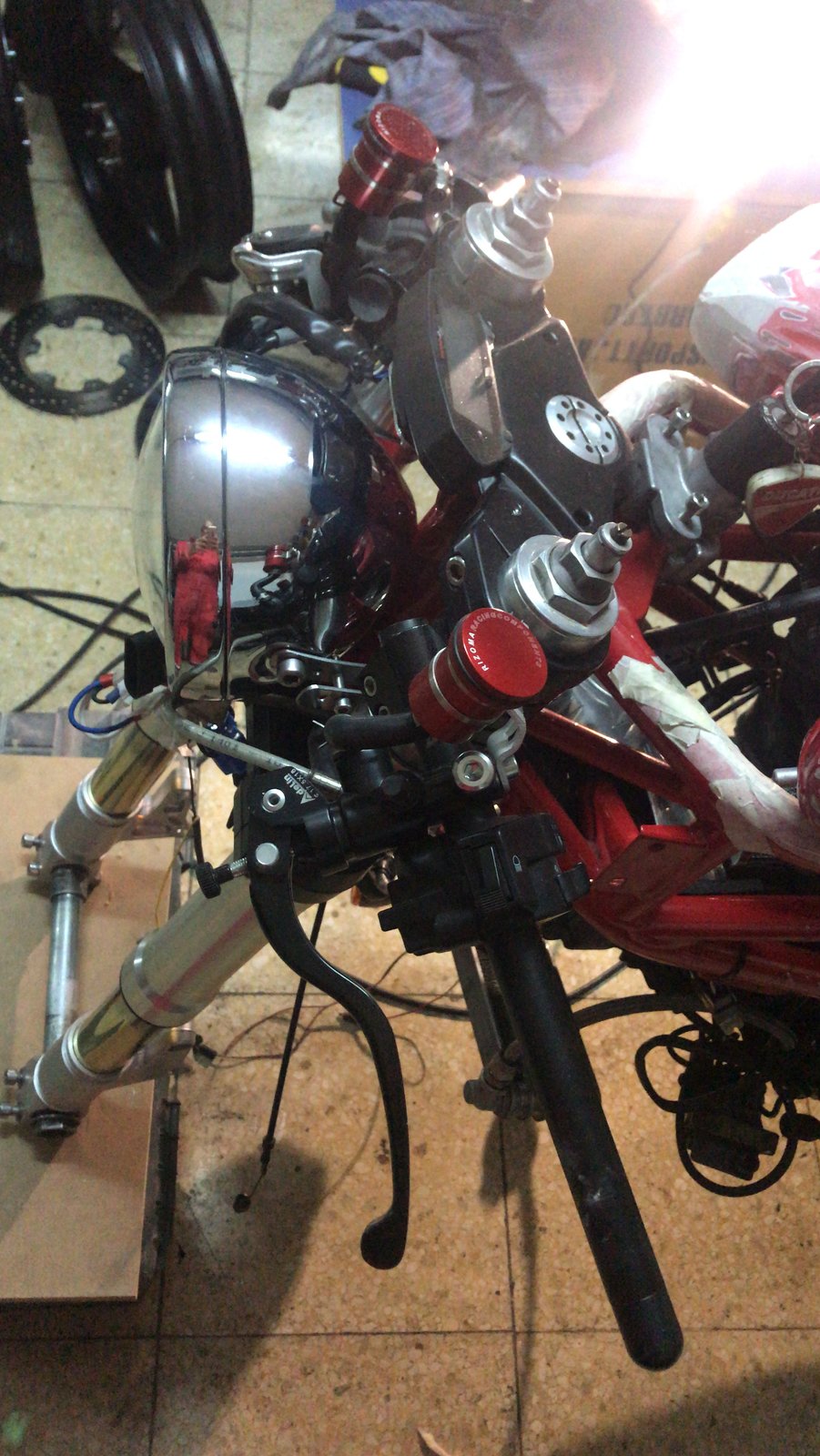

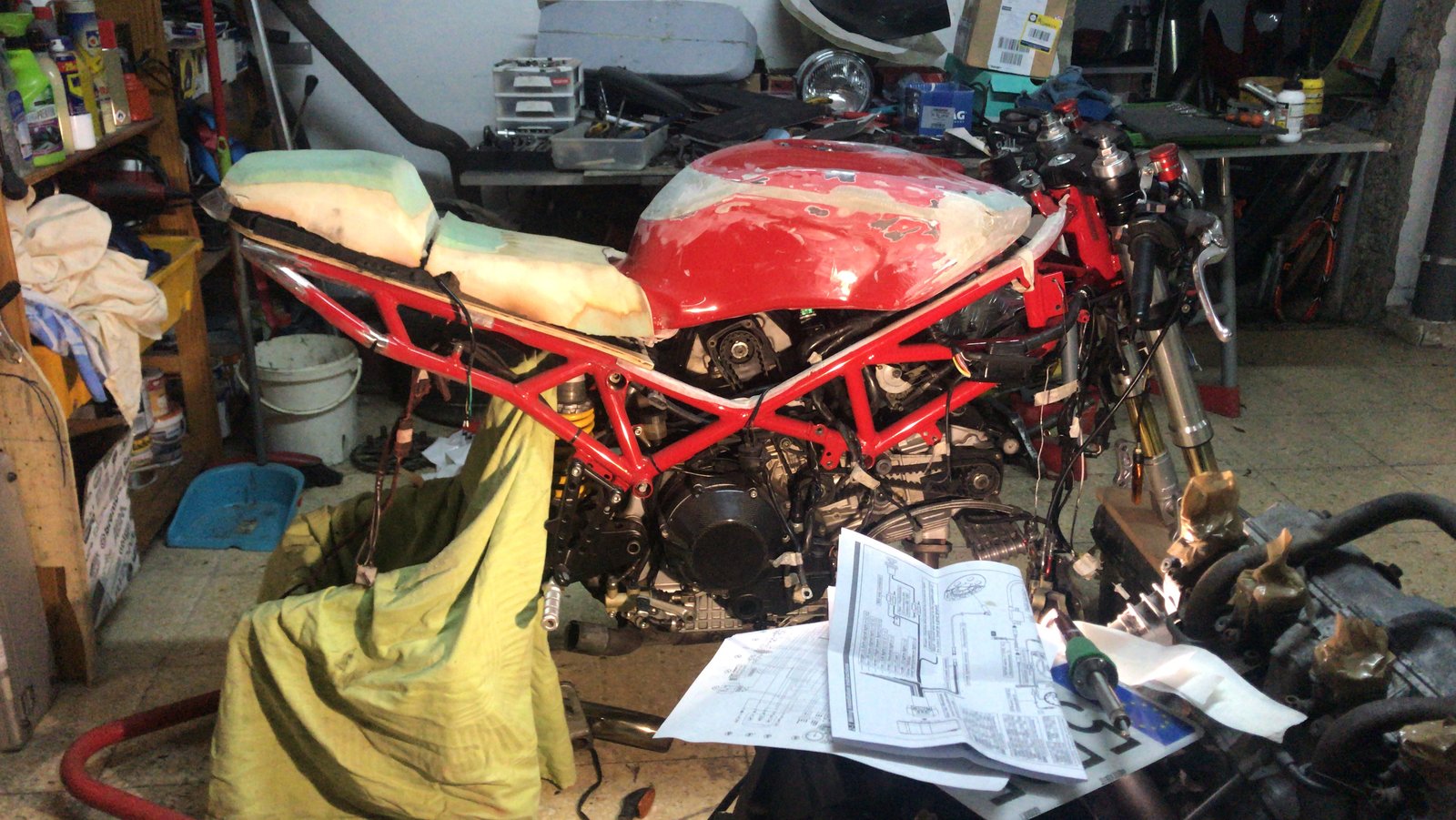

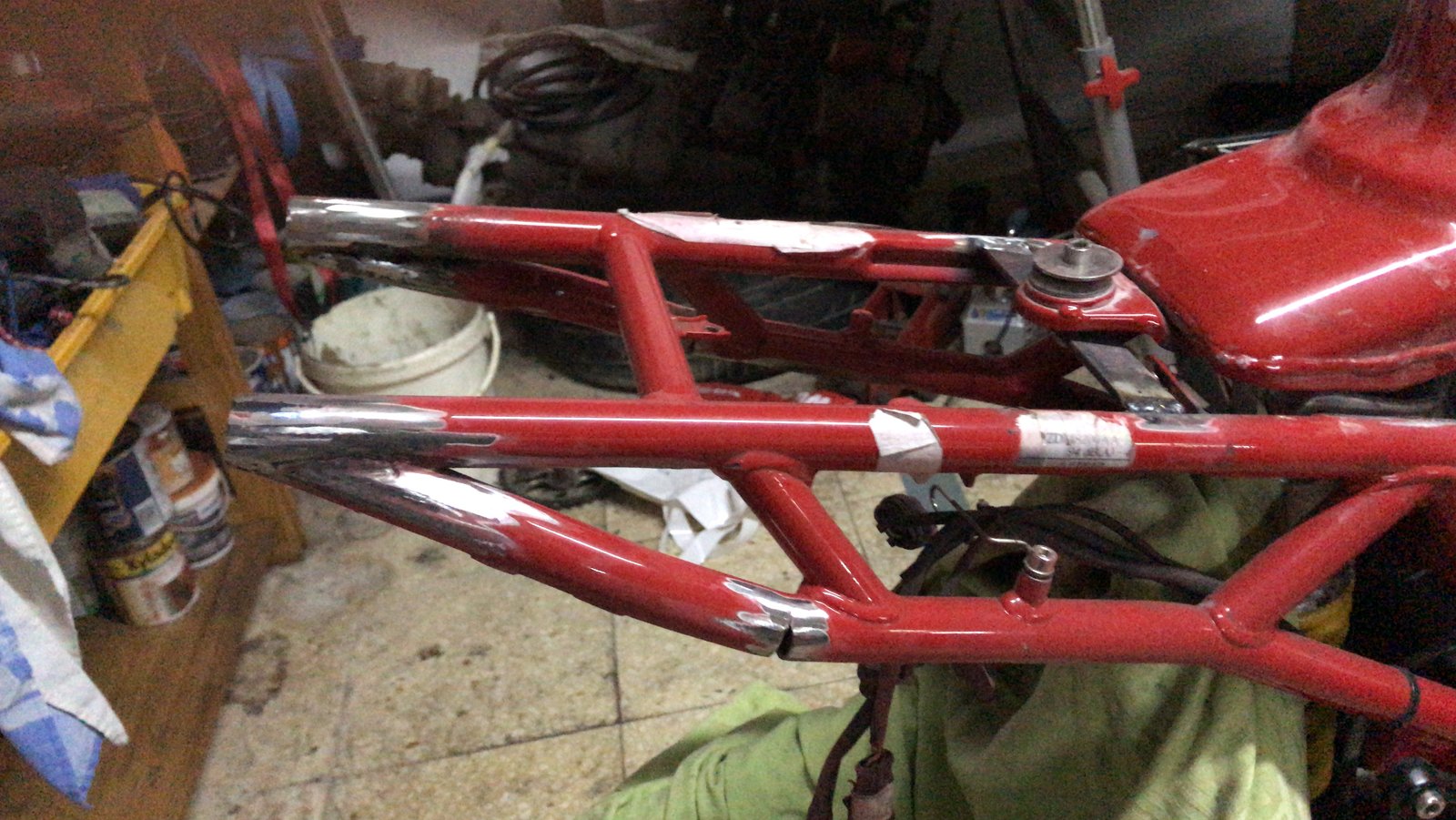

  3. I have shortened, bended and beguin to weld the subframe this afternoon.
    I have also made a new support for the fuel tank
  4. I have weld the “hole” in fuel tank, to be honest Im already searching for an other tank...

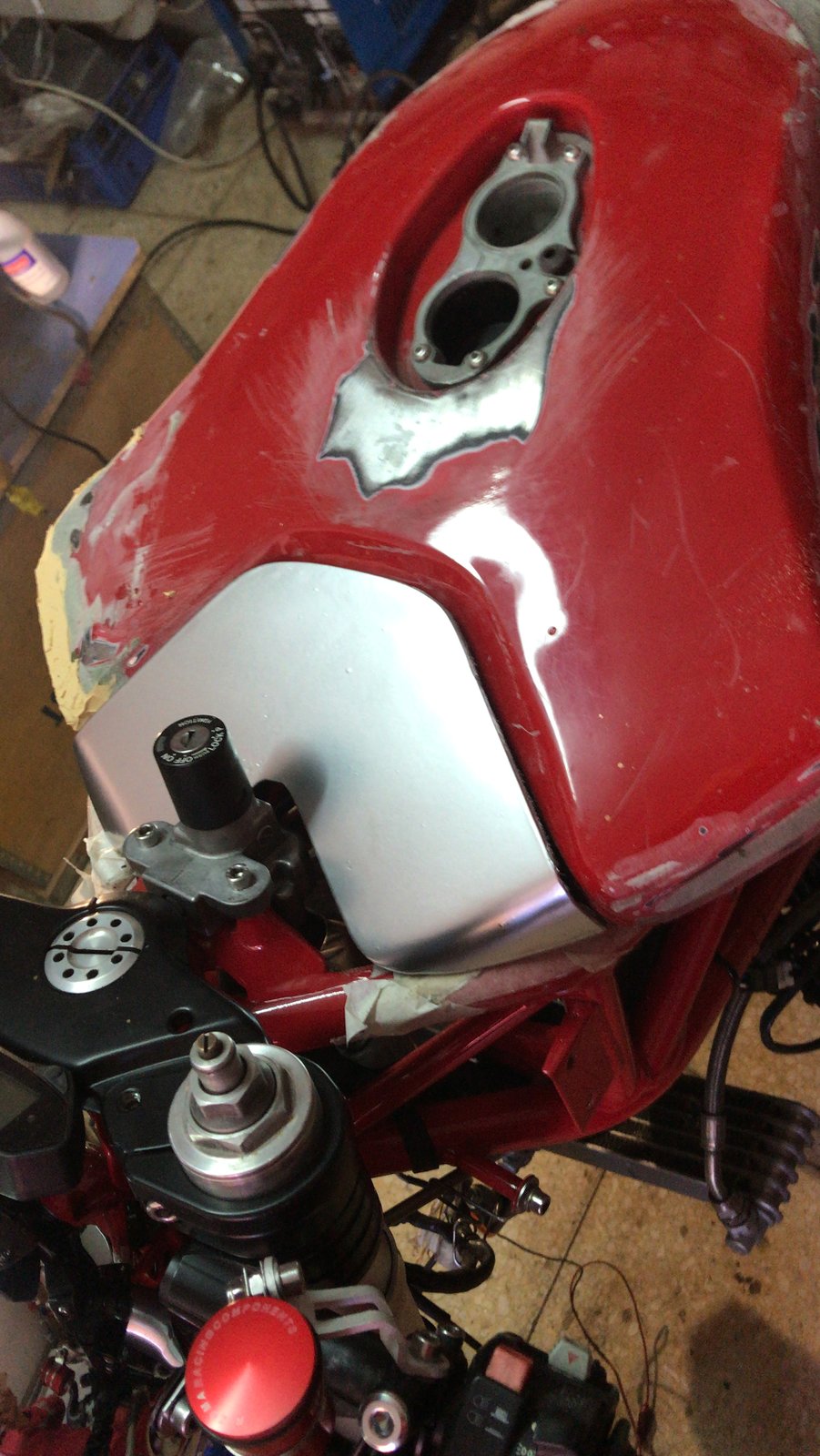

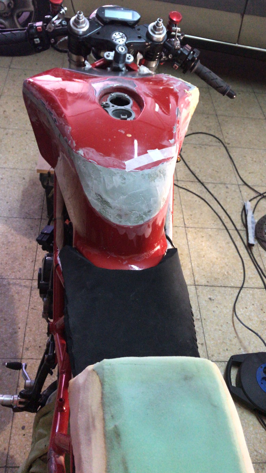

    I’m also beginning to give shape at the seat
  5. This afternoon I begin making the positive mould for the cover around the key switch
  6. I finished the positive mould for tank panel this morning so next step is to make the negative mold and make the final part, I did also the base for the base to be available to finish the seat unit

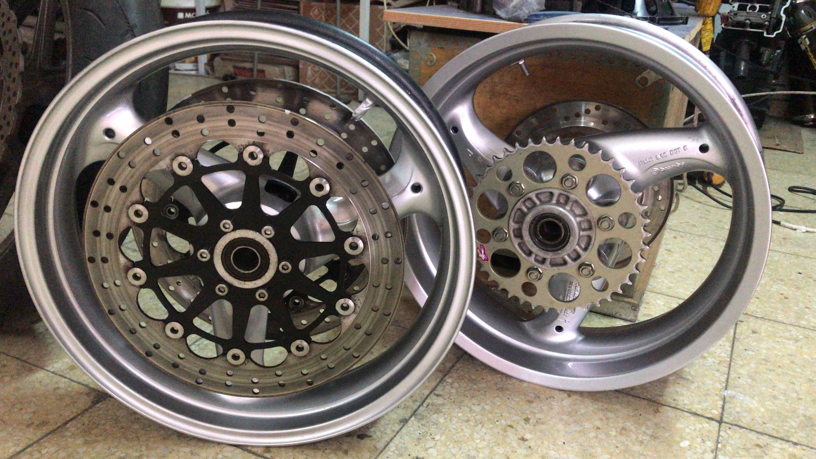

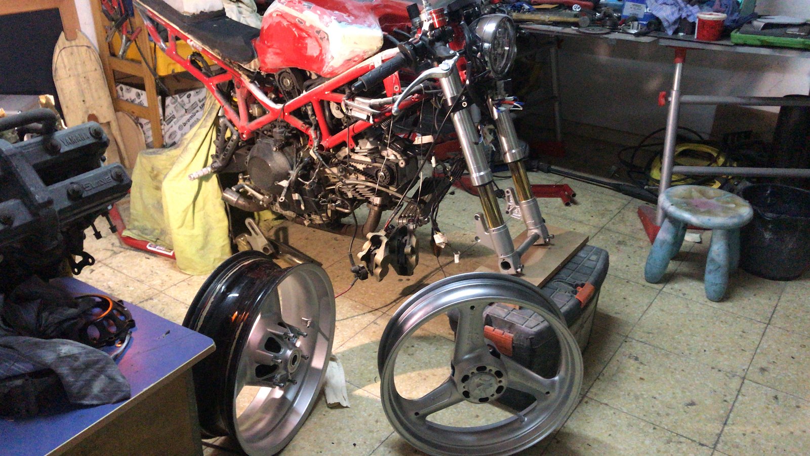

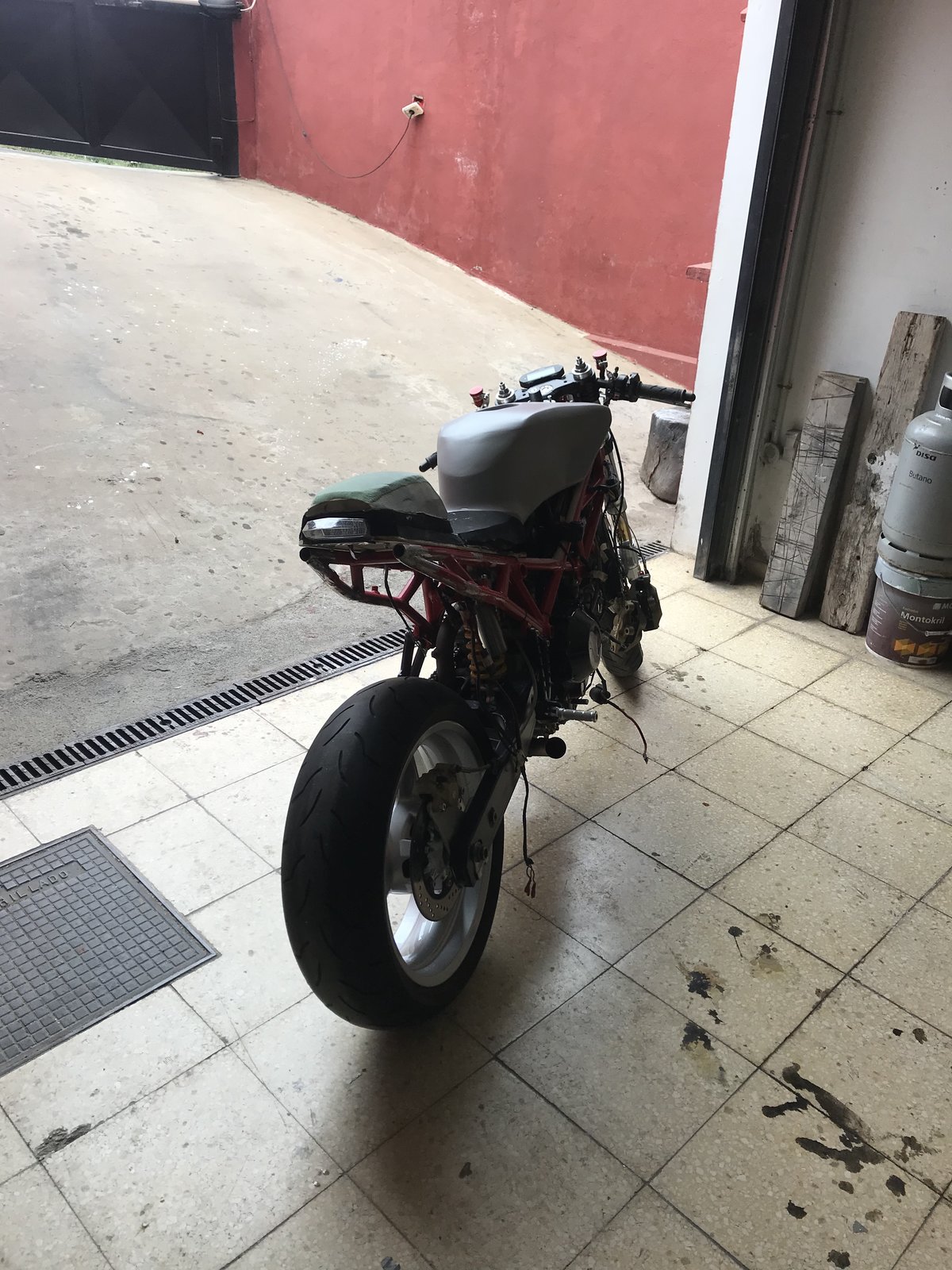

  7. I sprayed the rims in silver this afternoon to give more brightness tone when I paint them red, but now I’m reconsidering to let them be in silver as I think they looks great!
    What do you think?
  8. Yep. Look really good and i think red wheels on red bike is too much redness but @Ducbird probably disagree or maybe even nuke me.
  9. Too much red :)
  10. The fuel tank will be satin black with red Ducati logo and stripes, red chassis
  11. Really not sure about the red wheels, even with black :thinkingface: but only you can see the end result in your head at the moment :)
  12. One thing that that always fascinated me is just drive my bike at unknown road without any map just discovering places, I have been doing this whole my life at the half of the world, when I build a bike the same happen.
    I let the bike choose the colores and shape as the proyecto rolls on!
  13. Just go with how you feel.It will look great however you do it.

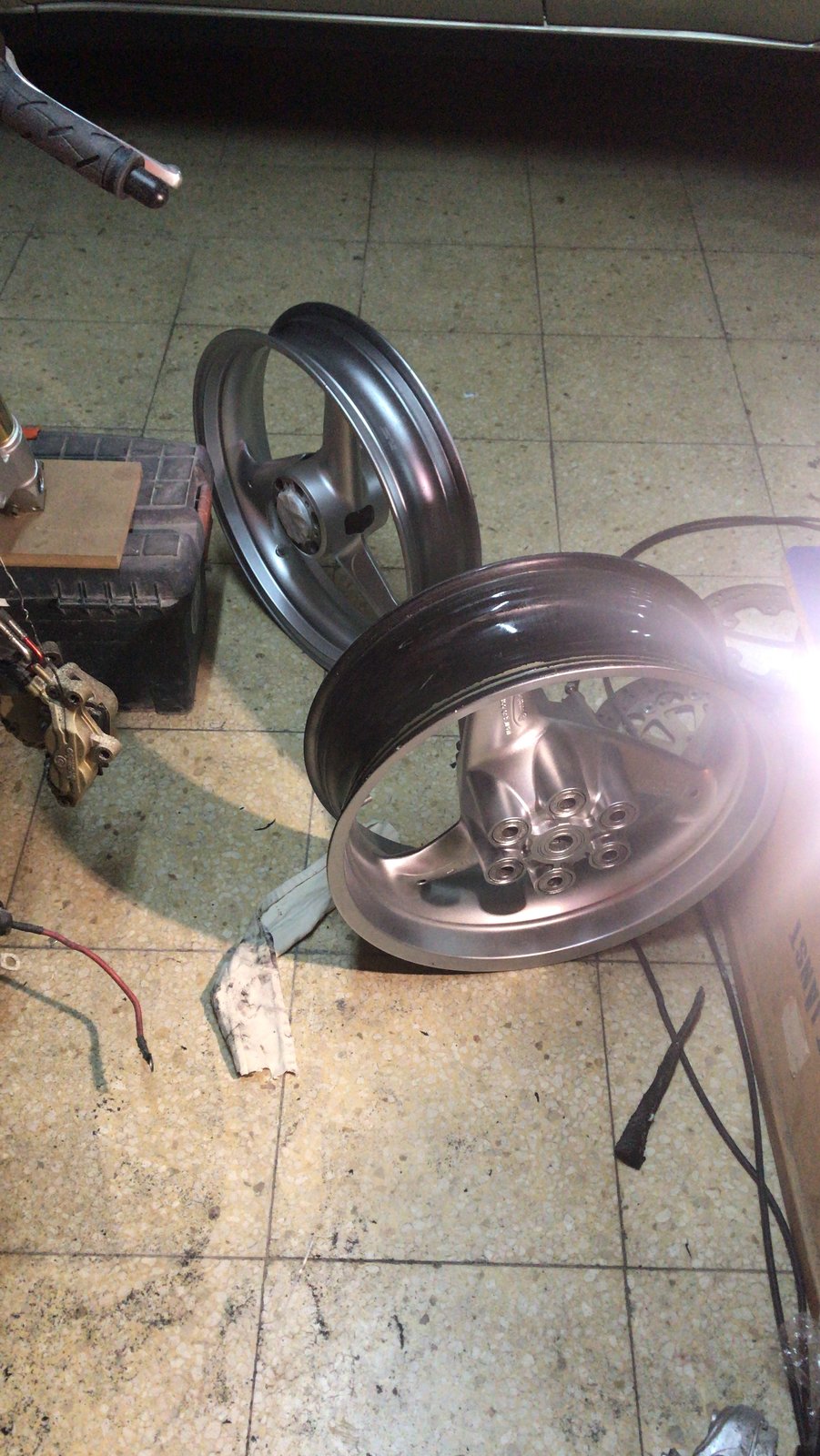

  14. Wheels is now painted and redy to be put on the bike when I’m back after the eastern holidays
  15. Erm, before you do put some tyres on, then they are ready to fit :thinkingface:
    I have Eastern holidays too, they fly in from Praha on Thursday :eyes:
  16. What do you mean easter holidays, i'm off ill and i was relying on this wonderful thread keeping me entertained over the Easter hols, this is just not cricket!
  17. Not cricket but ok
    Of work for a week with SSC (sun,sex and cerveza)
  18. Not only can this extraordinary man build fantastic machines but he also gets British Humour....
  19. Dear Gents & Birdy
    I ended bored of beach time and went home to the holy land at my basement!

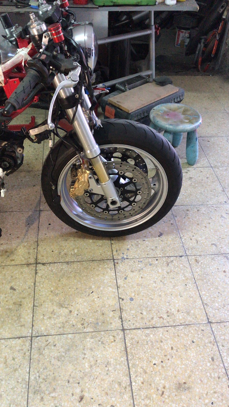

    I finished welding the subframe this morning, wheels on (with tyres;-)
    I had also some base coat on the fuel tank.
    Such a great day I had!
