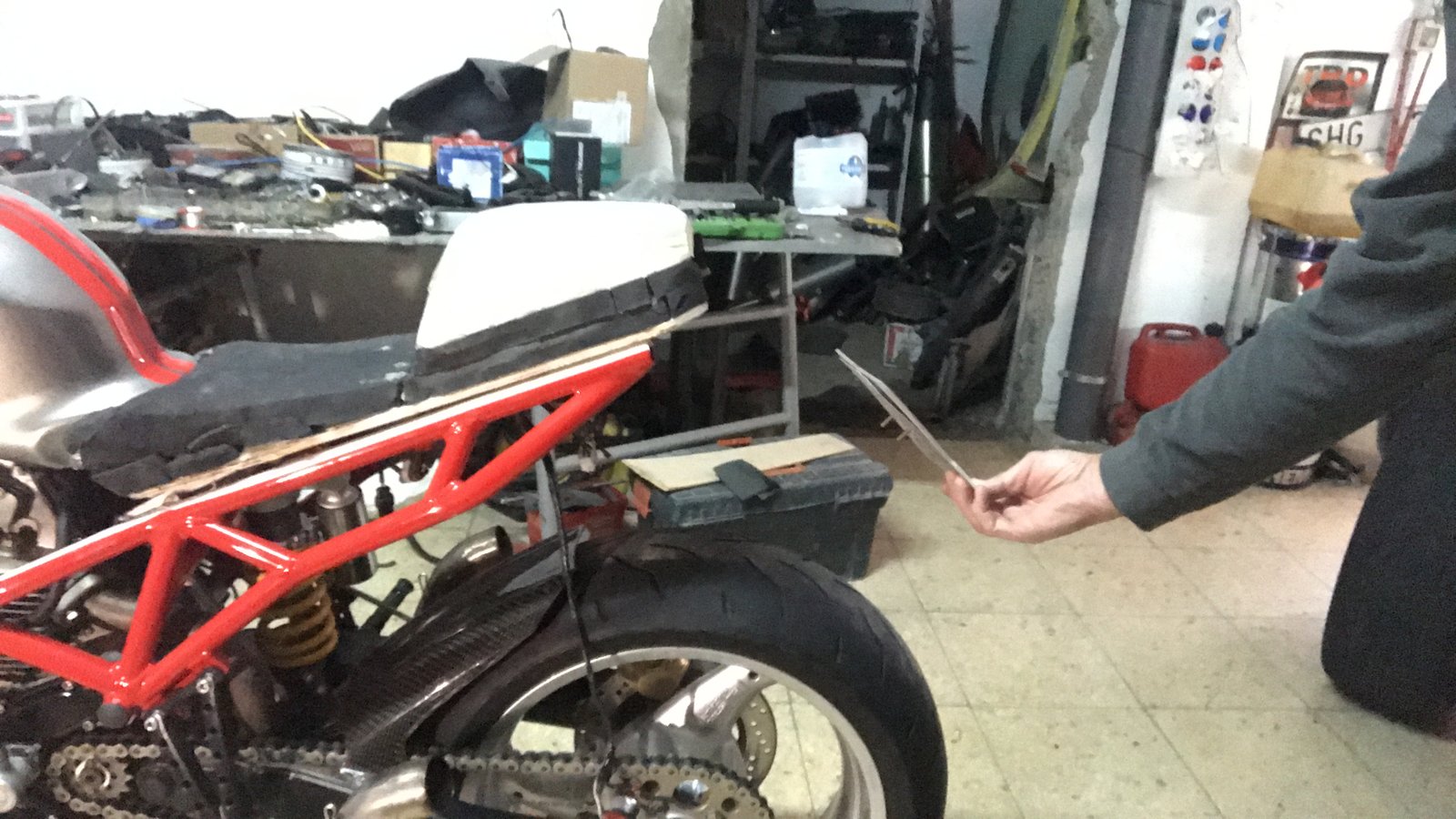

    If you mean a low swingarm mounted plate I don’t like them to much but when it comes to make the bike road legal we have a issue in Spain with where to put the registration plate.
    The thing is that the Spanish law says that the plate has to go further back then the rear wheel, this make things a bit complicated when you want to make a nice rear end at the bike

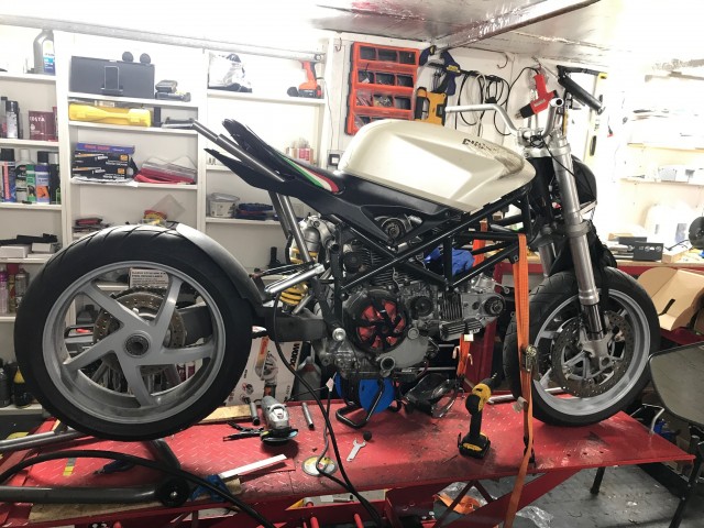

  3. I have fired up the engine today but I had to use the old ST tank as the 999 fuel pump is busted.
    Engine sound great and it’s always a energy impulse when you start the engine on a bike after having it shut down during long time.

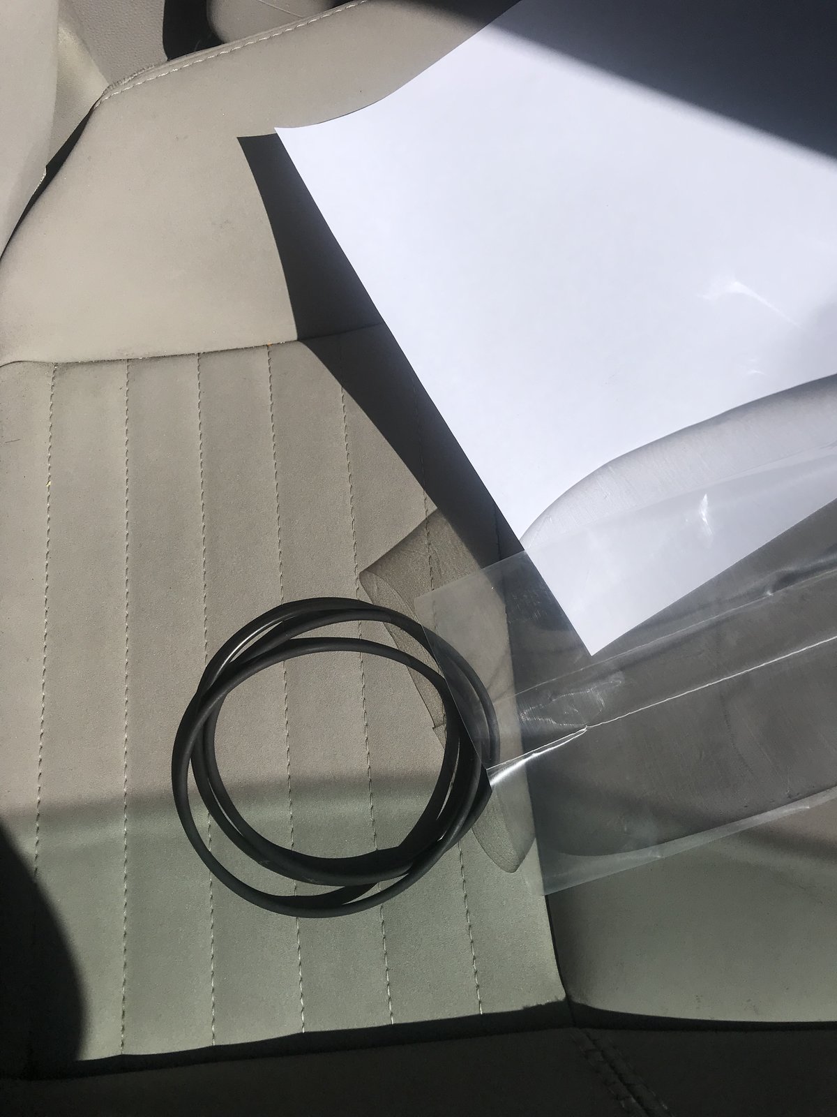

  4. I bought new oring seal for the lower fuel tank cover at a local hydraulic store to day for 5€.
    I’m also struggling with where to put the licenses plate, ast the Spanish law say it has to end after the rear wheel and can’t have a max angle over 30%

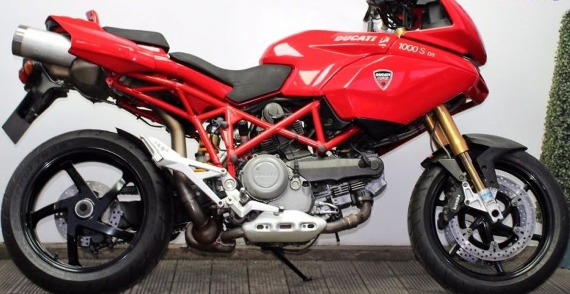

  5. Top thread, loving your work, great inspiration ! just bought a cheap old multistrada ds1000s to chop up in the near future into some sort of street scrambler thingy, pic.jpg
  6. Can you bend the rules a bit. Bike cops mainly likely to pull you and from my experience are sympathetic to a bit of artistic licence!
  7. I have also been looking at the MS1000 for future projects as I think it’s a lovely base,
    It need a new rear frame and fuel tank and.......fun
  8. I have to make one bike for the Spanish MOT and then my street version

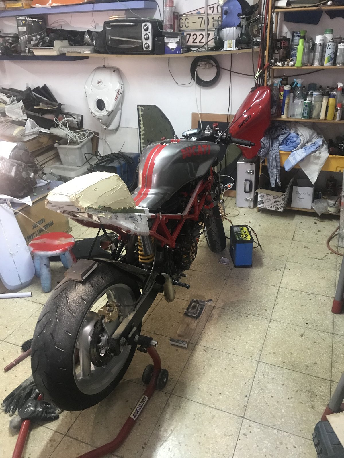

    To day I’m trying to figure out how the rear end shall be....
    I just can’t make up my mind

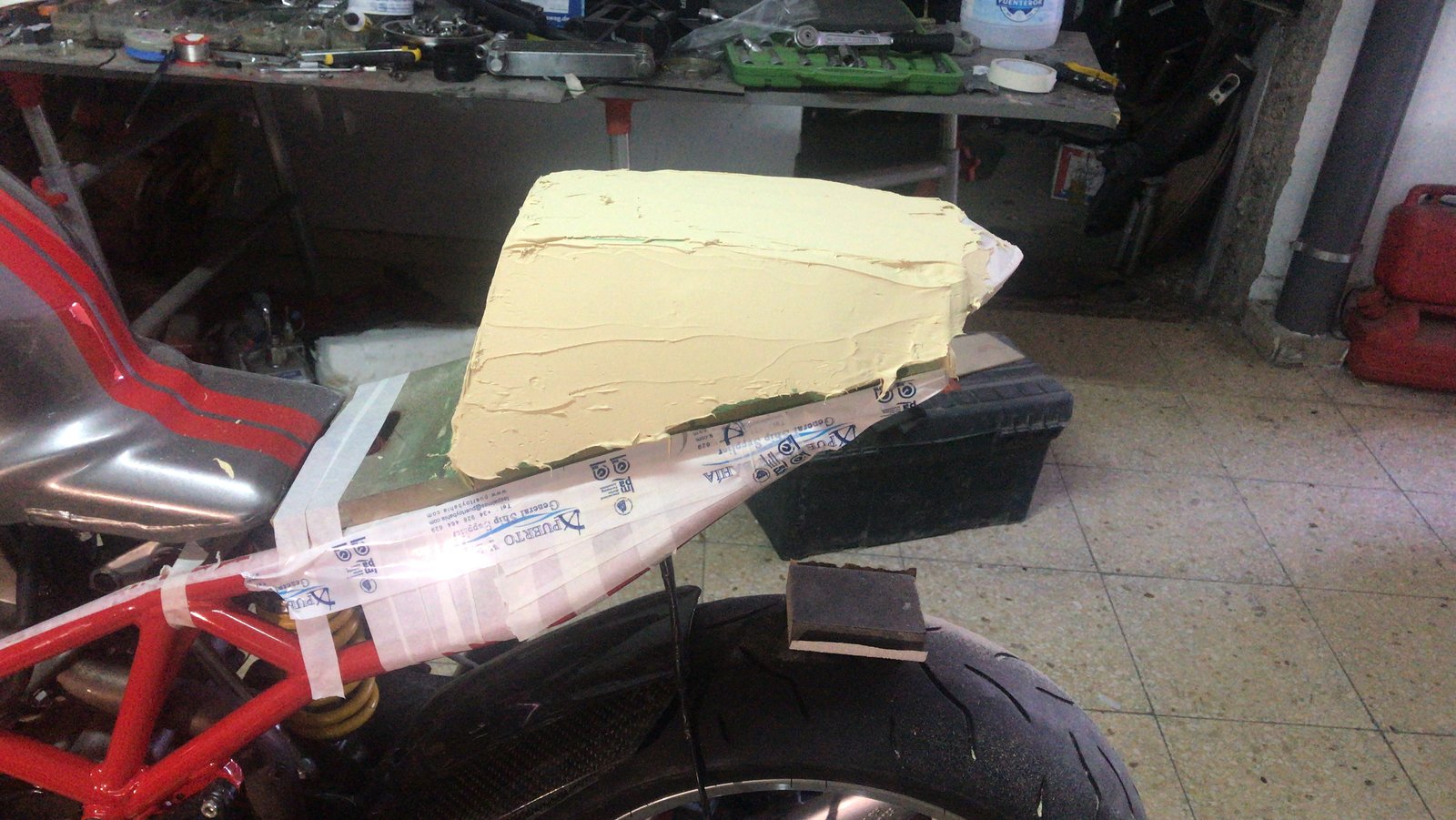

  9. Mmmm
    This is the third seat cover I’m moulding for this bike

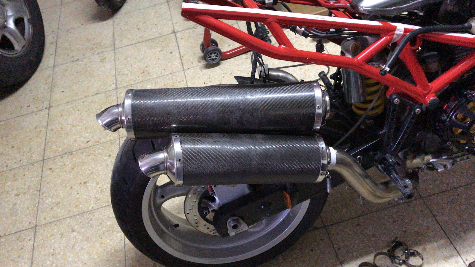

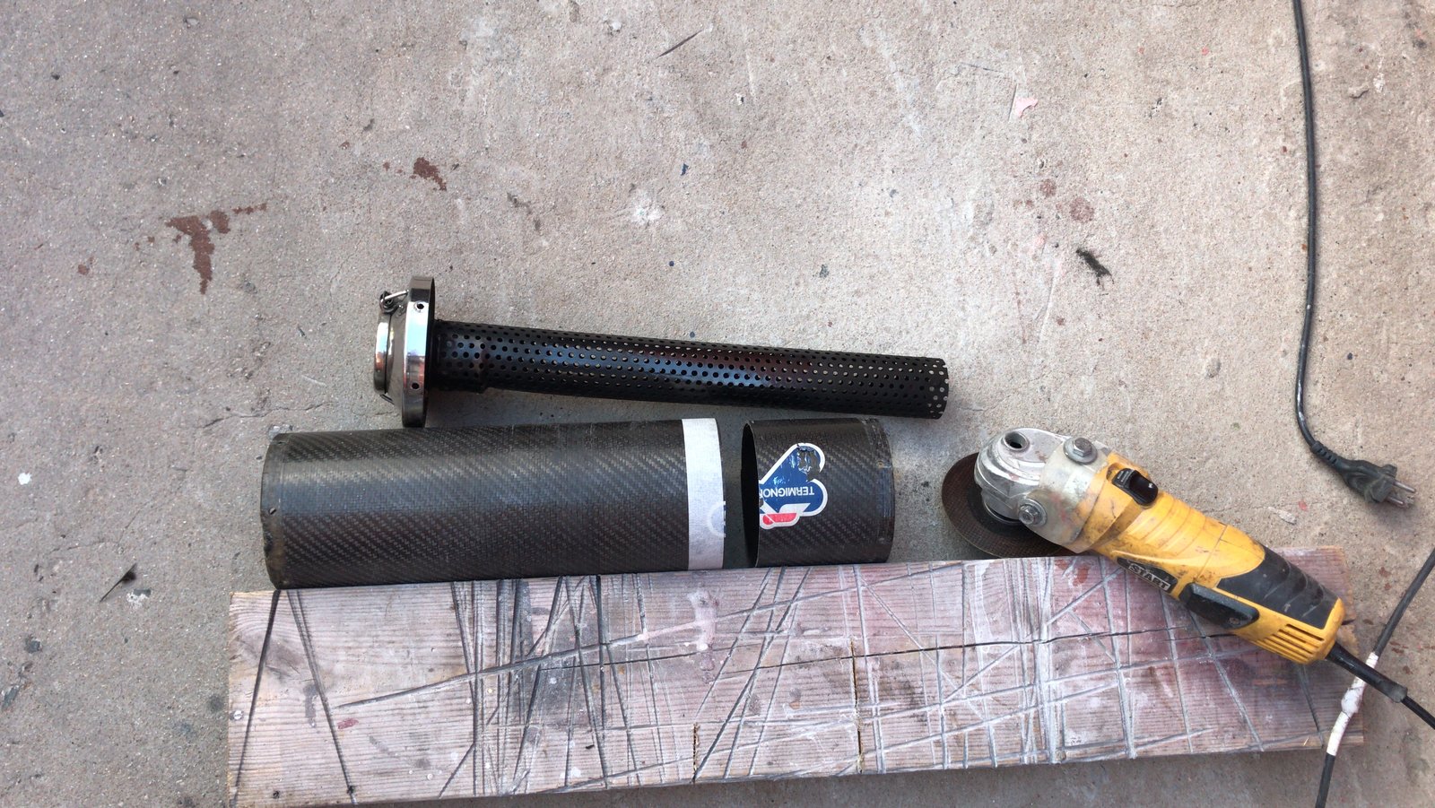

  10. I’m gone use the Termis for legal road use but they just look to long.....
    I chopped off 100mm yesterday and today (after beach) I will clear coat them to get back oem finish that they have lost with the years.

  13. What about a suzuki tl1000 with gsxr forks and a ducati/honda/triumph side sided swing arm and then be creative with the body work?
  14. I still have my Raptor 1000 with more or less that preparation, One thing I don’t like at the Raptor is the fuel tank so I’m considering design a new unit...
