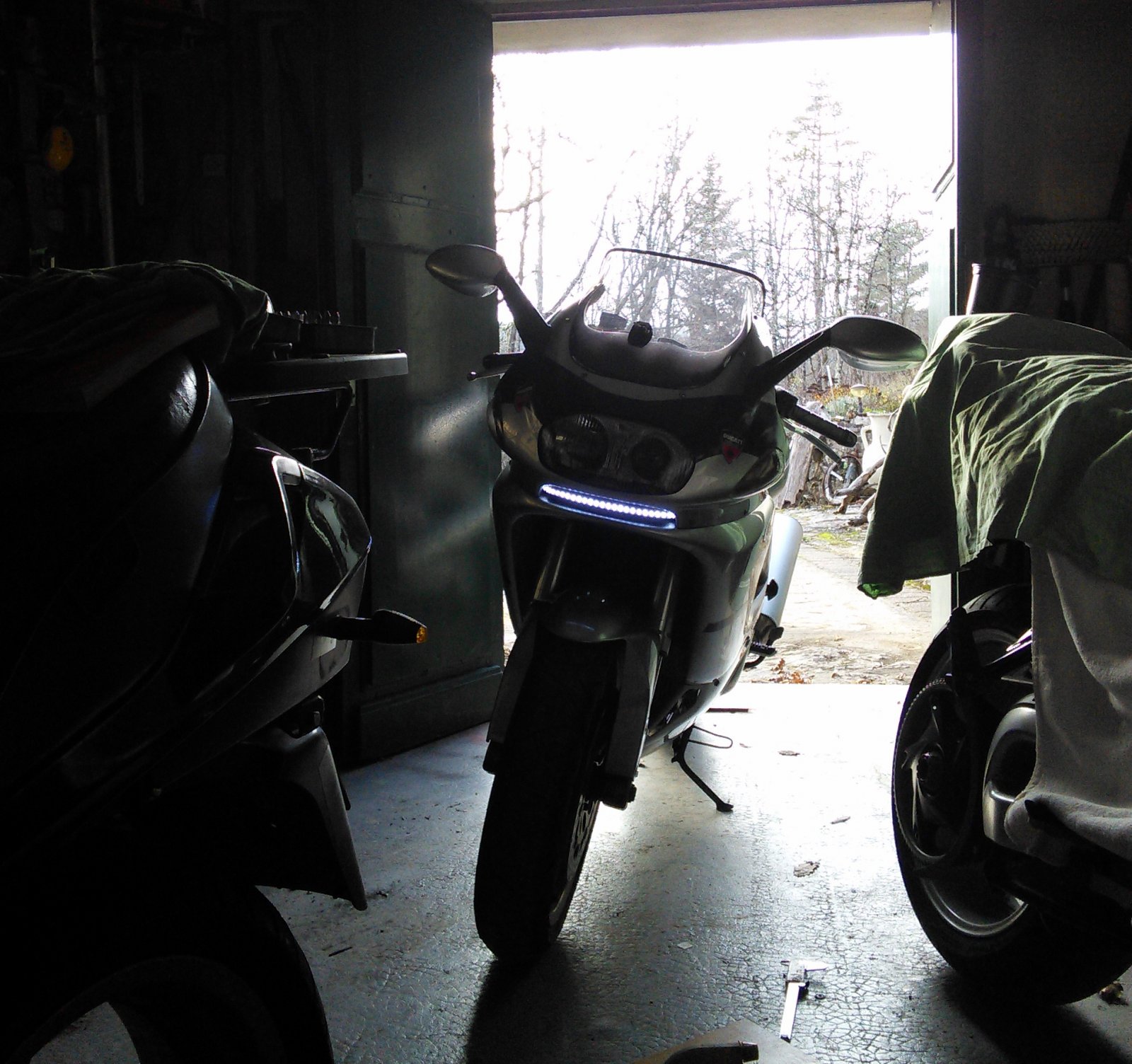

    Latest idea. Fit a Audi style DRL LED strip under the headlight. Works much better then the photo shows. With that on and all the connections to battery removed, cleaned and refitted, I am getting 13.9 to 14.1 volts showing while riding.
  6. Like it... Nice one !
  7. That looks super, and acceptable voltage figures too, looks like job done... I want one for the ST4 lol
  8. If I could still get the same types of LEDs from ebay then I would be happy to make one up, but they are all SMD LEDs now and would be a bit more difficult to fit in the same position. You could fit an SMD strip just below the intake and as long as you used 5050 LEDs it would look just as good.
  9. I meant to say that I have wired this to the same circuit that I fitted to power the voltmeter. That means that they come on with the ignition and cannot be switched off, but do not need the headlights switched on at all. They could be wired through a small hidden switch if needed as they use so little power.
