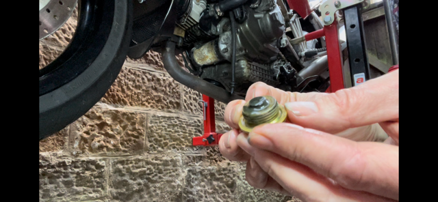

  10. Draining the oil and having a look at it might reveal something. Check the drain plug magnet for metallic evidence of the ferrous variety too.
  11. So, I dropped the oil to find no evidence of debris on the sump plug. a bit dirty, but definitely no shards or shrapnel.
