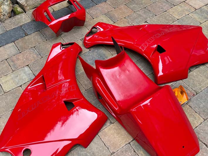

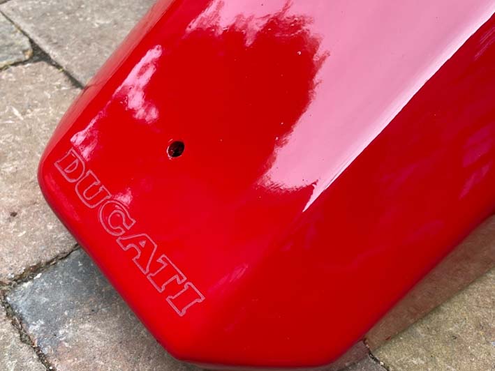

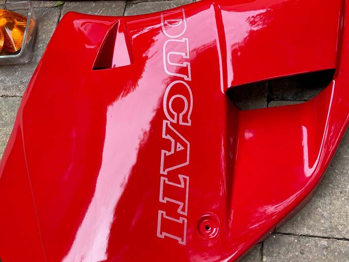

  1. I’ll admit now I have limited experience with painting. I have just enough confidence in my ability to do my own bike, but would struggle to have anyone reach for their wallet. With this in mind, I am actually quite pleased with the results of my weekend tucked away in a small spray booth.
    They say 90% of the work is preparation and I would agree whole heartedly. The panels I bought were lovely and smooth, so only needed minor prep. That left me around 10% to do.
    I painted the Monster earlier in the year and didn’t take the tank back to bare metal. The resulting finish is ‘vintage’ just without the years of weathering. Age appropriate I guess. Anyway, I was determined to do better this time.
    Our workshop has many very useful machines and equipment, including a spray booth, which made the decision to do things myself all the more easier. HVLP spray gun and top quality paints. I also have a vinyl cutter, so was able to cut some really simple Ducati logo decals for the panels.
    The result?
    There are a few drips here and there and a couple of spots where the paint ‘dusted’ causing a bit of a flat finish. I’ll mount the bodywork and use the bike as a jig for the polishing. Should come up really nicely, as I gave it at least three coats of laquer.

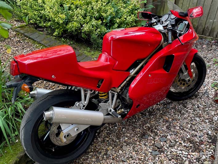

    The whole concept behind this build was to put a new suit on the ST2, because I am not a fan of the ST styling. No finer suit than that of the 851 / 888 era bikes (in my opinion). Pics etc to follow soon...
  3. I have spent the last year picking away at this project… making decisions on the fly and hoping all the time that the effort would be worth it. I am under no illusion that I can flick up the sidestand and belt off up the road, because there is still a huge amount to do.
    I need to do belts, oil and filters etc. I need to finish fairing mounts, seat pad (wonky mirrors) and other bracketry so that will trickle on over the next few months… not great forum fodder anyway, so I think I’ll just crack on.
    I feel that I have however reached a point where I can take a stand back and admire the transformation that I had hoped I could achieve. A new suit.
    Wheeling it out of the slightly cramped workspace I can immediately see, there are a few panel fit issues that I will address longer term and the decals are beyond subtle, but I’m quite pleased with them.

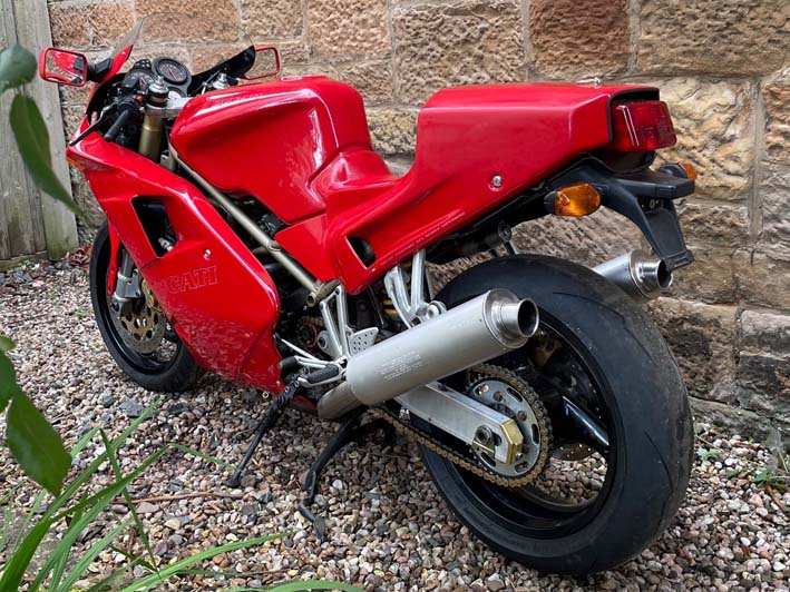

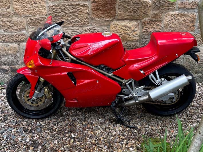

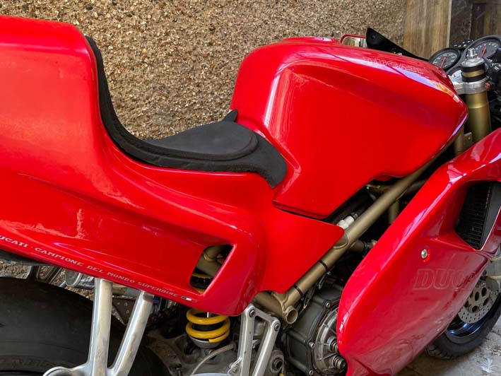

    The saddle needs some consideration, which will take a few goes, but I did a mock up captured in the picture below. I have been trimming away at the shape until I think I've found something that works well with the lines. I'll make up another version with a nicer finish.
    It has been a rewarding build and will continue to be over the next months as I tie up the loose ends.
    I would love to hear what you guys think about the 'finished' bike as I know trying to use the ST tank with the 851 / 888 body was always going to be a bit of an awkward pairing, but I was never going to know for sure until I did it and I'm really quite pleased.
    I have no idea what it will ride like, but that will be revealed at some point in the future!
    • Like Like x 8

    Sev, I love the scribbles. This is exactly what I do when I see someone else's build. Funnily enough these are just the things you miss when you are so close to the project. I will certainly take your thoughts on board.

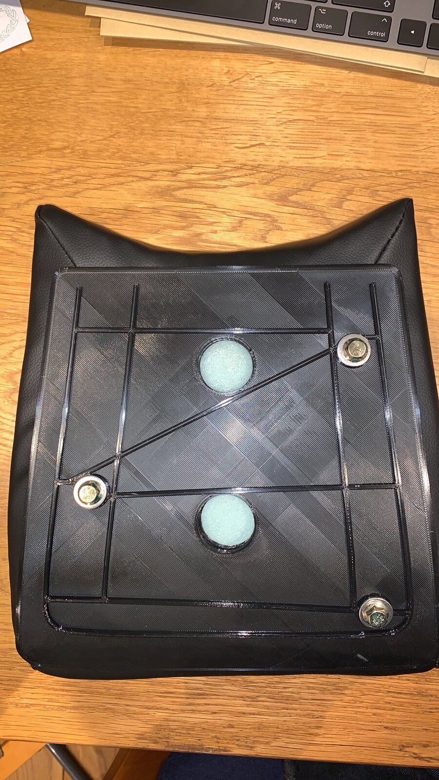

    The seat is an interesting one, because I would like to make a pan first and upholster it, but I don't quite know how you go about that, so I was just going to stick foam straight onto the tail unit. Any tips / links / ideas from anyone would be greatly appreciated!
  7. Thanks for the nudge @Sev

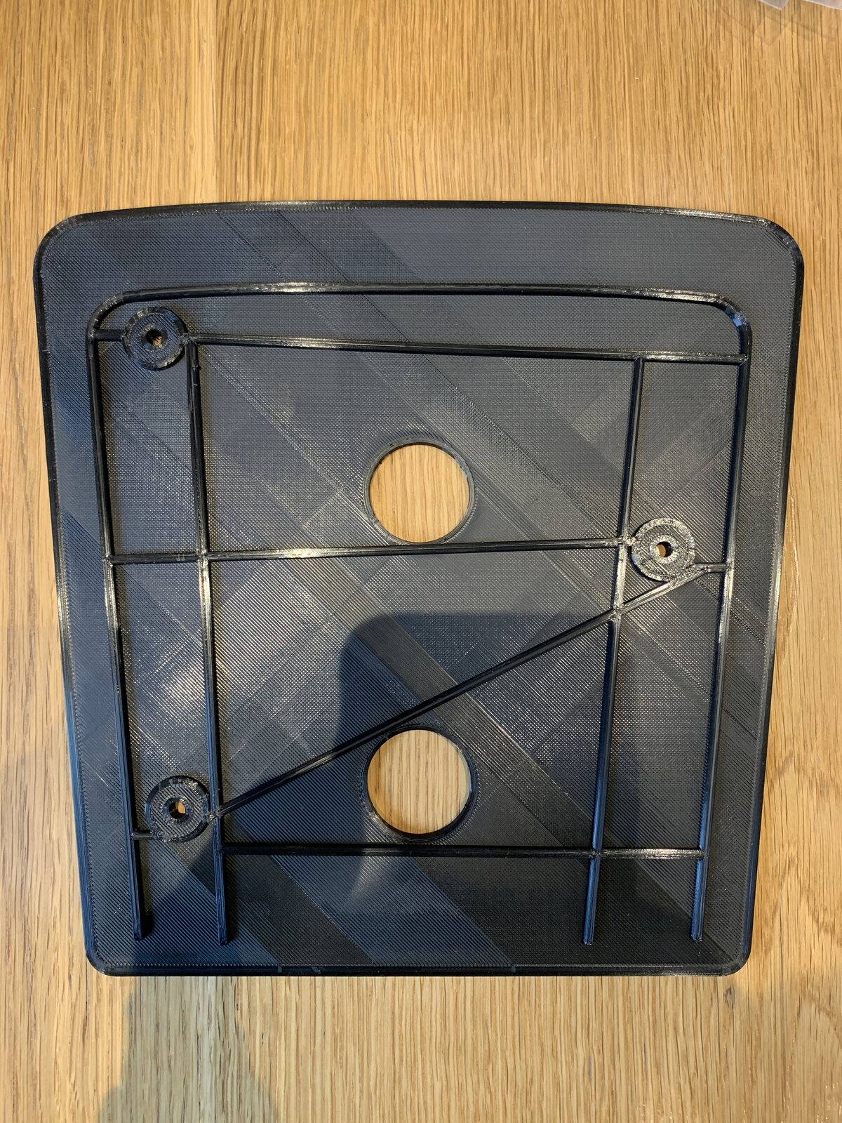

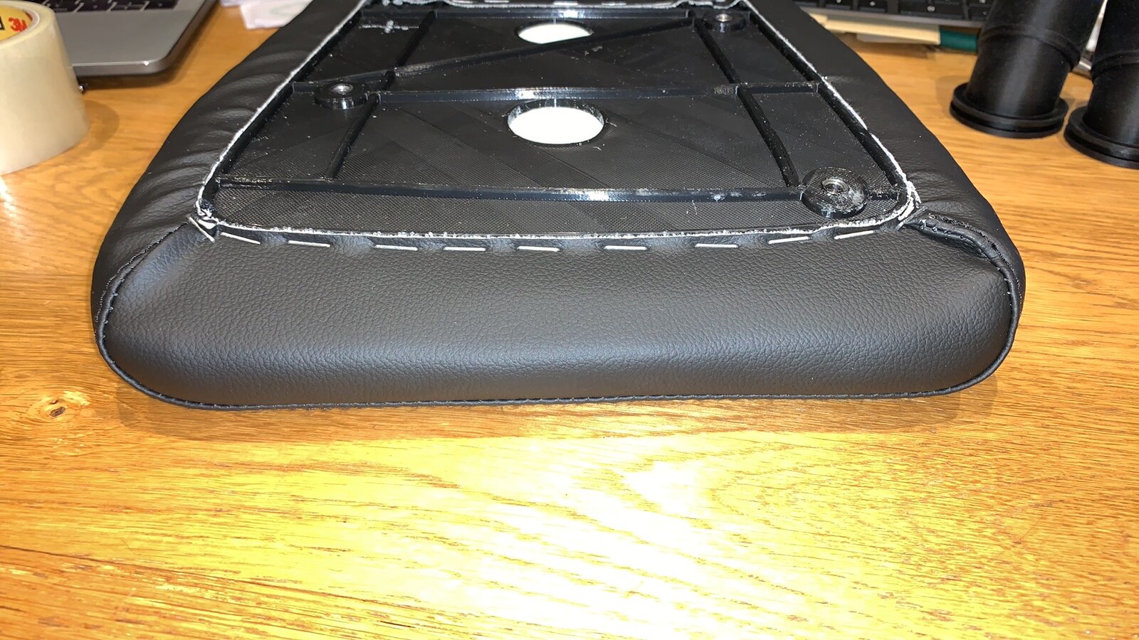

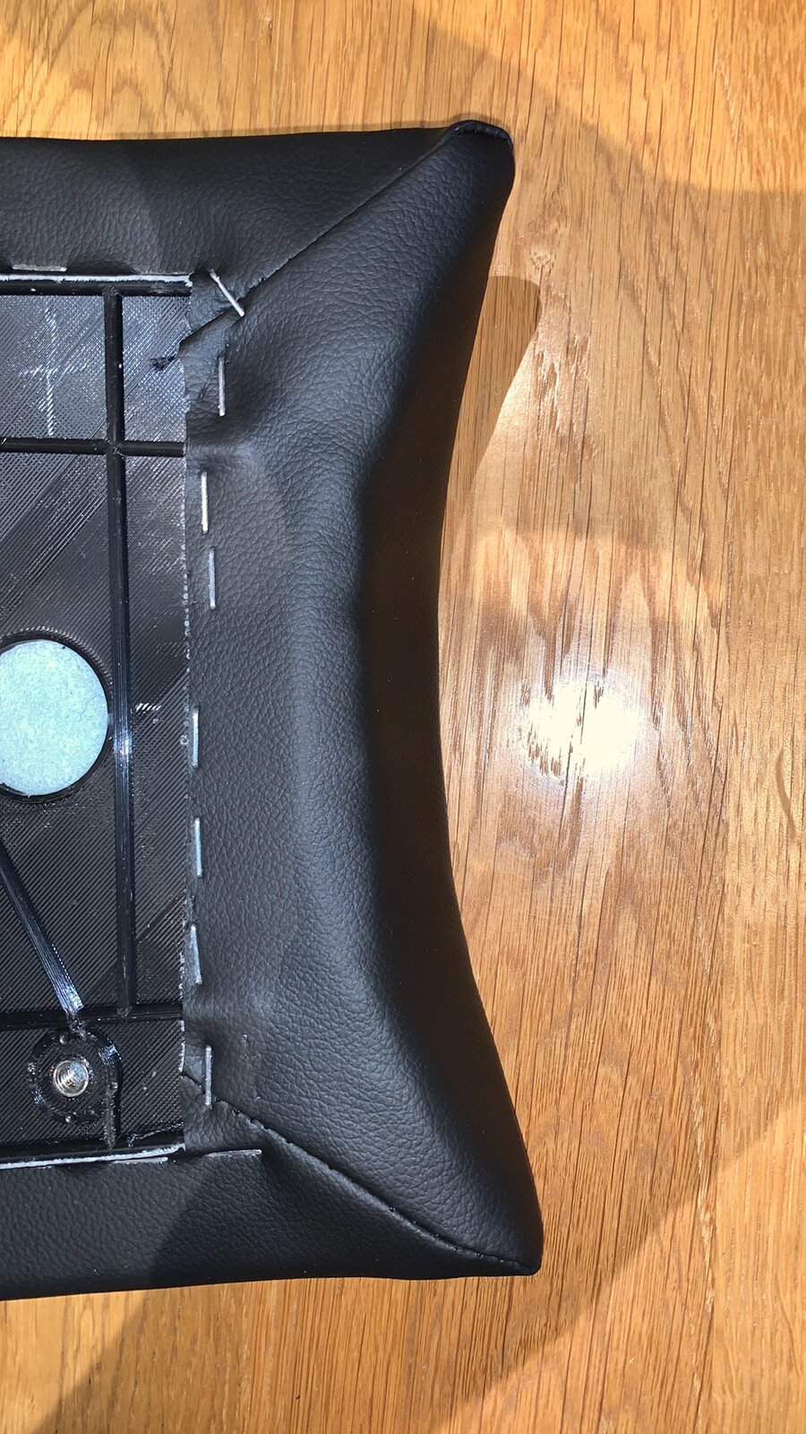

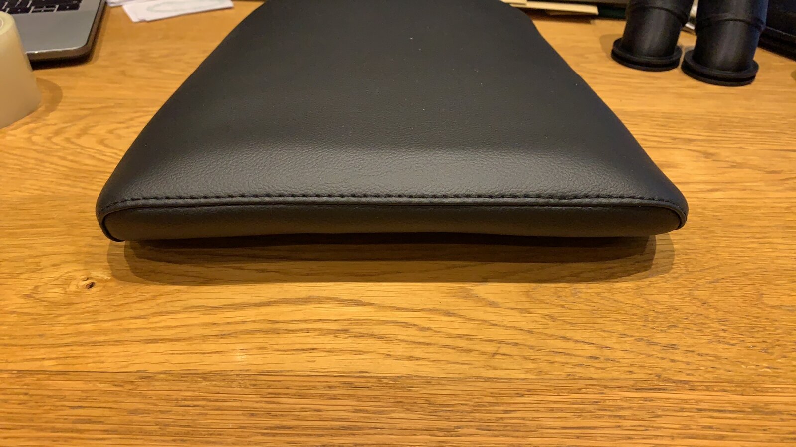

    @witchellski I have made some base plates for the 888, which you would need to pad and cover and then bolt to the existing seat base. Here is an example of the base pad and also one I had covered with the right sort of stitching to follow the shape of the tank. The base plate can be bent to the contour you like with the use of a heat gun. F79C3A35-B2A4-4F08-9E0A-F9D2E7D22509.jpeg 1890D164-21AD-4155-9B89-DD8C769BA47B.jpeg 32756380-DAF5-49CD-AAE1-EDB54B5432EA.jpeg F125631D-DC7F-4F4D-A1B1-18898790CDC8.jpeg 9EB00F4E-E3D4-4B64-991F-83DA18286C90.jpeg
  8. Excellent guys... thanks @Sev and @Bridgland Both good options, although I can see this taking me longer than the rest of the build! :joy:

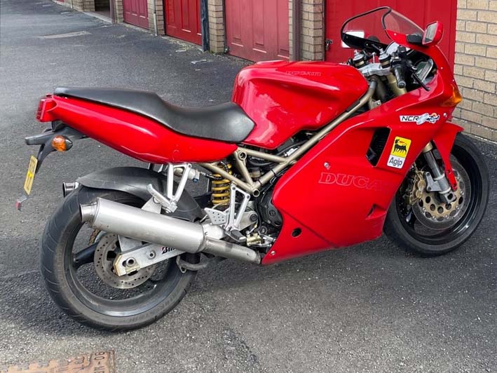

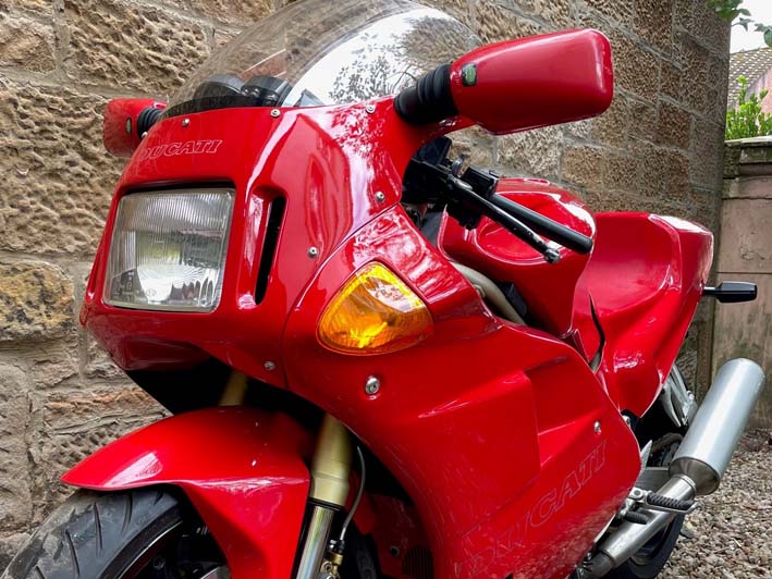

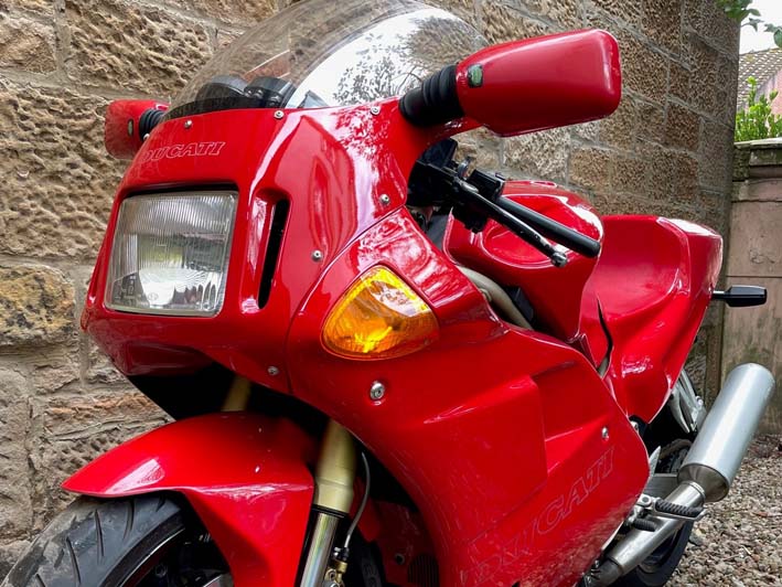

  11. I’ve managed a few miles on the bike since my last post and I have to say I’m loving the feel of the thing. Nice power delivery and an excellent soundtrack… I guess they all do that, but with an open airbox, clutch vents and 100mm clumsily chopped off the end of the cans it’s quite a unique 3 piece!
    I’ll be putting quite a few miles on it as the year pans out, as I have a European trip in mind. I’ll maybe put some feelers out with the forum on some good routes.

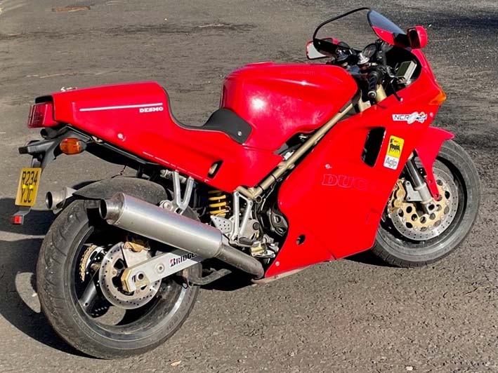

    As part of that plan, I have managed to accumulate a few necessities, including a set of ST2 panniers and of course the ST double seat. My daughter saw the double seat and asked if she could go for a run with me? Well, if her feet reach the footpegs and she holds on tight, I don’t see why not.
    Sooooo…. I put the double seat back on, along with the pillion pegs and I have to say I think it’s rather a handsome combination. Party at the front, business at the back!
    I would love to hear what others think. I still have to add the grabrail, because I changed the taillight the original configuration doesn’t work, but I MUCH prefer the 851 rear light.
    It’s potentially quite a versatile old thing now. Dead easy to swap around.
