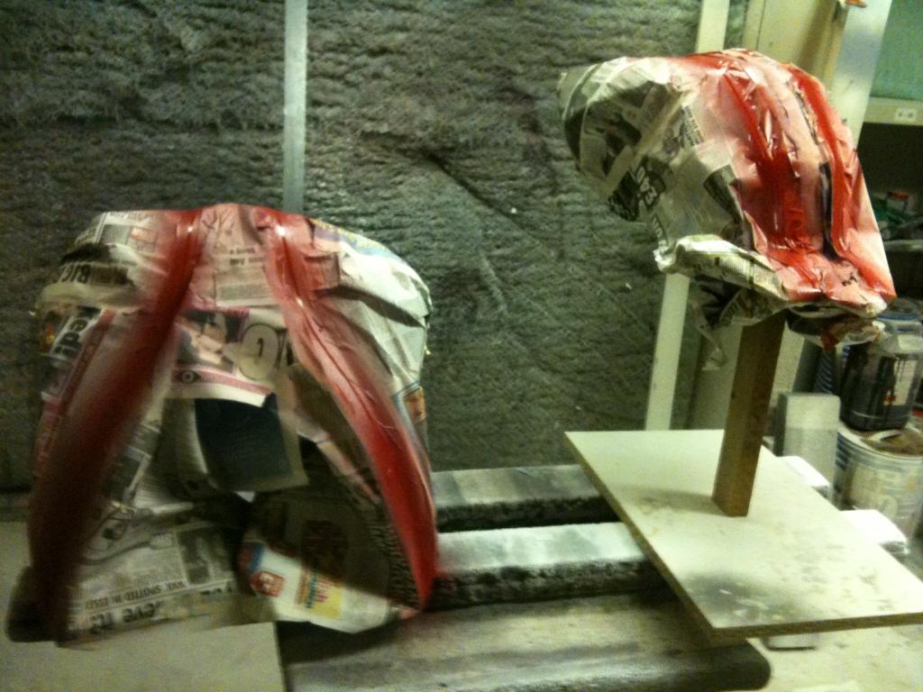

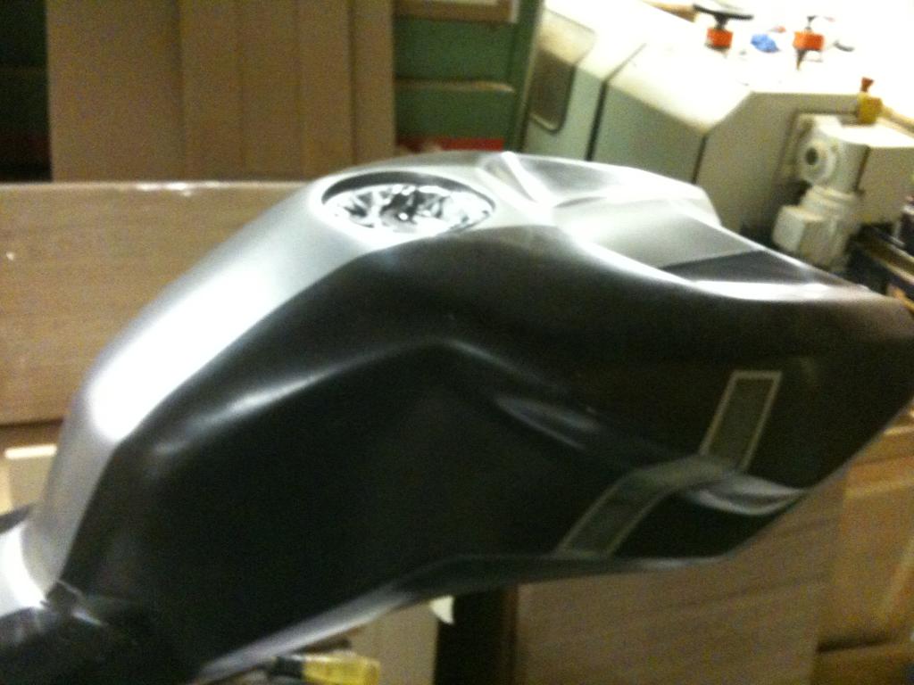

  8. Sorry about the shit pic but finished the silver sections so now on with the red sections.I'll take some better pics when I can.
  9. Well, I'm having a nightmare with the spraying at the moment. The front fairing came out great ready for clear top coating but the tank's not good. When I pulled the masking tape off after spraying the red stripes it pulled the silver edge off with it. After wet and drying the silver edge back and re painting, The masking tape pulled the red stipes off.

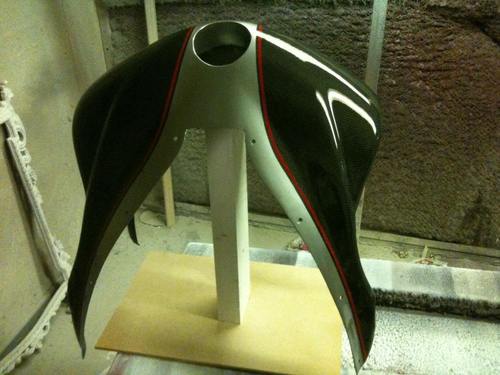

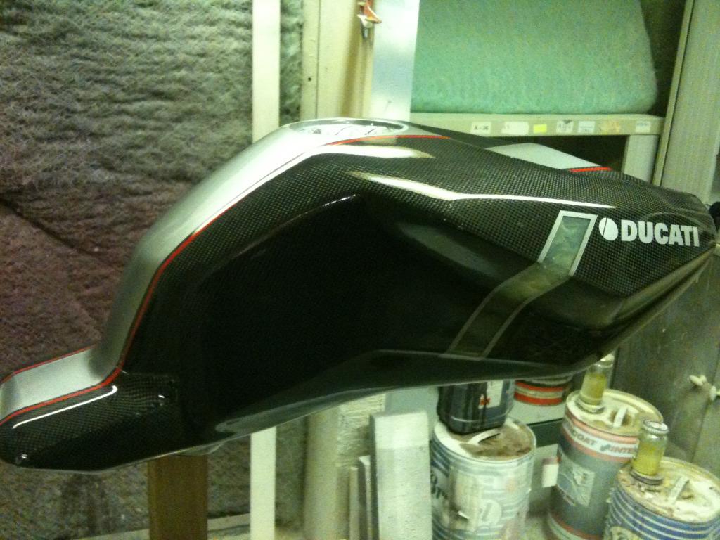

  19. I got there in the end. There's one or two little marks which I'm hoping will polish out but I'm happy how they turned out for my first attempt at spraying carbon fibre.
    • Like Like x 7
  20. well done, its a lovely job you've done there. :upyeah:
