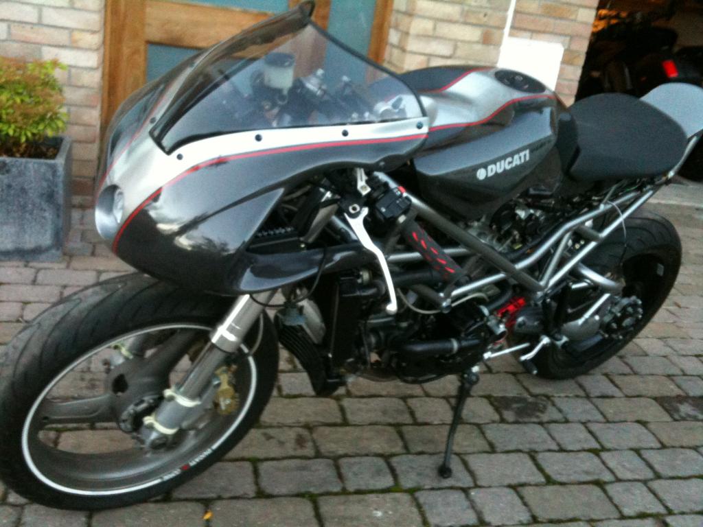

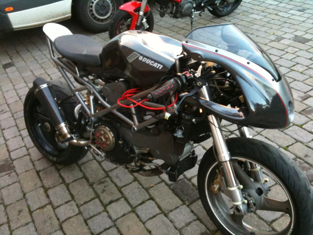

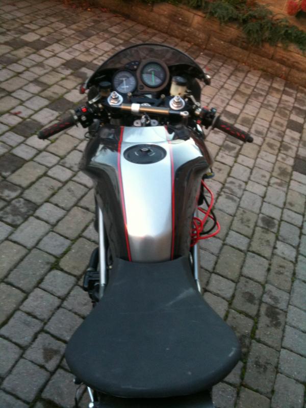

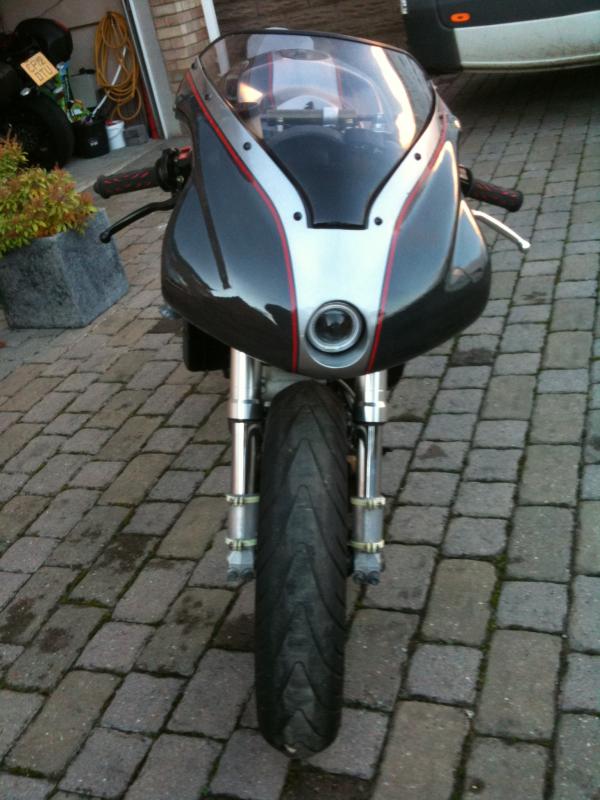

  3. It's getting there now. Just got to sort the seat unit and wheels out.

  4. That looks superb Phillipo:upyeah:
  5. Kin Ell thats awesome...mad max eat you're heart out!
  6. Nice, and wish my home spray job looked 10% of yours!

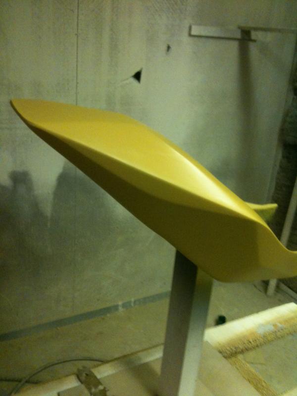

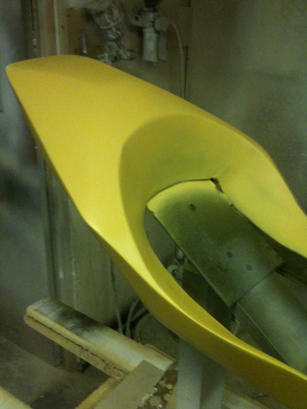

  7. Just a small up date. Preping takes for ever inbetween work of course.

  13. Metallic base coat on at last.

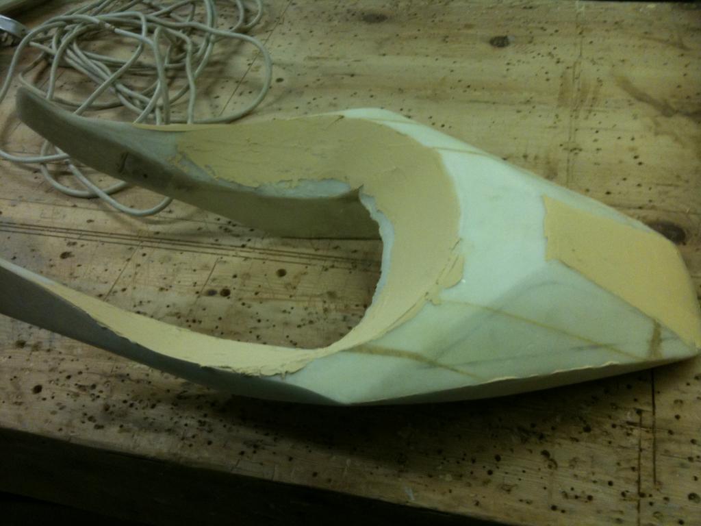

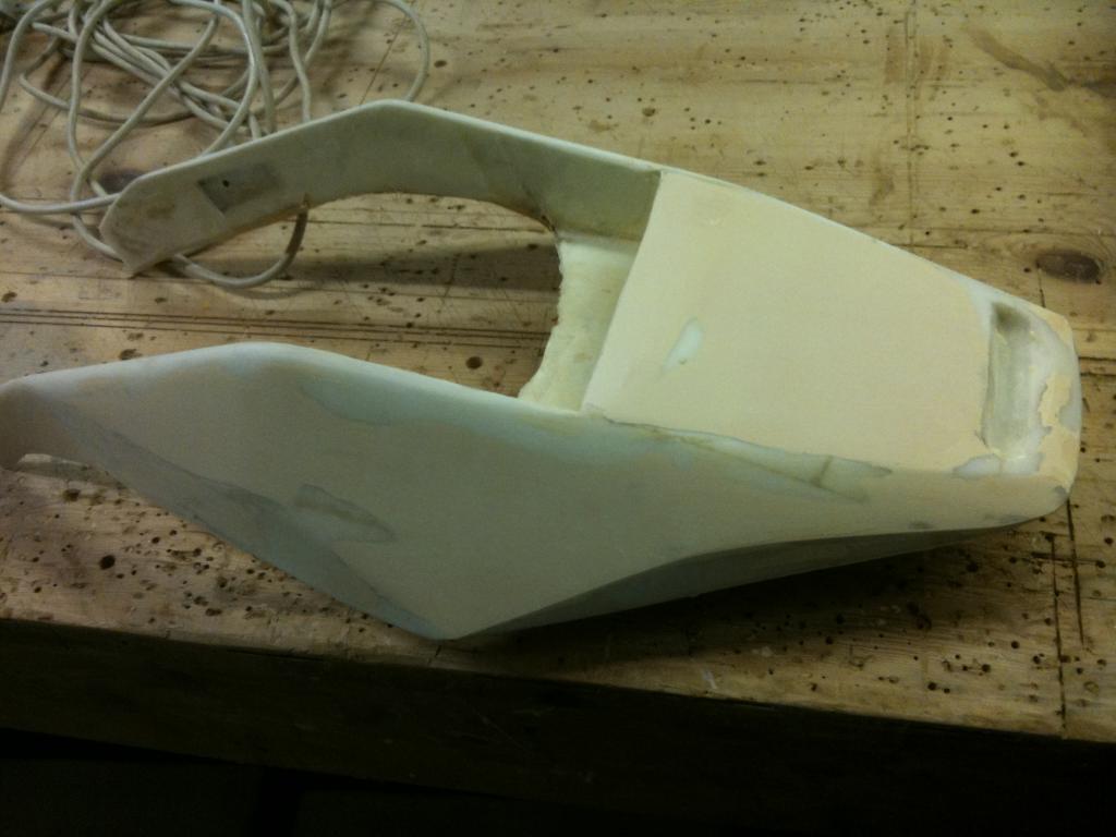

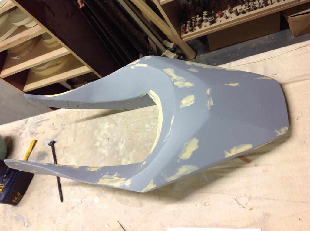

  14. Now I know why black is so expensive to spray. It shows every tiny imperfection. So I rubbed it back with 800 wet and dry and filler primed it again. This has got to be about the 10th time I've done this. I wish I'd of counted the hours that I've spent on this back end, I'm sure it would be around 200 hours.

  15. but it'll be worth it in the end

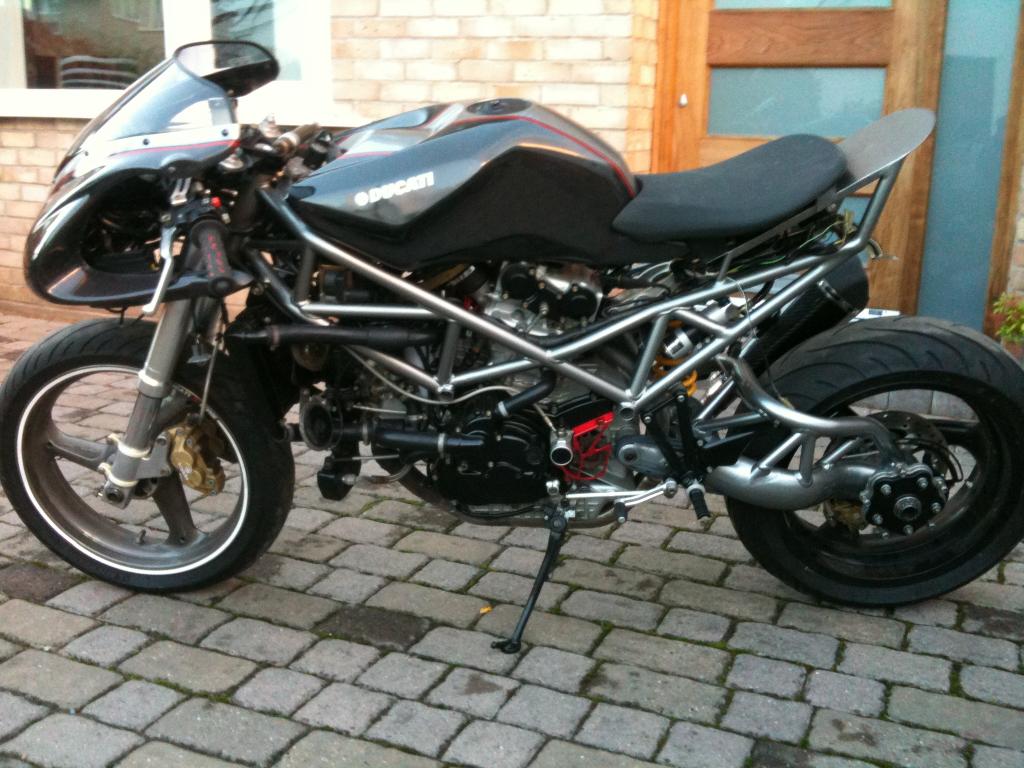

  16. Here's what I done to my S4 to fit a 999 swing-arm.
  17. good job Final Adition but I'm a bit to far along to start welding the frame again. I've been looking at the radical Ducati site and they don't do any strengthening to there project bikes. I think I'll send an e mail to them asking if they have had any issues with twisting. I'm going to go down the monster rear set route because it's easier for me if there is an issue. I can't see it being an issue because the ST was made to handle so much extra weight, panniers with two up riding. The fairing alone weighed a tonne!
    Thanks for your input though I appreciate it.
  18. Phillip, on your bike, where are the needle bearings, in the engine or swingarm?
    If in the SA, you will need some support on the ends, as the pivot bolt will hang/rub in the engine cases.
    You will need the S4R/S type rear-sets.
  19. The bearings are in the engine casing. It's exactly the same construction as the ST swing arm.
  20. You'll be fine as it is. No need for anything extra :upyeah:
