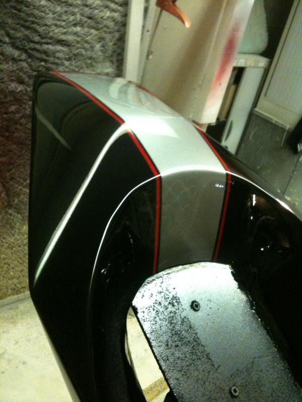

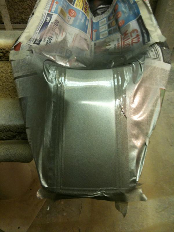

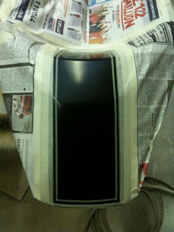

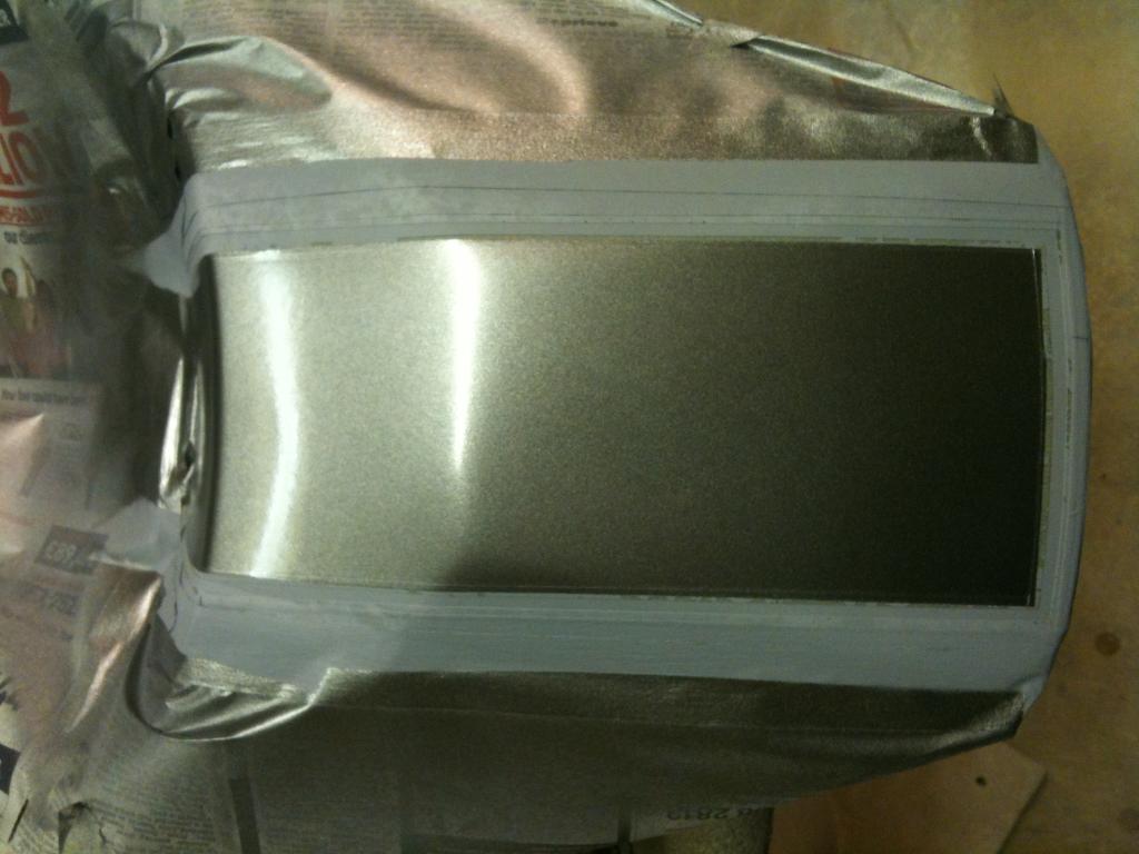

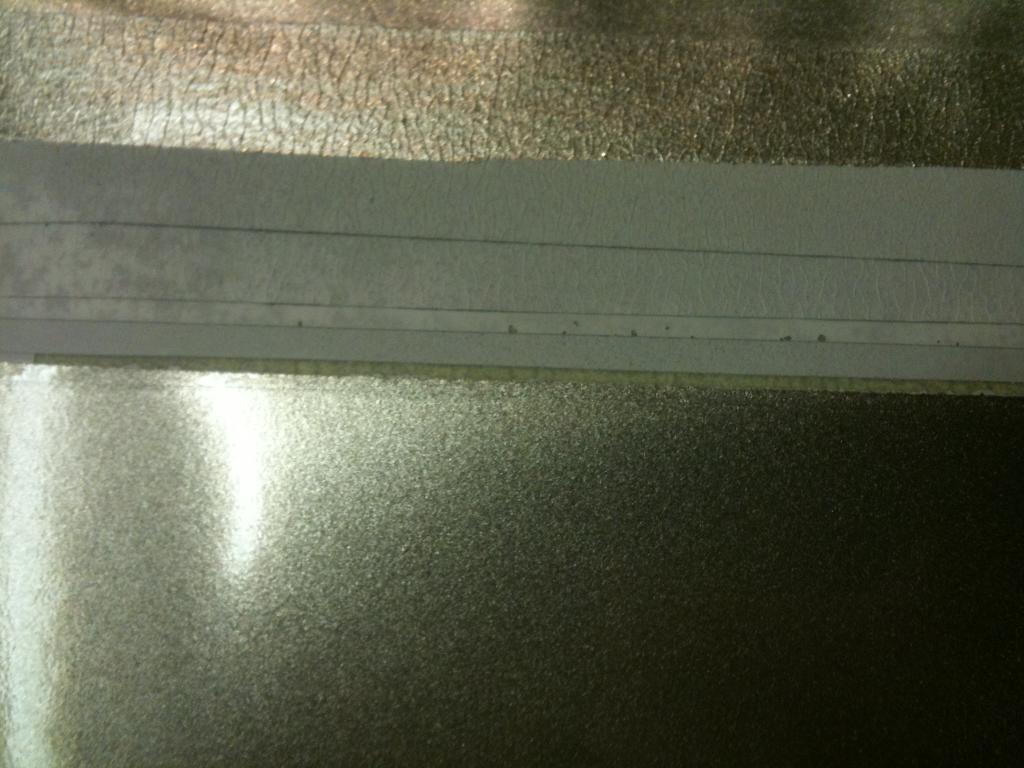

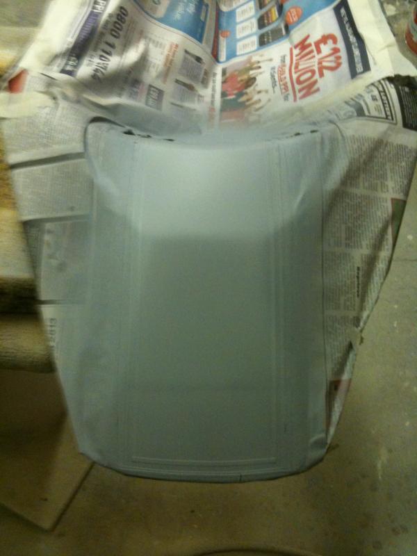

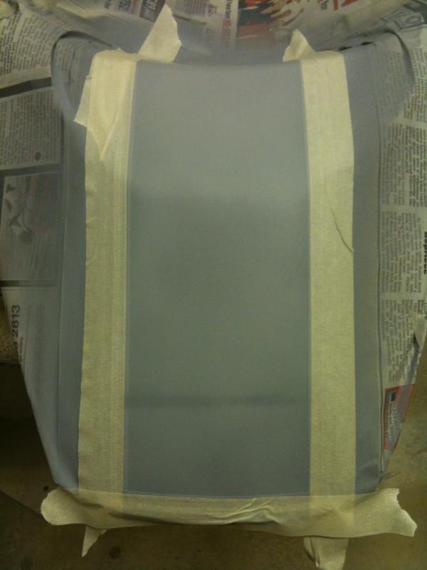

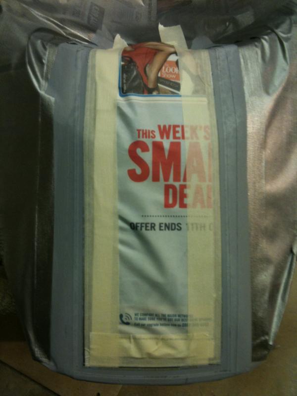

  1. Getting there now with the tail section. So far so good.
    First I masked off the centre section and the band around it.
    Then sprayed primer so the black doesn't show through. Very thin and fine coat.
    Then I masked off the outside band and sprayed the silver inner colour.
    Just waiting for it to dry now before masking off the silver so I can spray the red band.

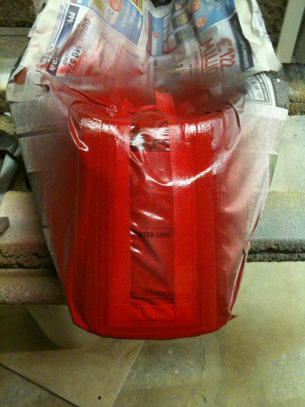

  3. Next step was to mask up the silver and spray the red. I left it for about ten minutes and then pulled all the masking off while it was still soft. Then after an hour I two pack laquered it and shuuuutinnnng....... Sorted.
    Am I glad thats done.

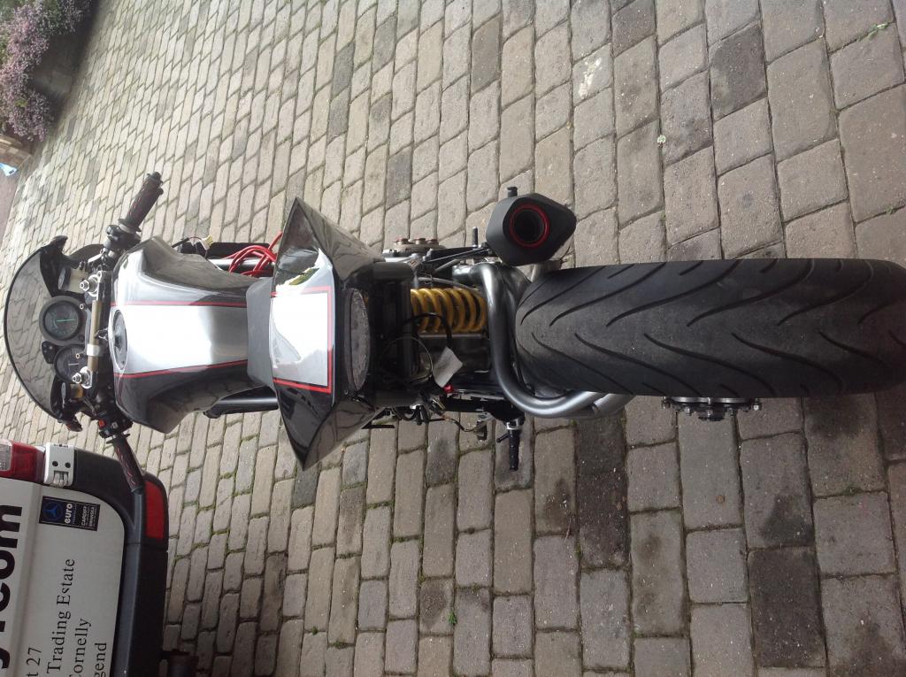

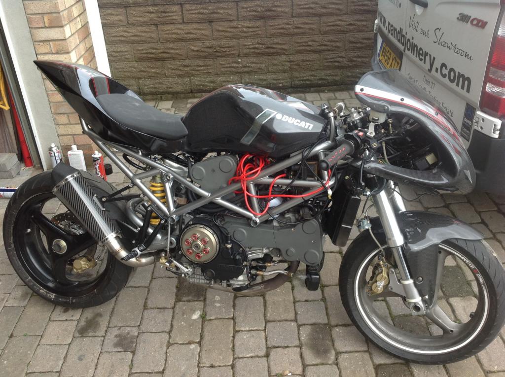

  11. Really getting there now. Just got to get new tires fitted to the s4 rims. Order a new chain and make a tail tidy for the number plate and indicators.

  12. Very nice indeed :)
  13. I'm impressed.

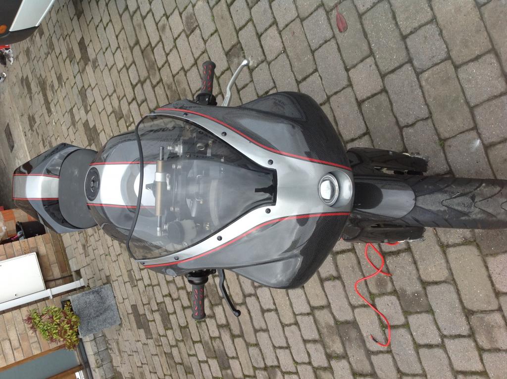

  14. Not a huge fan of the front fairing but other than that... WOW! :upyeah:
  15. I'm thinking of making a small belly pan but I'm not sure. What you guys think?
  16. If it was mine I wouldn't, it looks perfect as it is and all the belly pans I've seen just look like an afterthought?
  17. Paint scheme looks really ... grown up. I like it.
  18. At the moment it looks like it weighs 100kg wringing wet, adding a bellypan would just make it look fatter. I vote no, it looks great as it is.
  19. Yeah that's what I was afraid of tbh. I think I'll live with it for a bit and see what happens. Thanks guys.
