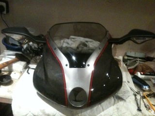

  20. Horrible do a rear view camera instead
