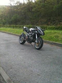

  2. Did 90 miles on the project today and loved every minute of it. A few tweeks here and there needed on the suspension.
    One small issue with the slipper clutch which doesn't seem right is it takes a long time for the revs to drop on down shifts. My EVR one on my fighter drops allot quicker and you get a clicking through the lever. But the ducati slipper seems to take ages for the revs to catch up. Any one know if this is normal or do I need to replace the spider spring or something?
  3. Did 230 miles on sunday and it was great. I've been playing around with the gearing and I think I'm close to perfect at the moment. I've gone from 42 tooth rear/ 15 front, Which was a bit crazy....... to 39 rear 14 front. I had a few sprockets kicking around the garage from my wifes monsters which work.
    I'm having a few issues with the handling though. It tips in great and steers quick but when I'm on the power coming out of a fast corner its going wide. I have lowered the rear as far as it will go for a bit of comfort. I'm wondering if this is making this happen. Any ideas?
  4. Yep, that's precisely what would make it run wide.
  5. dropping the rear will push weight backwards unloading the front. As you accelerate, weight transfers rearwards, decreasing front grip causing the bike to run wide.
  6. You previously mentioned fitting bar risers, did you do it? I think it would be the wise thing to do, then you could raise the rear back up a bit or drop the forks through the yokes to restore the steering angle, hopefully without the discomfort.
  7. No I haven't got round to fitting the risers as yet. Just can't justify the price on them tbh.
    I think I'll try lifting the back up again, bit by bit and see how much higher it has to go.
