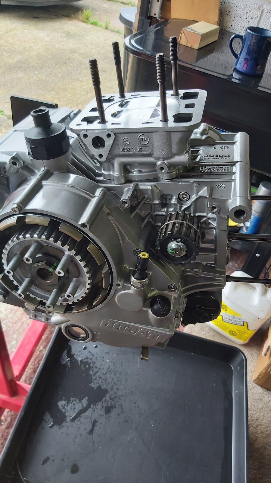

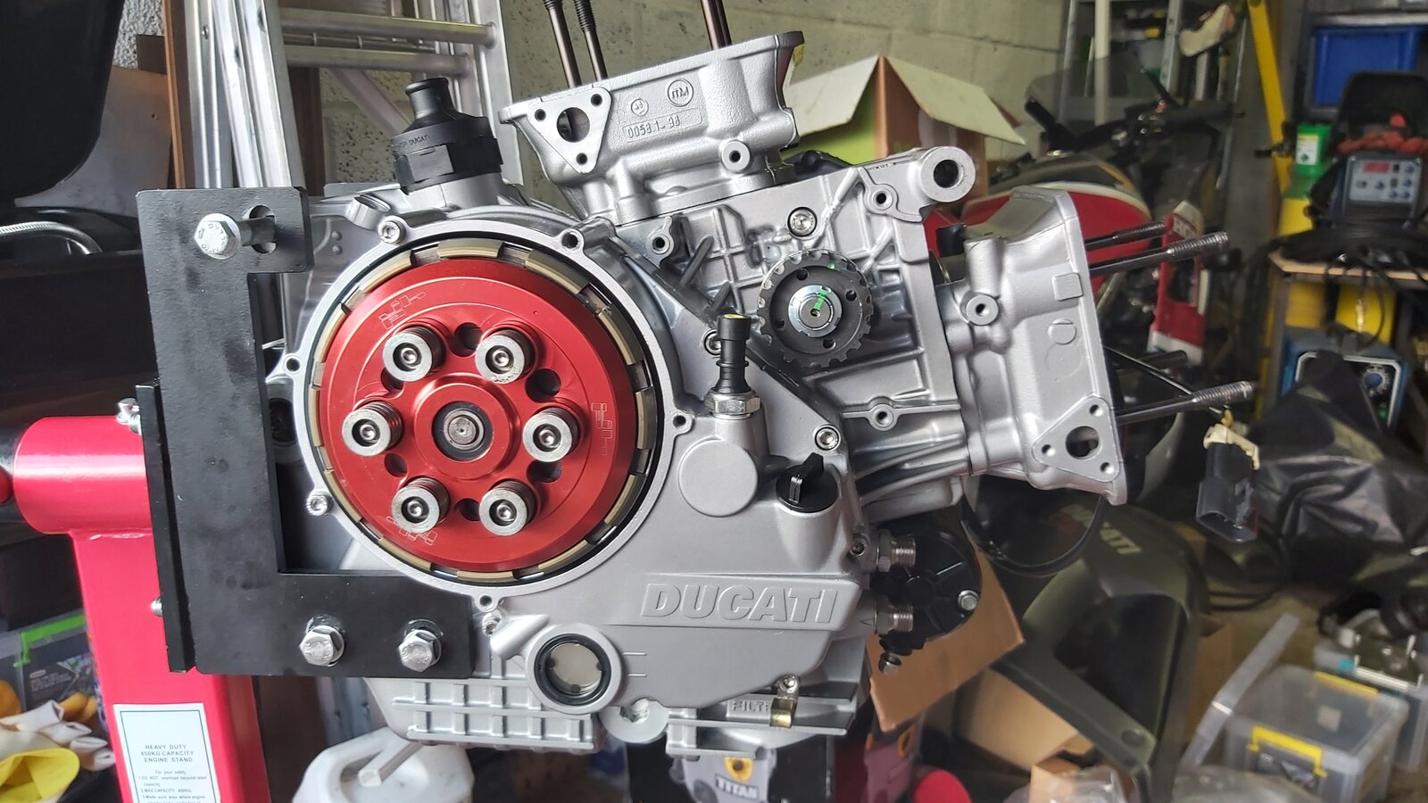

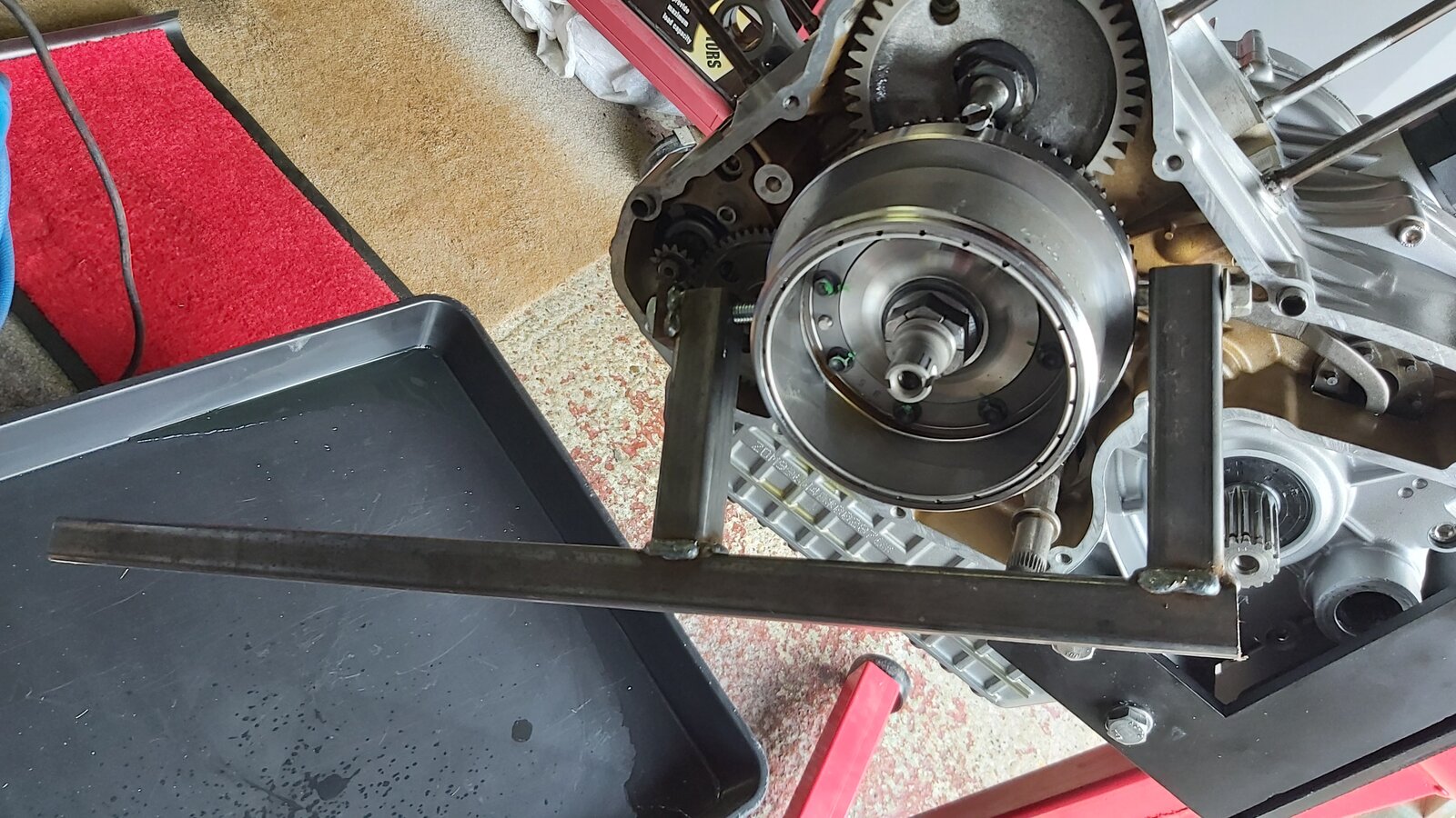

  1. Alternator has now been fitted and tightened, another day another tool made!
    With that done, I temporarily fitted the standard 0.6mm base gaskets, barrels and pistons to check the deck height/squish clearance. As standard, I had the horizontal piston 0.80mm below head gasket surface, and the vertical 1.03mm below head gasket deck.
    Am I correct in that the newer-type multi-layer head gaskets have a compressed thickness of 0.6mm? If so, to get to 1.00mm squish clearance, I can remove the horizontal base gasket completely, and run an 0.2mm base gasket on the vertical to get the pistons 0.4mm lower than the decks at TDC.
    Ring gaps checked in the bores, all within the "as new" spec from the service manual.
    Clutch plates and springs fitted, which is as far as I can go without a base gasket for the horiz' cylinder.
    Once I get a gasket I'll then be able to put the heads on, and the rest of the cover plates. Last bits to do will be cam timing and then wrestle the lump back in. We're getting there.

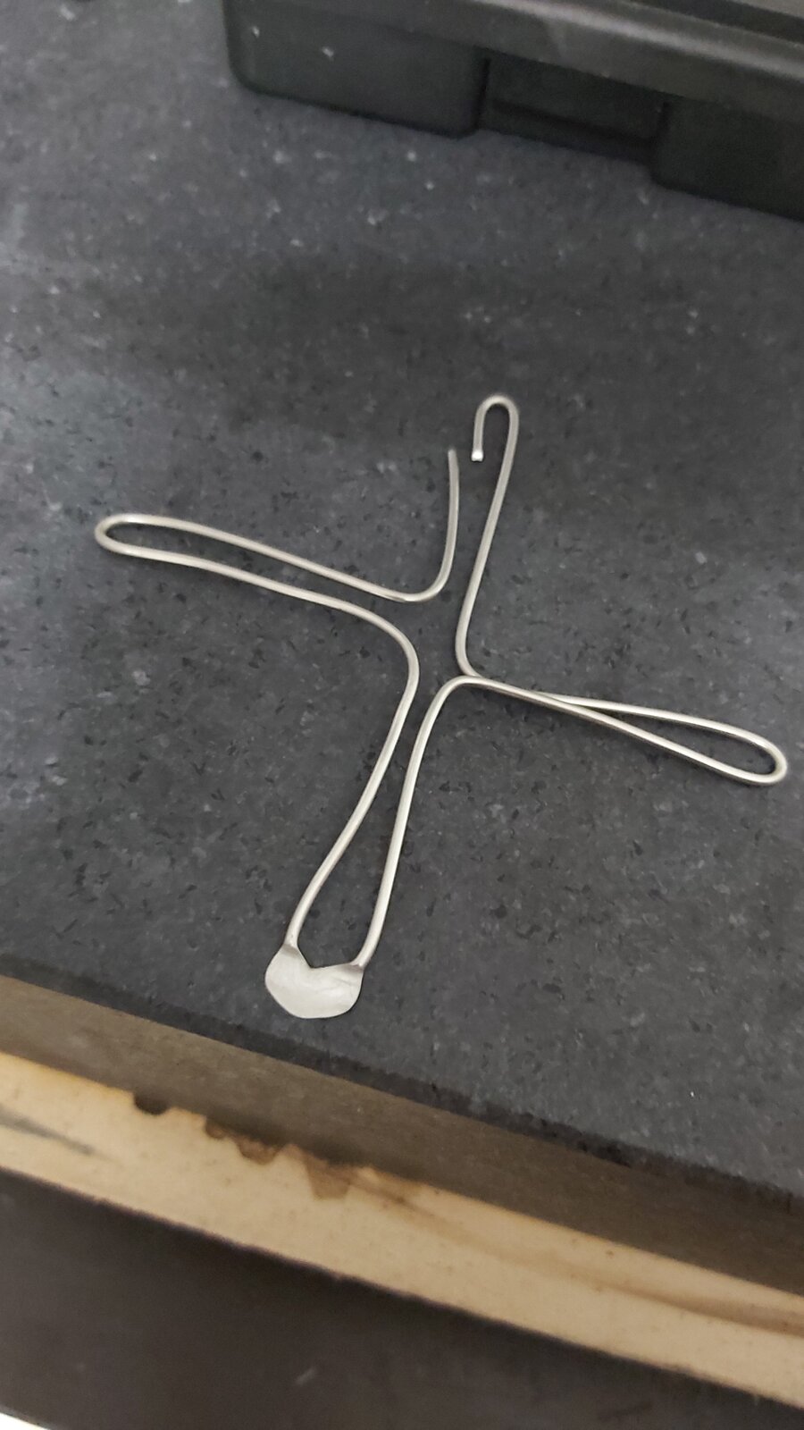

  3. Forget the deck height for now and..
    Torque it all down with your new multi layer head gaskets* with some soft solder on the piston crowns at 12,3,6 and 9 O'clock and measure the thickness of the squashed solder/squish clearance, then adjust the base gaskets/barrels to give you a clearance of 0.8mm.
    You might need to machine the base of the barrels.
    Anything 1mm or over and the squish isn't doing it's job, anything under 0.8mm and you run the risk of the pistons hitting the heads at high revs.
    * The gaskets are OK to refit as long as you have NOT run the motor/put them through a heat cycle..

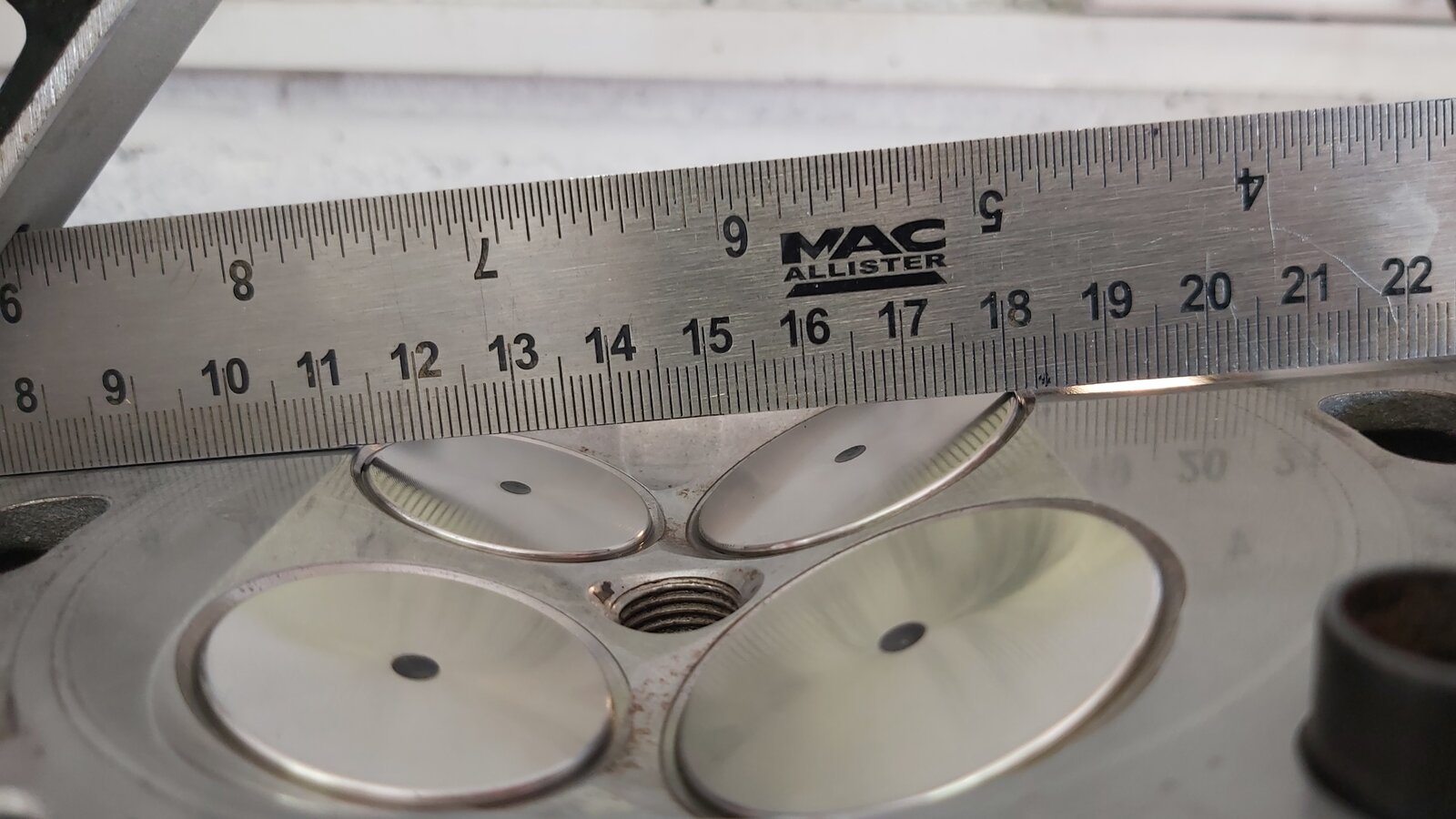

  10. Agree, Steve. My comment regarding removing material from the heads was more in reference to your post #11 on page 1 of this thread, talking about removing 0.6mm from the heads to increase compression.
    I wonder if these heads have already had some material removed, the inlet valves are proud of the gasket surface.
    Edit for added picture

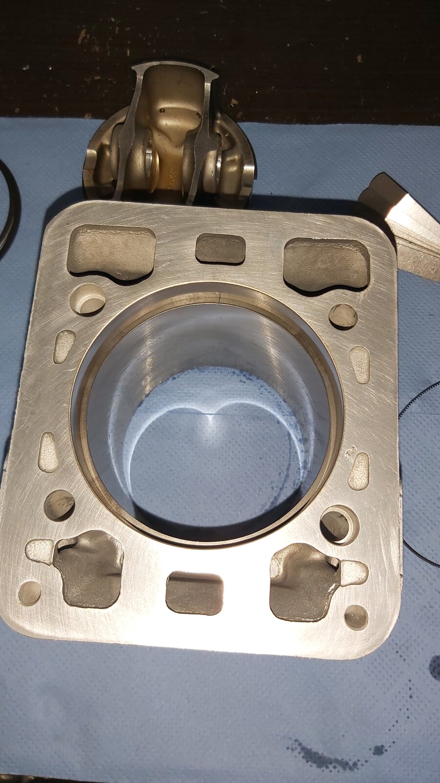

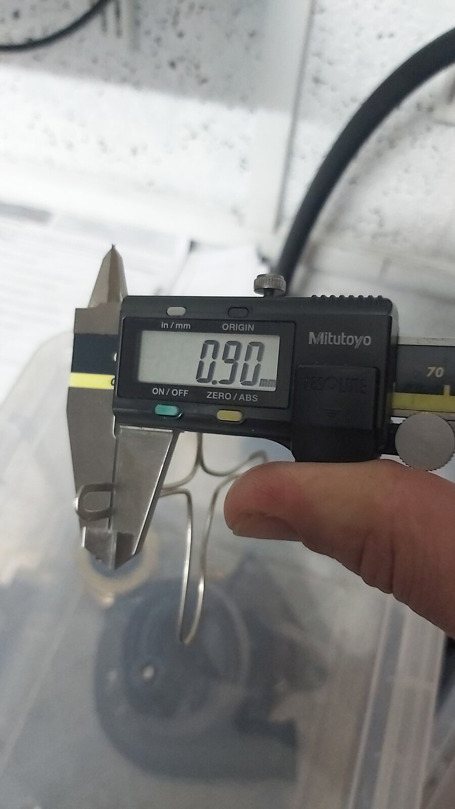

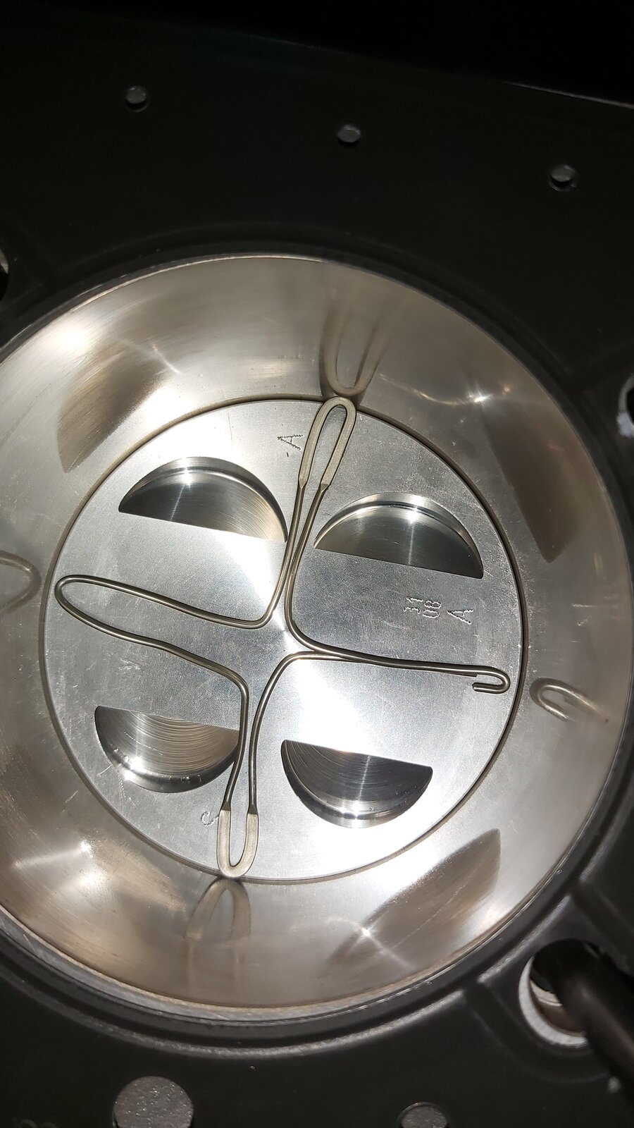

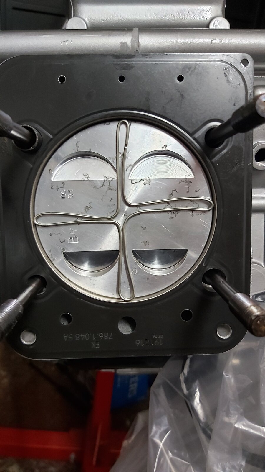

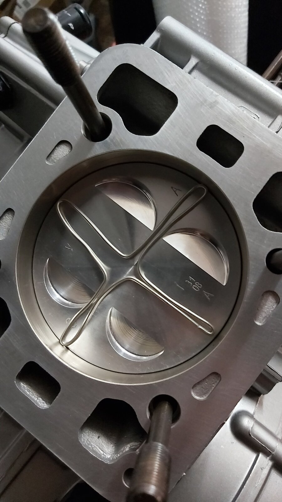

  11. Managed to get some time this evening to check squish clearance on the vertical cylinder. I assembled the cylinder with no base gasket, the new head gasket and torqued the bolts with grease per the spec.

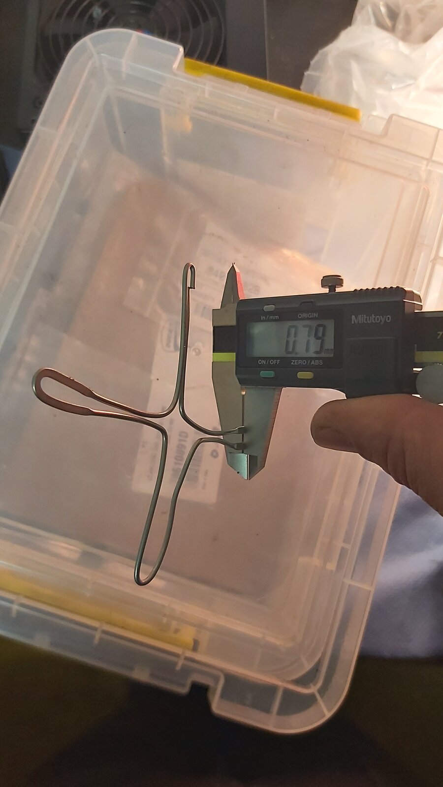

    I made a star shape of solder to make sure I could get it all out again without searching for smaller pieces.
    20201118_191723.jpg and after a revolution of the crank, this:- 20201118_194529.jpg

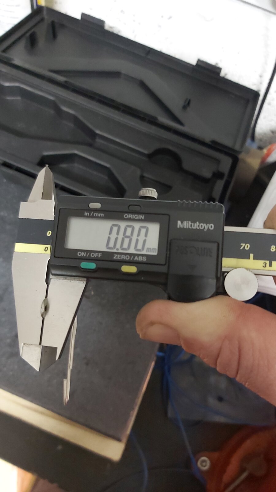

    I had calculated from the deck height measurements that I would need an 0.2mm base gasket to get to 1.00mm squish. The solder measurements with no base gasket were 0.79mm & 0.90mm (average 0.85), so the measurements match up quite closely.
    Will check the horizontal tomorrow, hopefully.

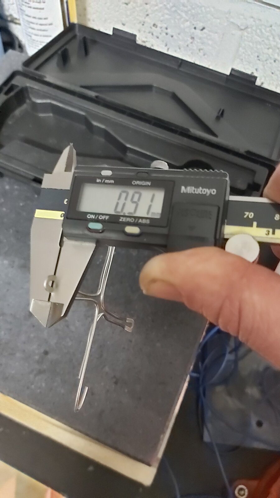

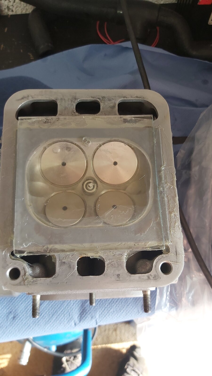

  12. Got round to the horizontal cylinder tonight. Started by making the same type of solder shape, and fitted the head.
    Felt a bit strange as it was being tightened up, so took it apart:-
    Whoops, the solder must have slipped. Ah well, no damage done, try again.
    Second time lucky, resulting in 0.80 and 0.90mm thickness, so again an average of 0.85mm. I think there was a small amount of paint causing a stand-off for the deck height measurements previously, which was cleaned off tonight.

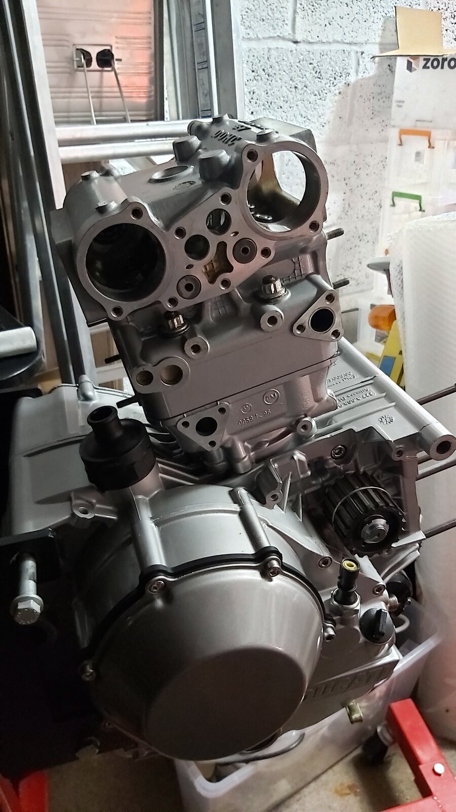

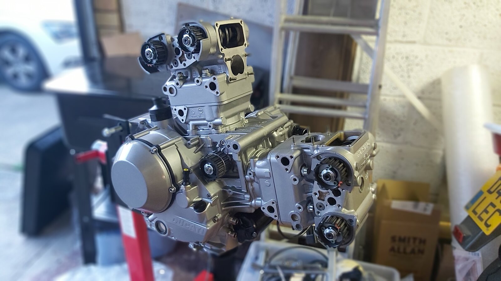

  13. Been making progress with the rebuild.
    Today I got the combustion chambers, piston crown valve cutouts measured for volume, and the compression ratio calculated.
    I think the heads may have been shaved before, as the compression ratio calculates as 11.9:1. It probably also explains why the inlet valve seats are so close to the head gasket surface.
    With that measured, got everything cleaned, rings put back on pistons, pistons in barrels, and heads back on!
    Waiting for opening rockers to come back before I can do opening clearances, and cam timing! Getting closer.

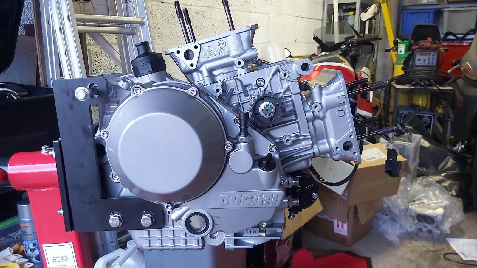

  15. I noticed that you had the same colour paint on both sides which looks good. Is it me or as standard, is the clutch side a differnet colour more of a mid grey not a silver. I think yours looks good but I dont really want to get my RH case cover off to match it.
  16. As far as I could see on this ST4S-02 all the cases were the same colour. Looking at the parts manuals online at Stein-Dinse.biz, it looks like the RH crankcase cover & clutch basket cover were anthracite on bikes earlier than 2002, then they changed to all the same colour (silver).
