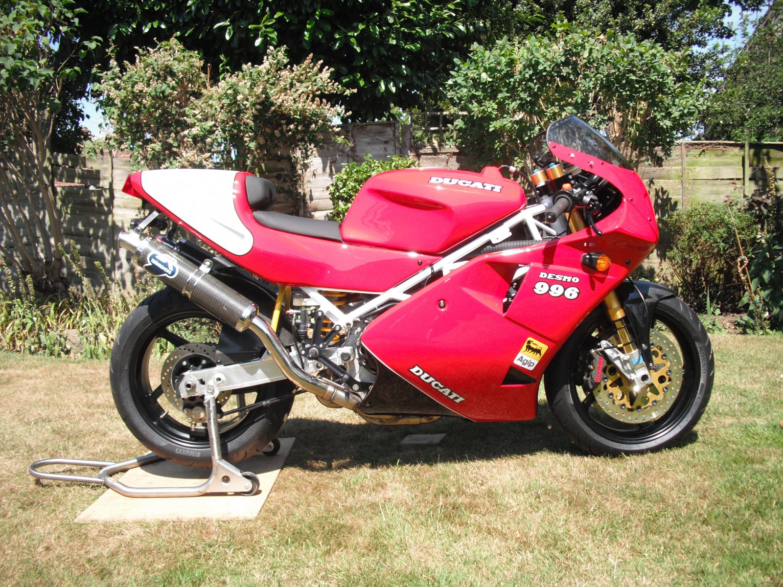

  18. Hi Rushjob, guess where that engine is now...
  19. An excellent place for it. Glad to see the plan came to fruition.
