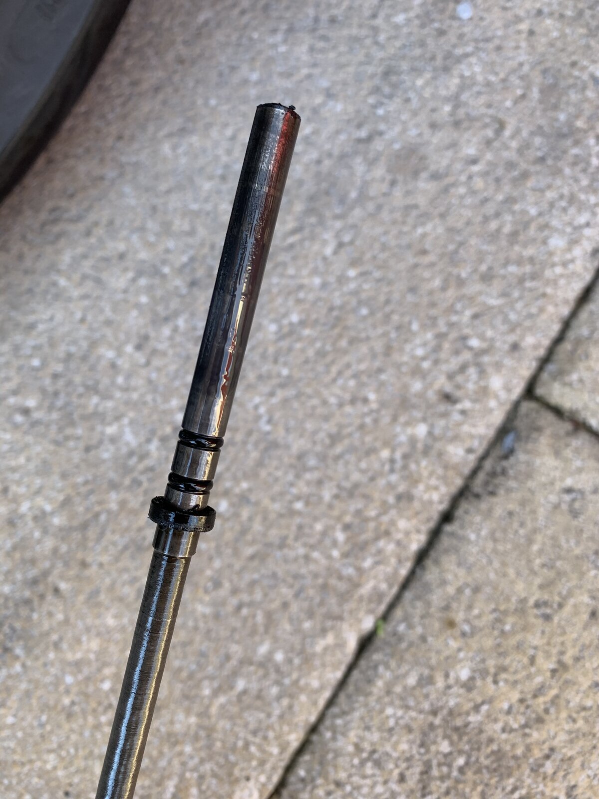

  11. Just took the plate and rod out, I’m guessing the big seal is supposed to be inside the slave cylinder? 620F7EBE-04CC-4D22-A6F6-5487B1E5AC93.jpeg
  12. That seal sits in a recess in the slave cylinder body (item 27) but is not difficult to get out and can stick to the engine casing.
    It must have done that and then came off when you pulled out the rod?
  13. Does look like as above, The main thing is that it looks like bearings and pushrod are okay so another one to cross off the list. You could check play of clutch gear (17 above) while you are there.

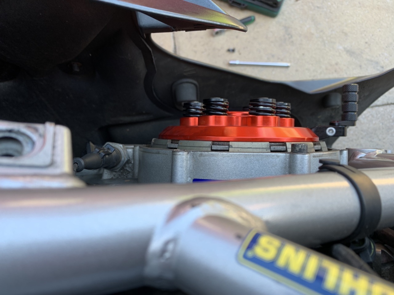

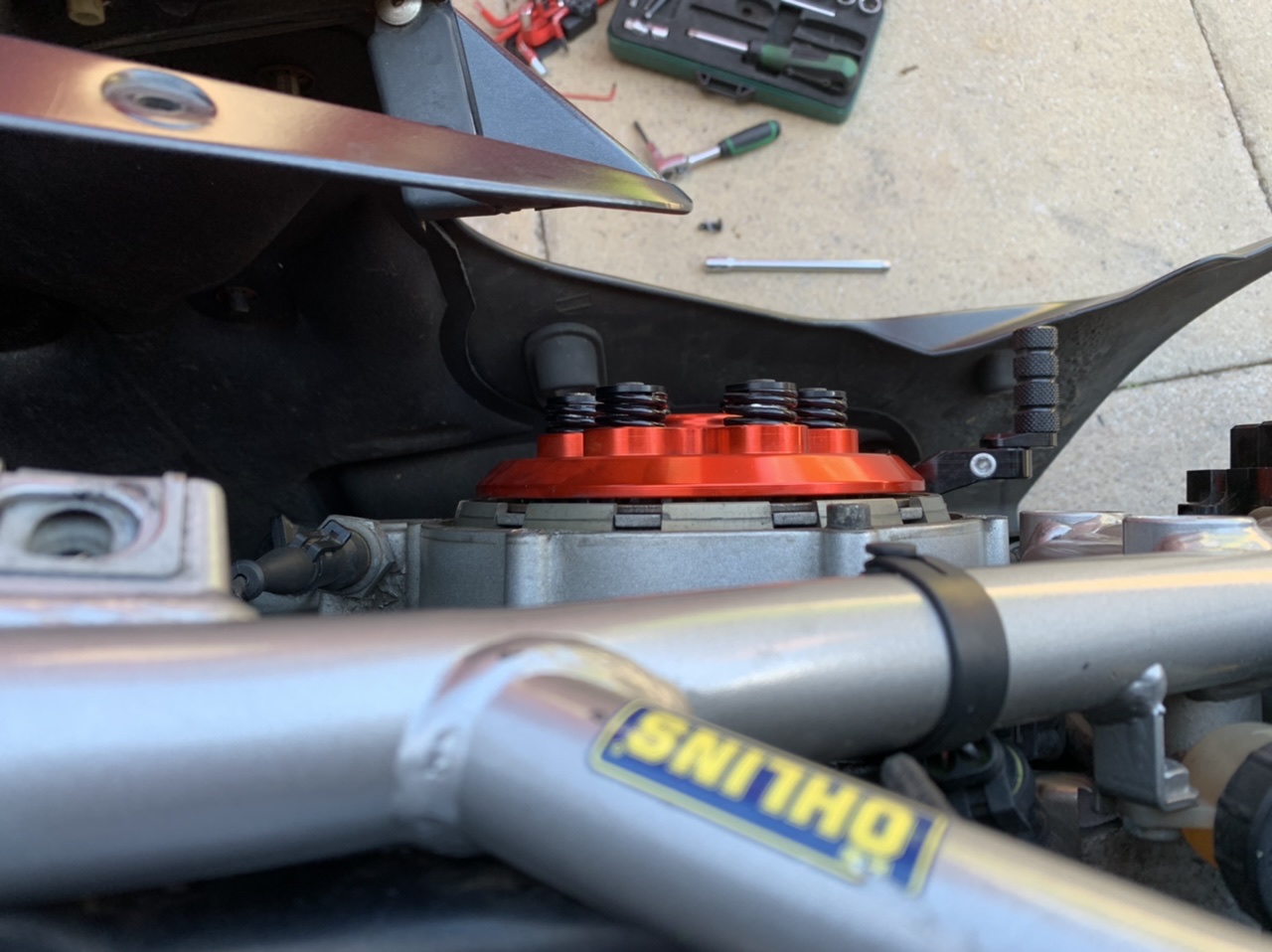

    I took a couple of pictures of the effect the lever span has on the travel of the clutch.
    Top is with the lever all the way out, bottom is close to the bars. 62C17AA9-2B9F-400E-89B7-634379F3C38A.jpeg A8F7FF1E-F26B-48F3-8877-39BE560E40D1.jpeg
  16. yes, you can, I haven't managed to find any YouTube videos yet to help access play, I know there are several but this was around 10 years ago - it's unusual but worth checking. The main one that fitted symptoms was pushrod fail/partial seizing so can at least move on from that. :upyeah:
  17. not sure what you mean re: - hole too small.
    regarding pictures and your notes:- do you mean the other way round?
    You only need around 2 mm of pressure plate movement for clutch to work correctly, looks about ok, and operation while starting, selecting gear and moving off will confirm.

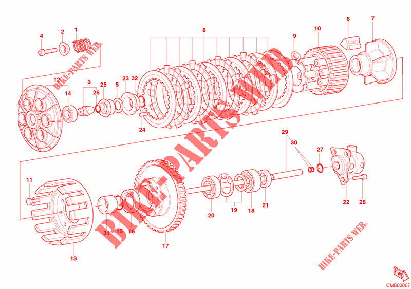

  18. The seal is from inside the clutch end of the gearbox shaft. The push rod must have been pulled out from the clutch side and pulled the seal out with it. It is item #30 in this pic from the parts list. Screenshot 2021-06-09 at 10.45.48.png
  19. Ok thankyou, will take a look again later and reseat it.
