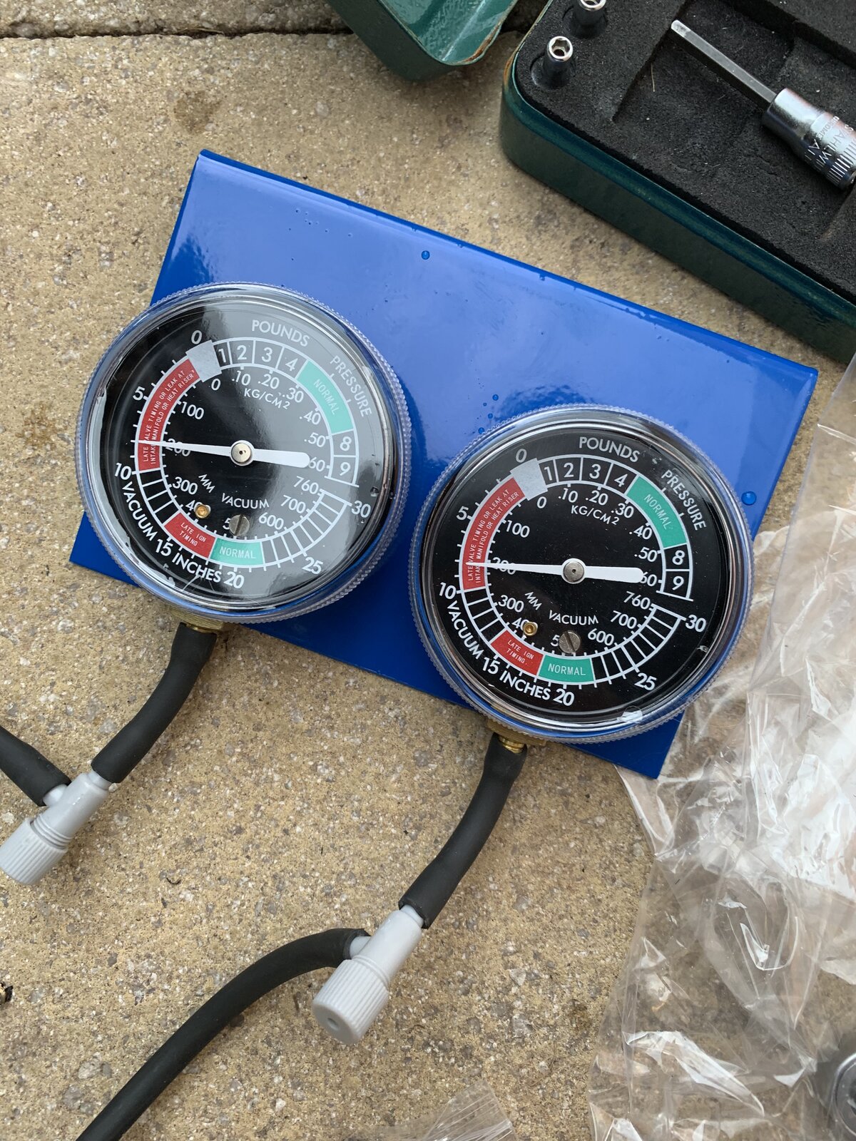

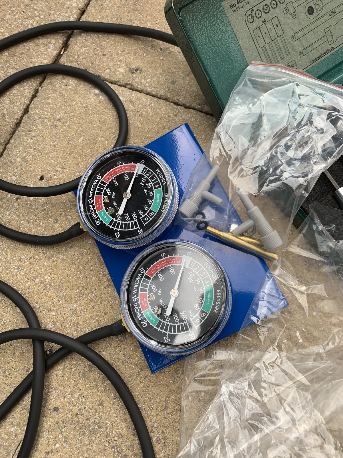

  3. Needles are just going crazy, leak in the vacuum system?
  4. What gauges are they? Most need to have dampers in the pipes?
  6. Fitted the little plastic dampers, needles steady but low pressure when set evenly. C507BC1D-F0E1-4144-B52A-B3105207D07B.jpeg then with the horizontal bleed all the way closed 92D5DC01-E2B5-468A-A07D-8B552ACB22BC.jpeg

    those gauges might be ok! But you do need to seal the pipes at every connector point. (Best eg I can give is) how would you feel if your fuel lines were not clamped???
  12. My mate also added that the TPS auto reset only works if the base setting is correct! Ducati service has TPS reset eventually for all models
  13. Don't get too carried away with where the gauge needles sit. All you need are steady needles.
