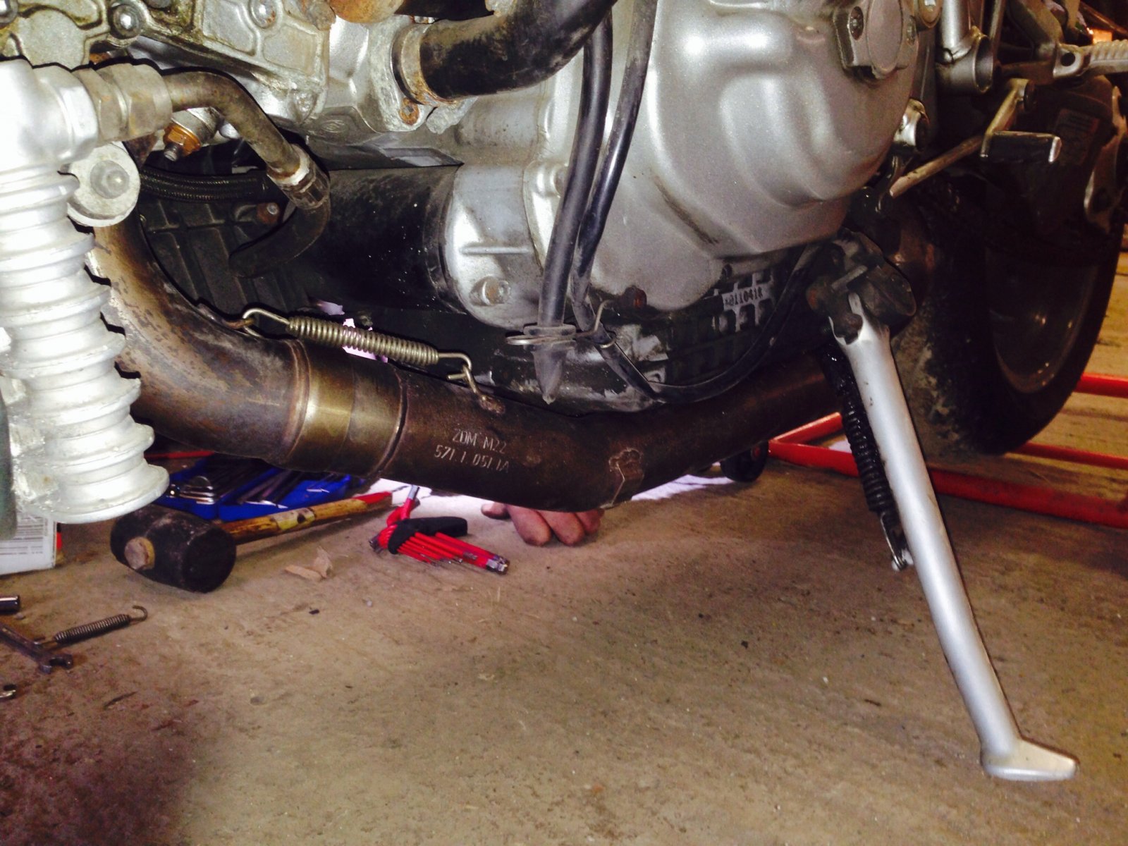

  8. 998 get a full 50mm and chip it really opens the engine up you will notice the difference and they just fit I did it to my ex

  11. The 998 has a different ECU setup and does not use a chip, you would need to get the ECU map put on by someone who has the facilities ideally, although you can do it yourself.
    Termignoni's for this model at 45MM come, when new, with their own ECU which seems to be taken from a 996R as that is what is marked on the ECU.
    Don't forget the 998 is not a deep sump model so you would need the correct downpipes for a full 50mm system or use a 45/50 link pipe for a half system conversion.

  13. this is a full 50 mm fitted to my ex matrix was tight but she does fit but just ipad 079.JPG
