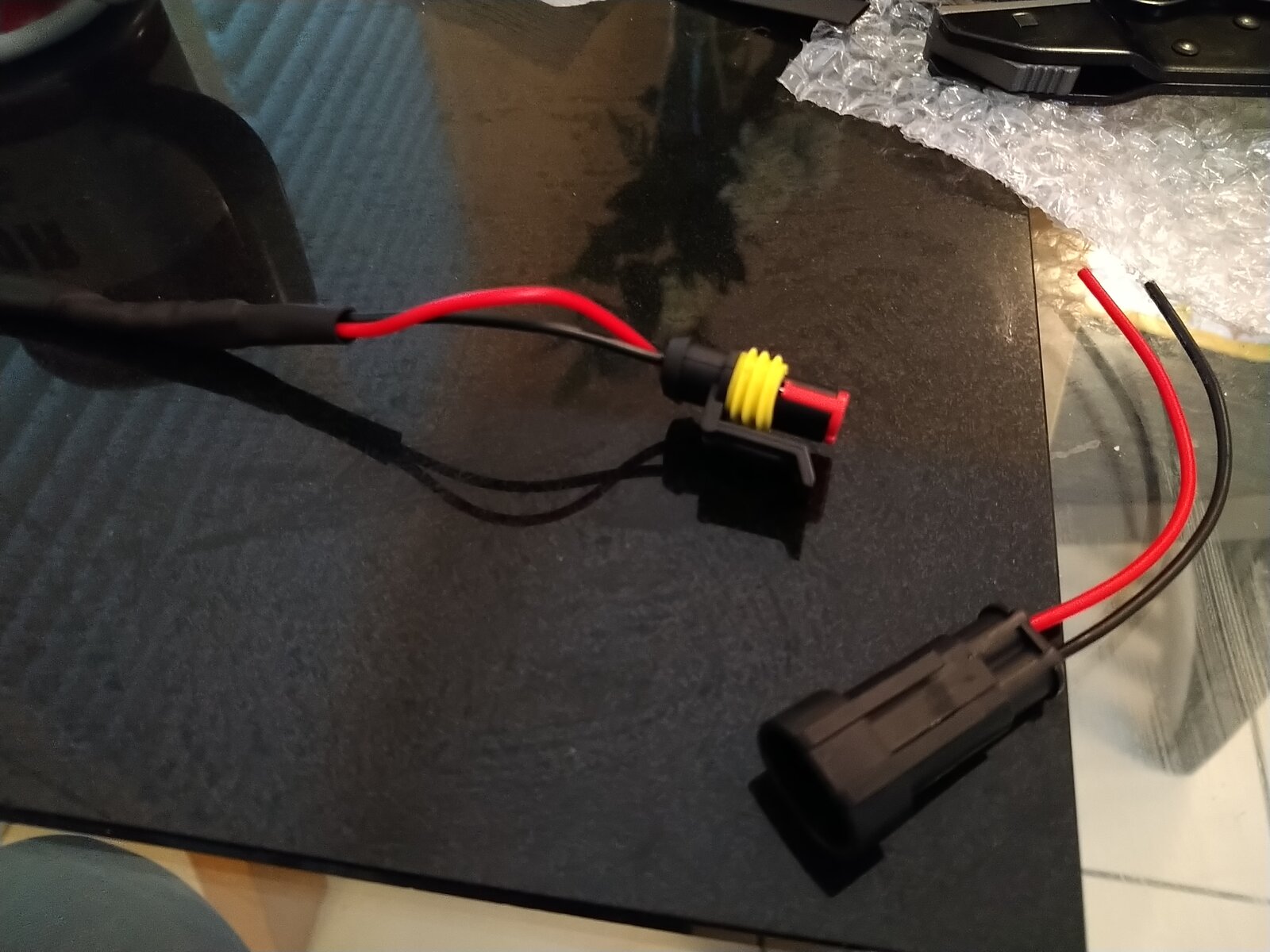

    I did the above on mine took about an hour and it’s like a new un now. I also closed up the female connectors slightly so that they grip.
  5. ok i'll bite Sev :) apart from kojaycat, do you have links to any other suppliers? could be useful to know in the future - I spent a good half hour searching last week without any luck but first to admit i'm a little rusty.

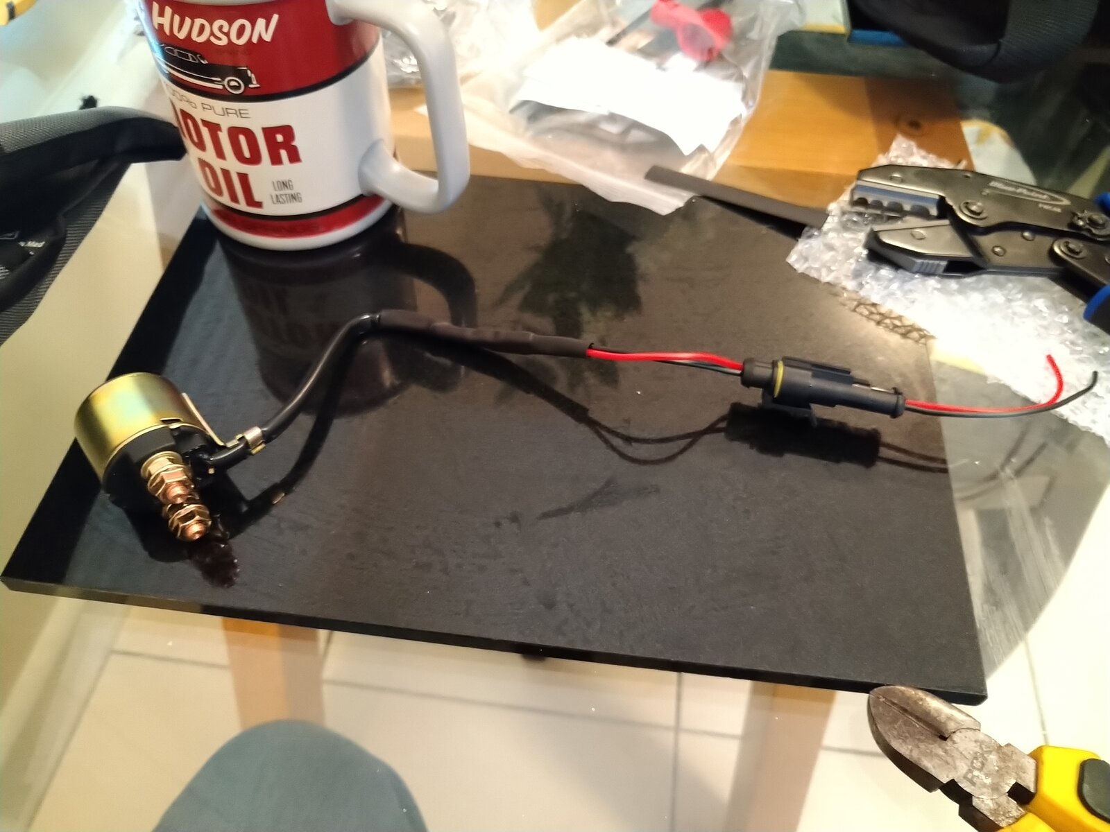

  9. This is what I am doing,
    Stater solenoid with a lead, and wired in a tyco super seal connector
  10. I did the same. No more problems.

  12. With the break in the weather I got the starter solenoid swapped out
    Out of curiosity, what exactly does the diode do? I read it only allows the current go one way to prevent and electrical damage; its a carb bike , no ecu ; would it short the starter switch?
  13. When the starter button is released the magnetic field created in the solenoid's coil collapses. The induces an electric current to flow as a spike in the opposite direction, known as a back-EMF. This can damage electronic components, not that there are much on a 900 Monster. The diode provides a path to earth for the back-EMF so that it doesn't damage any other circuits.
