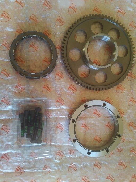

  8. New parts arrived.
    I bought a starter flange kit from Ducati...
    You will see its a metal caged clutch..
    Now to put it all back together...

  10. Eventually, I got the bike back together.
    Made myself a flywheel holding tool for when tightening the nut from an old car brake disc.
    It now starts up straight away.
