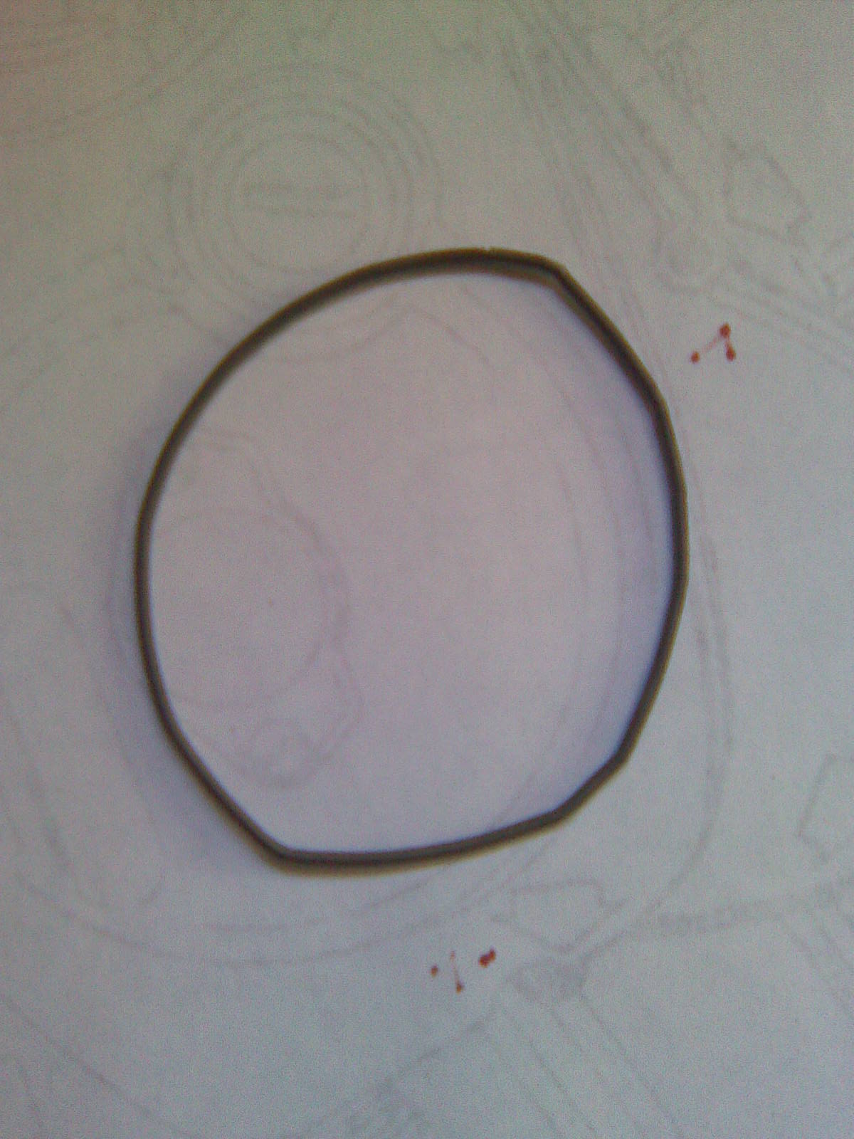

  1. Finally got the bloody rotor off after much cursing and fabrication of a puller (my puller claws wouldn't fit behind the rotor), but I first had to chip away loads of Loctite concrete (green) in the groove on the face of the rotor.....
    Couldn't get the flywheel off without removing the pick-ups plate, so I hope I marked the washer positions well......Don't fancy having to ponce about retiming the ignition.
    Anyway, here is the sprag spring..............Anything look wrong with it?
  2. Well........I shortened the spring anyway, first of all by 10mm; then 12mm; then 15mm................None of the alterations to the spring had any effect when the flywheel etc had been reassembled on the shaft and still the strange noise from the starter area and the gears which indicate the starter isn't turning-----but removed the flywheel and starter gear; tried the starter and the gears turn......
    ......so I finally fitted the spring from a 41mm fork seal, which is really tight..........reassembled again, pressed the starter and behold the engine turned over a few times but not continuously, back to the buzzing sound.......
    So, is the starter sprag bearing shagged out altogether?

    However, I'm not convinced it will work because the spring is larger than the one that I have used which is really tight and which just slightly improves what is happening with the sprag by the sound of it.......so on that basis, I reckons the bearing needs to be replaced completely.
    I did think the battery which has been slowly failing may be causing the problem, but if piddling around with the sprag spring makes a bit of difference, I can't see its the battery......anyway, I think I will change the battery as well and check the starter motor brushes while I have the cover off.

  19. I think what had occurred is due to the 'failing' battery......could be wrong though.......it is still capable of spinning the starter fast when it is off the bike (and I wouldn't like to grab the pinion when it is spinning).
    It had been 'failing' for some time so possibly the sprag had not been properly 'engaging' and the spring was well stretched.......the spring also showed signs of damage near the joint, so it needed to be removed before it broke.
    The sprag itself may have been alright to re-use if the spring was replaced, but I had decided that I wasn't going to risk doing it all again if the sprag was faulty, bearing in mind I had tried shortening the spring and tried a fork seal spring.
