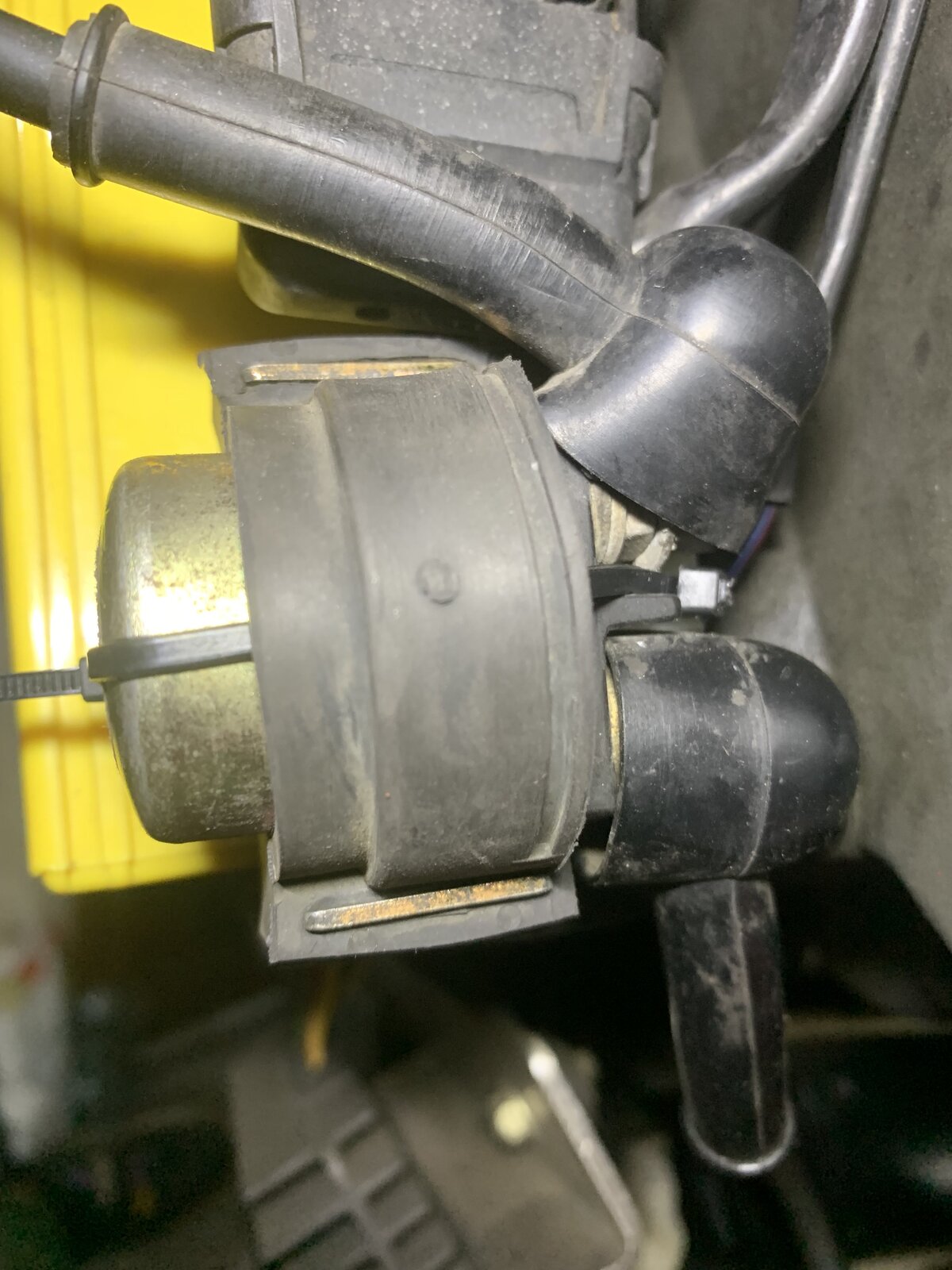

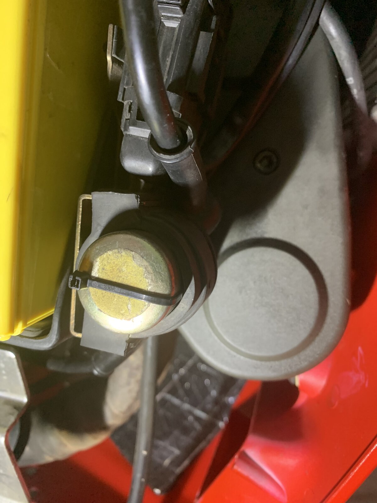

Many thanks, Birdie! Just fixed it as described. Steps taken: 1. disconnect battery (negative first, positive second) 2. release the cable going into the solenoid from its direct connection to positive side of battery so that you can take the solenoid out 3. take solenoid out pushing it with rubber part from the metal brackets 4. take out rubber part (mind how it fits on the solenoid) 5. attach cable tie -> space is tight, so use narrow cable tie (can join two/more to get longitude), decided to place it between the two cables going into the white plug in the back of the solenoid 6. place back rubber part minding the shapes matching the solenoid 7. place back solenoid with rubber part on the metal brackets (small dents on the metal brackets will come out) 8. attach cable connection to the positive joint 9. connect the battery (positive first, negative second) Sharing visuals of the cable tie connection... If someone has a better connection solution, pls share. Have fun and ride safe, Aleksandar
When I boughtr by brand new St4s in 2002 the dealer (i think) cable tied both solenoide and white connector.
