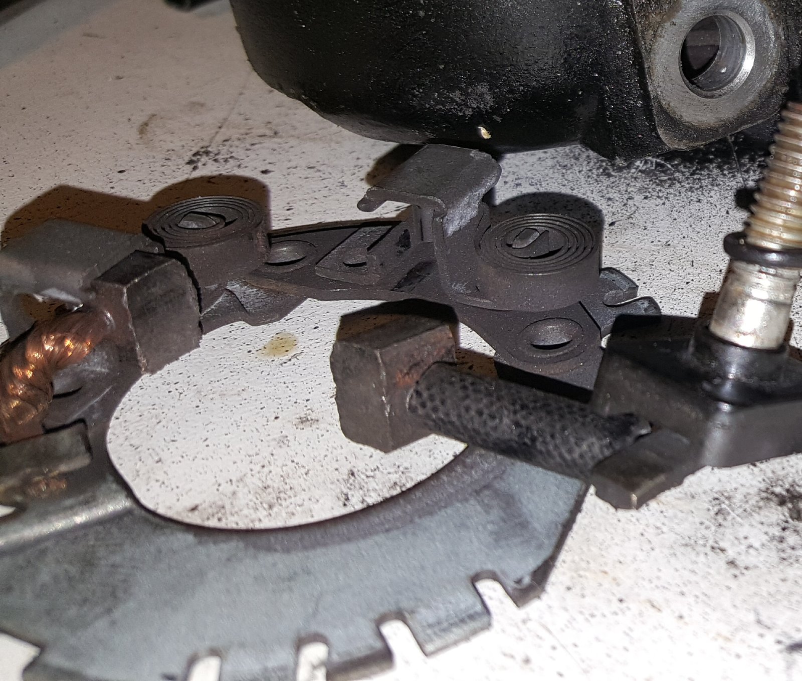

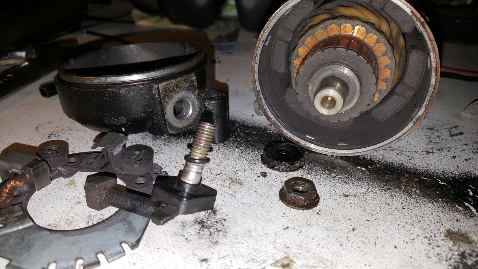

    Starter motor removed by my duc technician brushes in a very worn state. Although crank speed high - brushes are done, which is a bit of a contradiction, probably means windings are good however contact to them poor. I,m considering buying a complete starter motor rather than just brushes "just in case" will keep you posted if problem solved...thanks again for all your support..Paul..

  17. Hi guys thanks again for the brilliant support this is very generous of you all, interesting note about the idle control valve. Today I ordered the starter motor not in stock but will have in about 10/12 days and also got hit for extra delivery to the frozen north:( I will if I can work it out put up a picture of the brushes) I'm hopeful the new starter motor will sort this, Kenny who has been helping me ( ex duc technician ) is reasonably confident too..here's hoping and keep you posted..Paul
  18. I'm hoping these pictures will tell story and I have a happy ending in 10/12 days...

  20. These brushes are certainly pretty worn. I can't see the commutator very well in your photo but it seems to be in reasonable condition.
