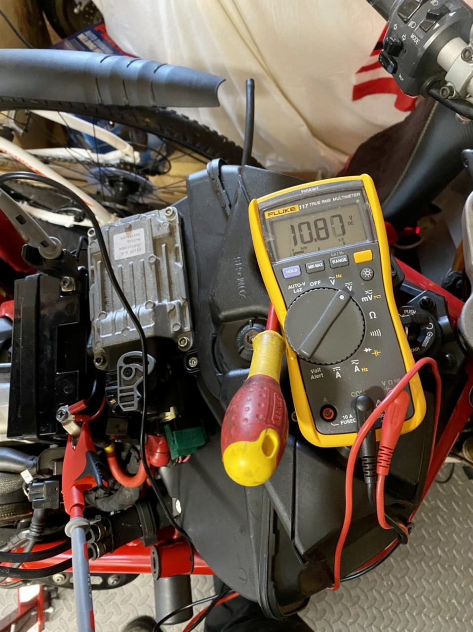

  1. The battery is FUBAR, change it, do not go down any rabbit holes until youve done that. I speak from experience, had a battery giving exactly the same readings as yours snd gad exactly the same inability to start. I changed plugs, swapped coils, removed, cleaned, refitted and tested injectors, changed the CPS. All rcause si was convinced my battery was fine. In the end I did the test I set out above, then bought a new battery, guess what? It started first time and I’ve had no further problems.

  3. I disagree about the battery, it's not a certainty that it's no good just because of those voltage readings, i've had a 1098 show similar, and it's continued to start the engine for a further two years. There's nothing wrong with changing it just as a way of ruling it out, but cranking speed is good.

  6. I agree the cranking speed is good, I’m just going off my own direct experience Chris. In my case the situation was exactly as described by the OP and in his video. The bike would almost start but just wouldn’t. Someone suggested to me it could very well be the battery but, as the voltage across it was good and as it was always kept on an optimiser, I dismissed that suggestion. I must have gone down every single rabbit hole I could to track down the issue :(, just could not locate it. In the end I did the test I outlined above, got similar results to the OP, bit the bullet and bought a new battery. I was gobsmacked when the new battery read 13.1 v and still stayed well above 12 v at key on (and my lights are set to be on at key on as well for DLR purposes). In fact it barely dips below 12v when starting and started first press of the button.

    Voltage drop on starting
    The old battery fell below 11v on starting.
  7. Ditto, and not meaning to stray off topic, but what was the bike? I can see that using an accurate meter helped, and (not saying you did) starting straight after a good charge would also show favourable voltage during cranking. I don't know what time of year it was, but would be interested to see your cranking voltage at say, 3 deg C cranking from cold, on a battery that hadn't been charged for 48 hours (just being devil's advocate). You can sometimes get a whole group of ingredients not behaving as they did when new, and the battery replacement might appear to "cure" the whole problem, but really it was just the straw that broke the camel's back and other factors also contributed to the overall failure to start/run/etc.

  8. That was about a month ago, I’d guess the air temp was around 8c. The photo with the multimeter at 10.87 was what the old battery dropped too when cranking (I said starting above) but it always struggled to start. I’m now convinced it was because the battery had insufficient power to feed the starter and power up the coils with anything more than what would result in a really weak spark as I found no other faults anywhere. Oh, the bike is my Monster 1100S.
    Re cranking after not charging, I know the new battery still cranks and starts the bike after a week of not being connected to the optimiser (I forgot :() although what the voltage was I don’t know as I wasn’t testing it then. The old battery, which I thought was perfectly ok, drops to 10.5v after a couple of days, even though it’s not attached to anything, and then just sits there at that level; it’s on the workbench now for testing things.
