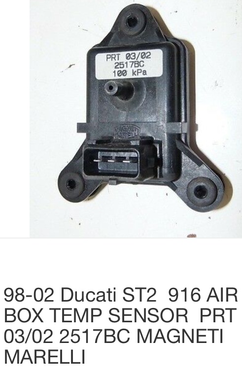

  2. You have triggered a memory, could well be the air temp sensor playing up or equally as likely, the connector itself as it loves to retain moisture and corrosion particularly if rubber boot perished and they often are. upload_2021-5-4_4-20-54.jpeg
  3. looks like a pressure sensor straight out out of a cinquecento. which has also sparked a memory. it's the same symptoms as a Mrk2 punto, or was it the Grandi? cant mind, but they use the air temp sensor for fuelling rather than the coolant sensor for start up. and they failed regularly but if you gave it a bit of throttle and held it at a fast idle for a mo, it would be fine.

  4. That's the air pressure sensor.
    Will check it along with temp sensor under headlight.

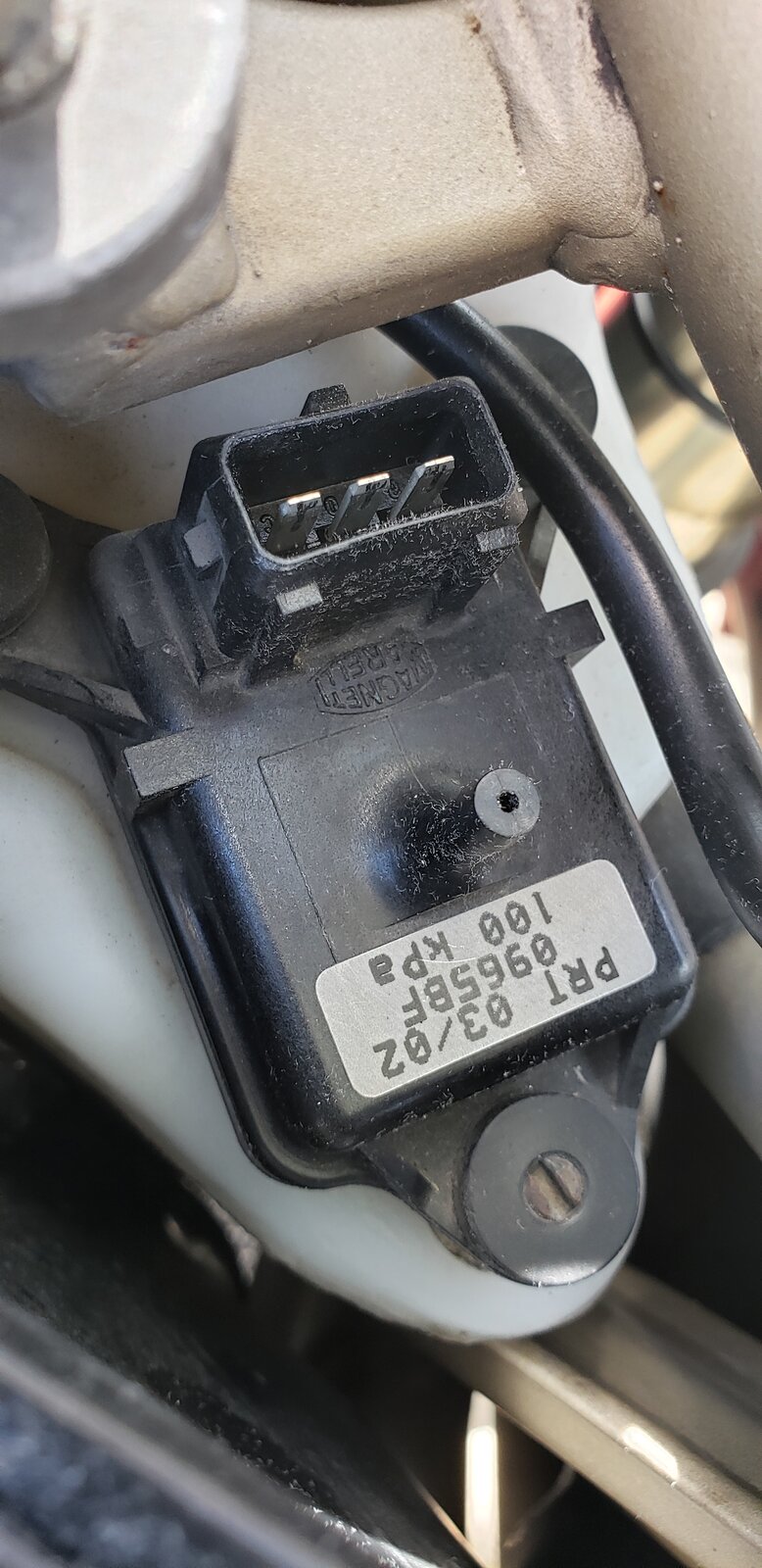

    Checked air pressure sensor connection as recommended. Looks clean:
    Plug & boot was also spotless. Considering the age of the bike, really not a lot of decay on rubber or anywhere else.

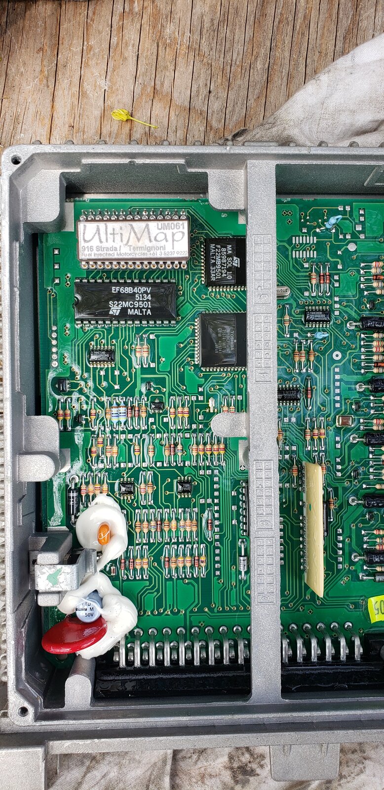

    Checked ecu because why not.
    No corrosion, eprom clean and secure:

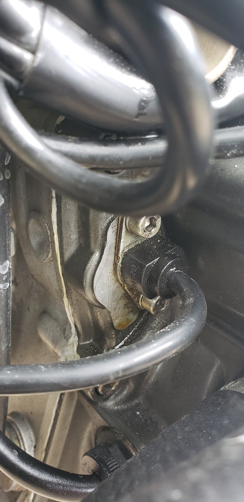

    Noticed a bit of oil around RPM sensor... is this a reason for concern?

  10. It’s good to cross all those checks off the list, if you had a spare crank position sensor, that would be another one to try. Can’t really comment on the oil being a problem or a factor here.

  13. Worth investigating at some point, but most likely not the cause. You're getting sparks, which wouldn't happen if your timing sensor wasn't firing. It *could* be intermittent, but probably unlikely.
