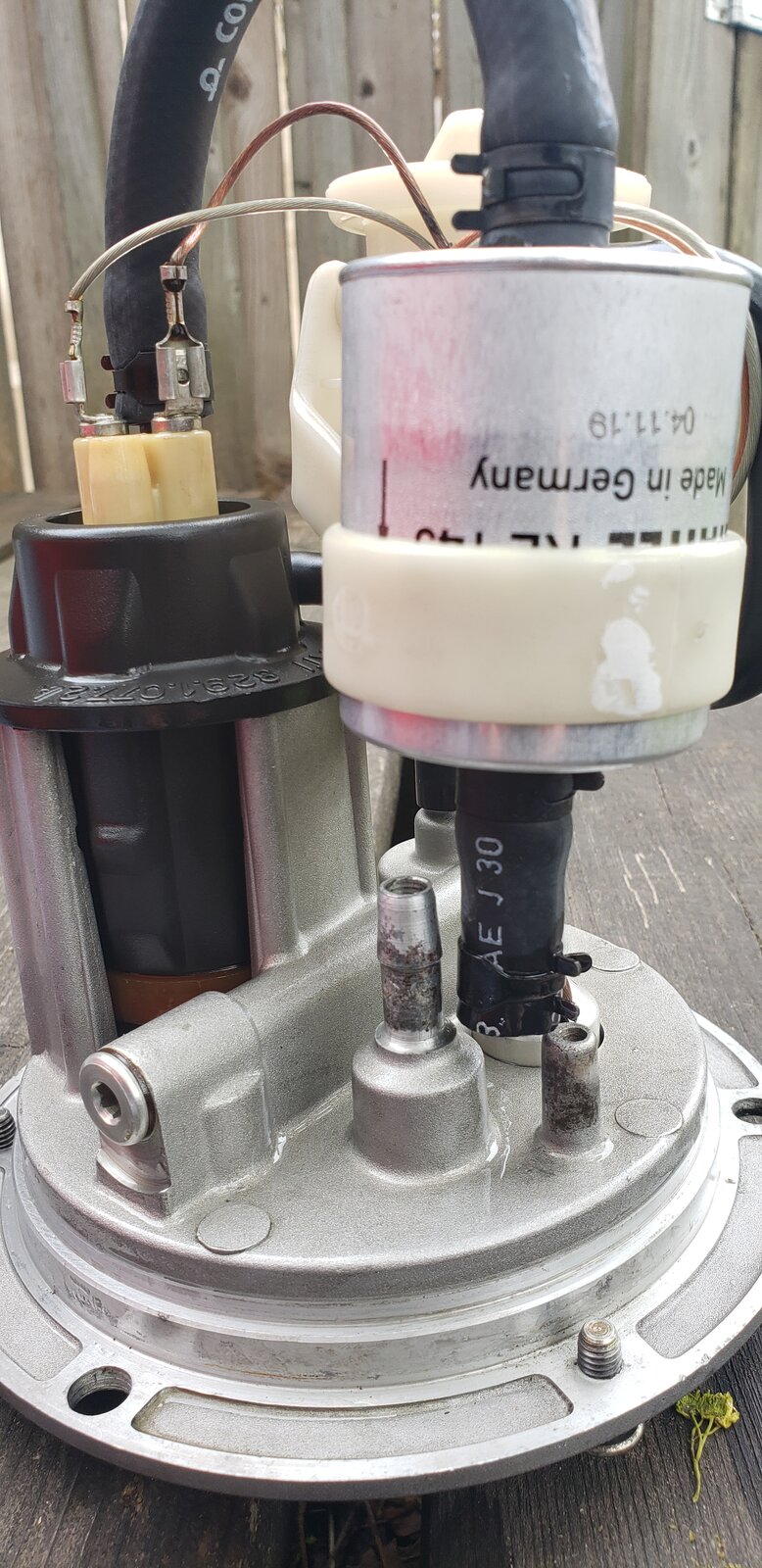

  1. ISSUE RESOLVED - fuel line popped off
    After hearing both relays click, I was sure the old pump must've been the problem.
    Upon taking out the fuel plate, this sight greeted me...
    Petsmith- you called this one straight away. I had checked the tightness earlier, but it still came off. Unbelievable that fuel could still get to the injectors even with an open loop in the lines.
    Reconnected, fuel plate back in, pump noise now sounding like it should... and bike starts up straight away and idles perfectly.
    Of course it does.
    Thanks everyone for all the help on this. Think I need a beer...

  2. Well done. Fuel filter, so simple when you find it, pain in the ass when you don't. Have a beer for me:)
  3. well done TNR, great to hear it was the obvious one this time, your perseverance definitely deserves an hoppy reward. :beer::beer::beer:
  4. Great stuff:upyeah:.
    Id say you had fuel reaching the injectors under gravity hence the initial fire up but not run. I’m glad you got it sorted :upyeah:
  5. who changed the fuel filter after 4/11/19............
    and given the PSI of the fuel in the pipe who has used those clips as they are the root of the problem!
    they should be Oetiker clips or jubilee ones!

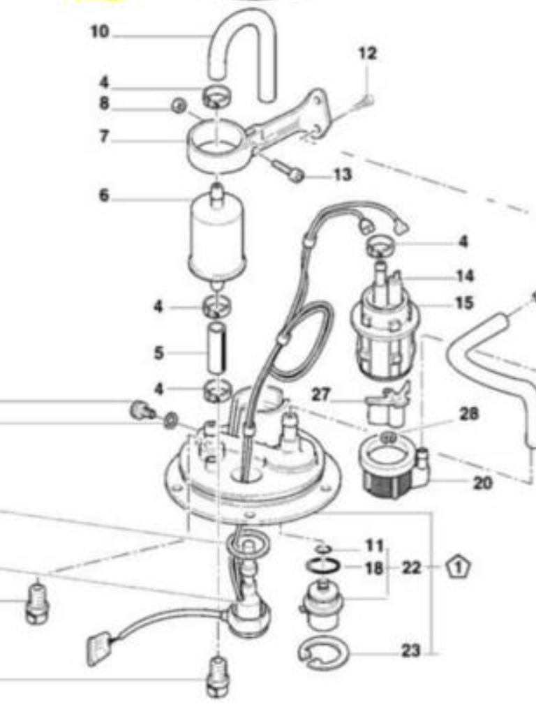

  6. and there you go........
