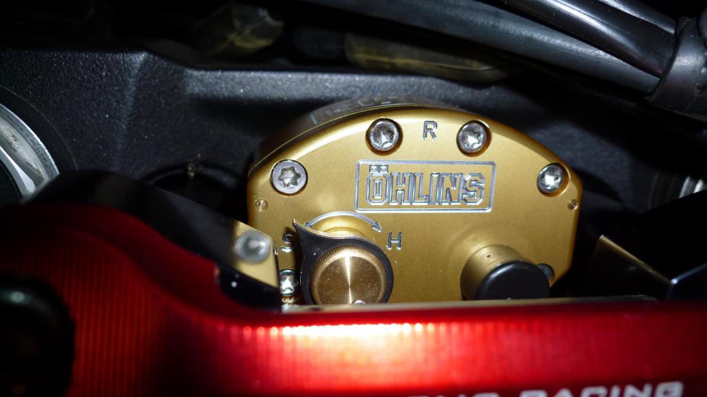

    Love the steering damper. It must have at least 50 clicks from soft to hard and they aren't linear.
    I'm running 4-5 clicks off stiffest and that suits me. Any stiffer and I won't be able to park it.
    Any softer and it appears to do nothing. I'm sure a racer would say different. Great bit of kit, no high speed wobbles, a slight weave when pushing the barn door of a screen at take off speeds, along a sweeping bend.

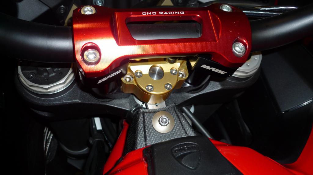

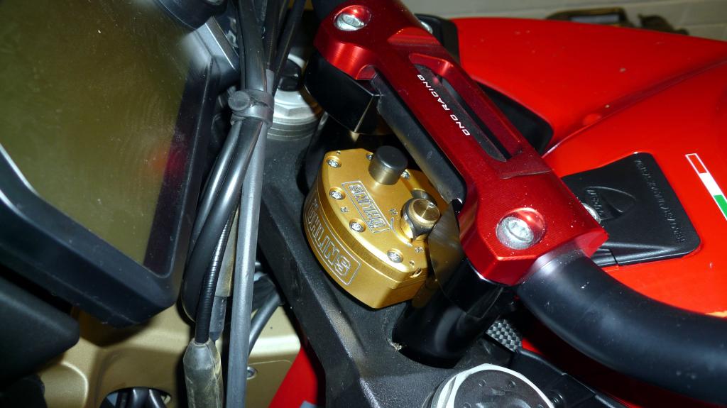

  4. Got mine fitted, bit fiddly to fit for big numb fingers

  10. Well I am obviously doing something wrong ??
    Does the arm off the damper rest on top of the clamped fixed point ? I have a gap of about 6mm between the two, I can't seem to get the sleeve with the flange on the end to fit it seems too long ??
    Can someone post a pic of what this looks like under the Carbon cover please !
  11. Where are you?
  12. I think I have sorted the problem, does the sleeve pass through the slot in the arm of the damper, if so the slot in mine isn't big enough the sleeve doesn't pass through !!. I'm going to have to machine a big enough slot.

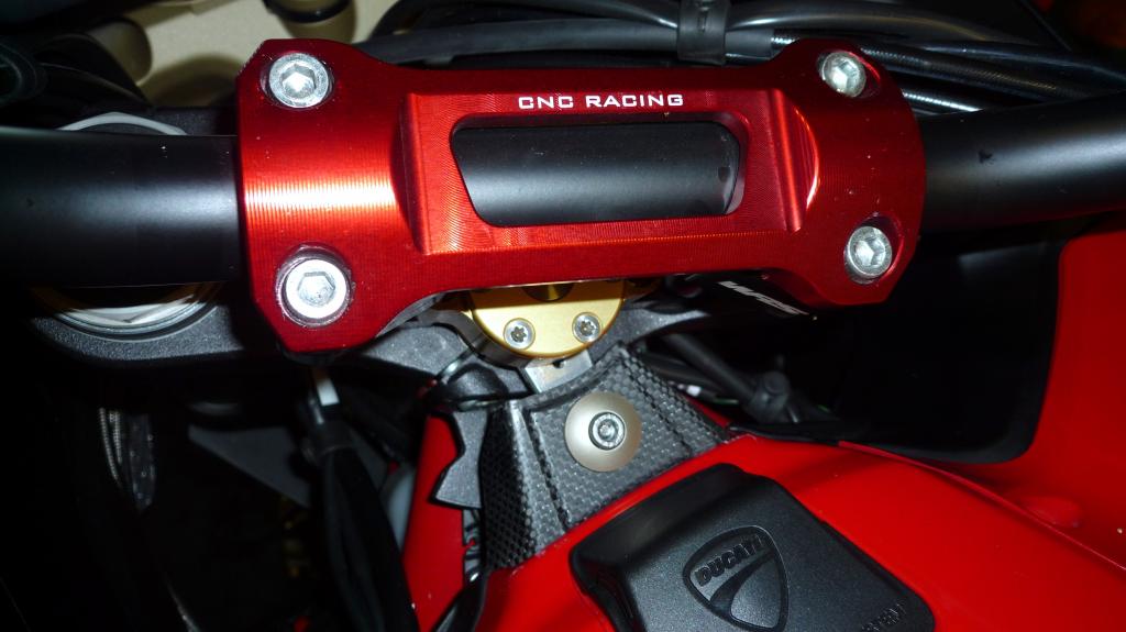

  15. I fitted a steering damper on my DVT. I always fit dampers irrespective of 'need' cos I like heavier steering. I intensely dislike a head shake. :)
    I originally had a Ducabike tank mounted unit - which I was never keen on, then switched to a more discrete CNC Racing under-yoke type.
    The one I had and then took off
