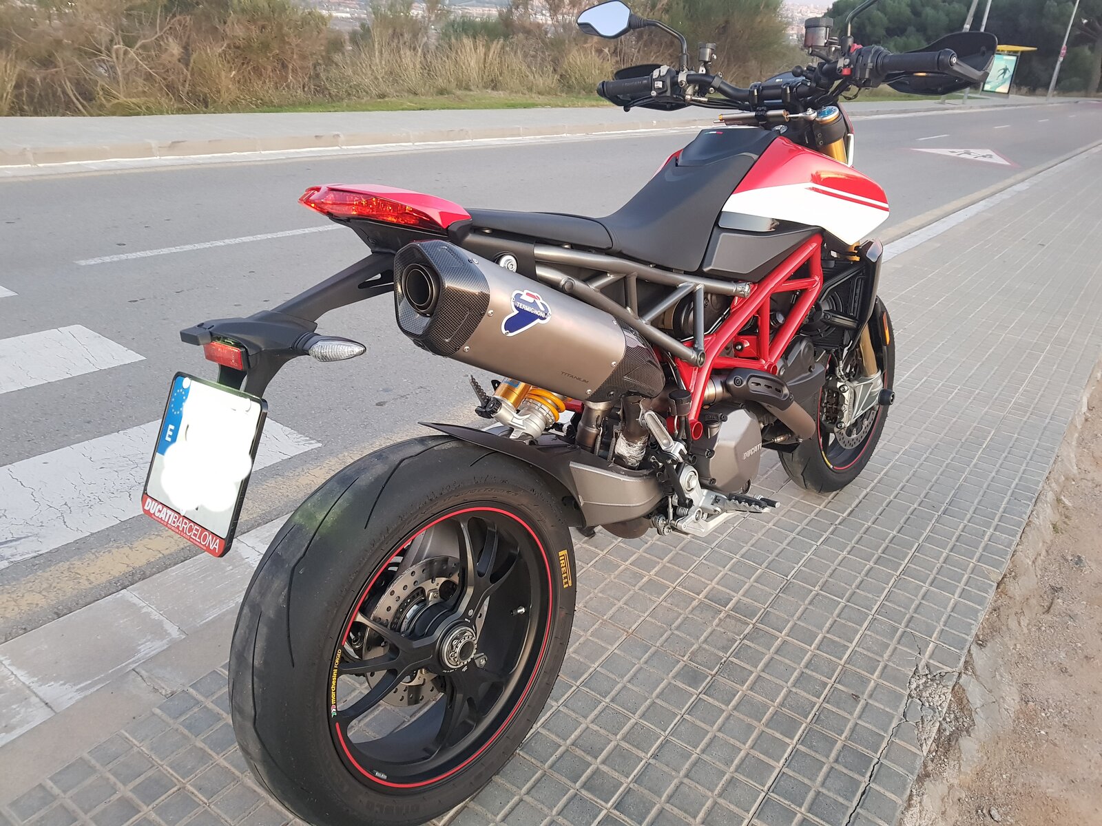

  4. I have the ducati performance set, i set it in the 4 position for urban use, i
    Hi!
    First of all, sorry for my english.
    I have the ducati performance kit, and it works perfect, in my bike the setup are in the 4/5 position and is enough, if i set in the max, i can move a little but i can't imagine using this.
    One friend is working in a team, and he say me, the stering damper we can buy for use in road, have a safe setup in the max position. This setup can be removed changing an inside needle "valve".
    Maybe the ducabike setup have it to soft, i don't know, i always thinked the damper are the same.
    Hope this can help you a little, maybe you can contact with the dealer or Andreanimhs.

  6. Hi!
    Yep, i feel it more strong. I think the ducabike bracket are the same than ducati performance, if you not feel more strong, i think is the damper.
    Yo can zoom my photo to see the bracket.
