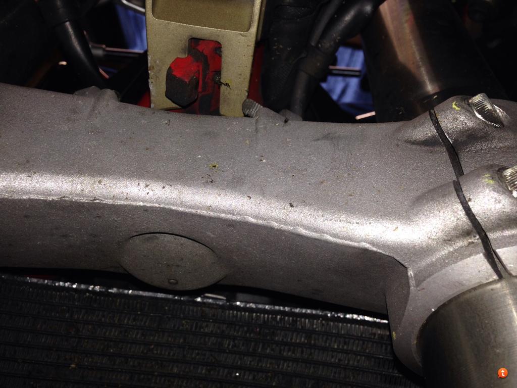

  6. Just taken this pic before I start.. It looks bent I think
  7. Lol. Yep. Your bikes been down the road on its lhs. That might need some heat to bend back. But you can try using a club hammer and a drift. Thats a fairing and light off job. :(
    damn things are like chocolate.
  8. Noooooooooo!!!!!!!!!!!!!!!!!!
    Thats not what I wanted it to be?:Nailbiting:
  9. Also check that the setting grub isn't bent.
  10. That happened to my bike last week. Should be easy enough to bend back with the right amount of heat and room :)
  11. Is just taking all it's clothes off,.. Didn't want to do that. :(...
    I've checked all over bike & can't see no other sign of it bring dropped... Really strange..
    I'm still happy with the bike to be fair...
