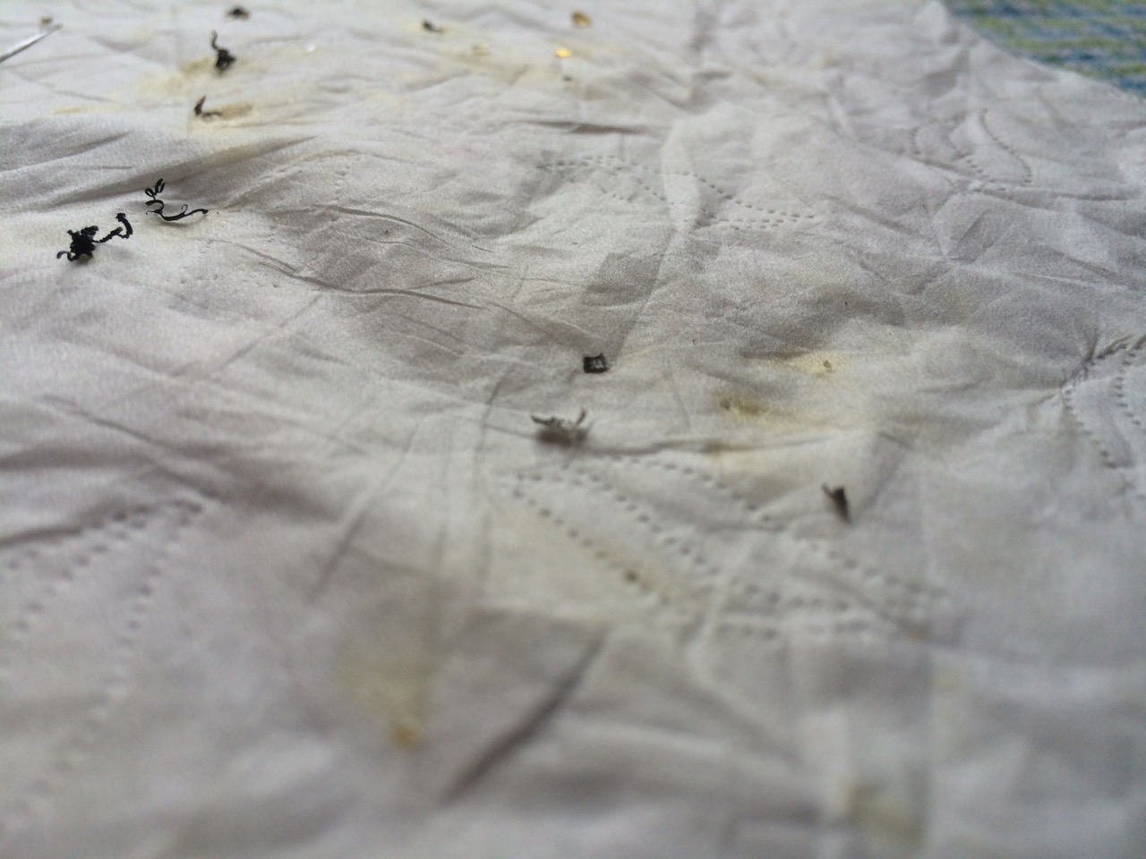

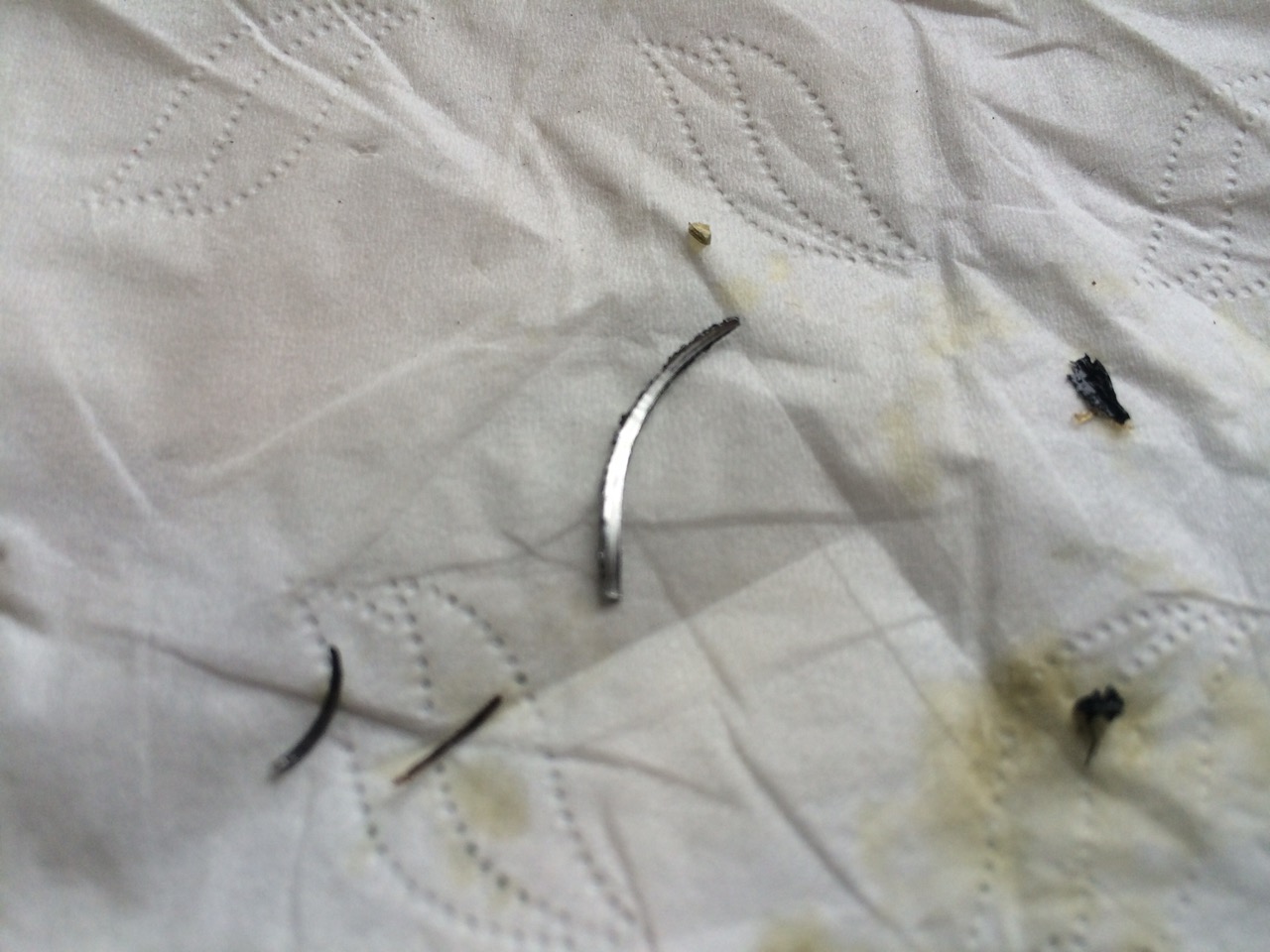

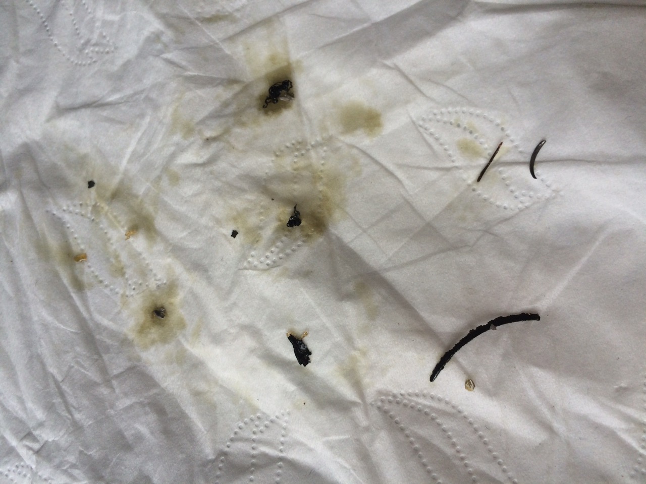

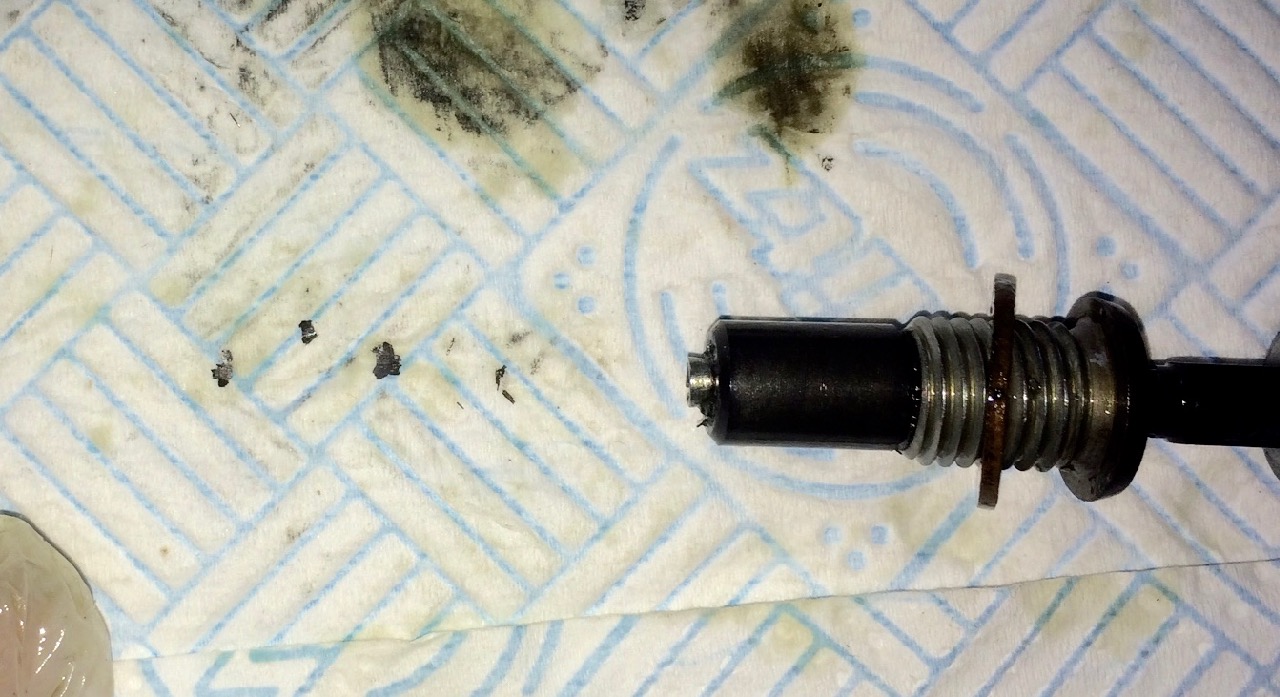

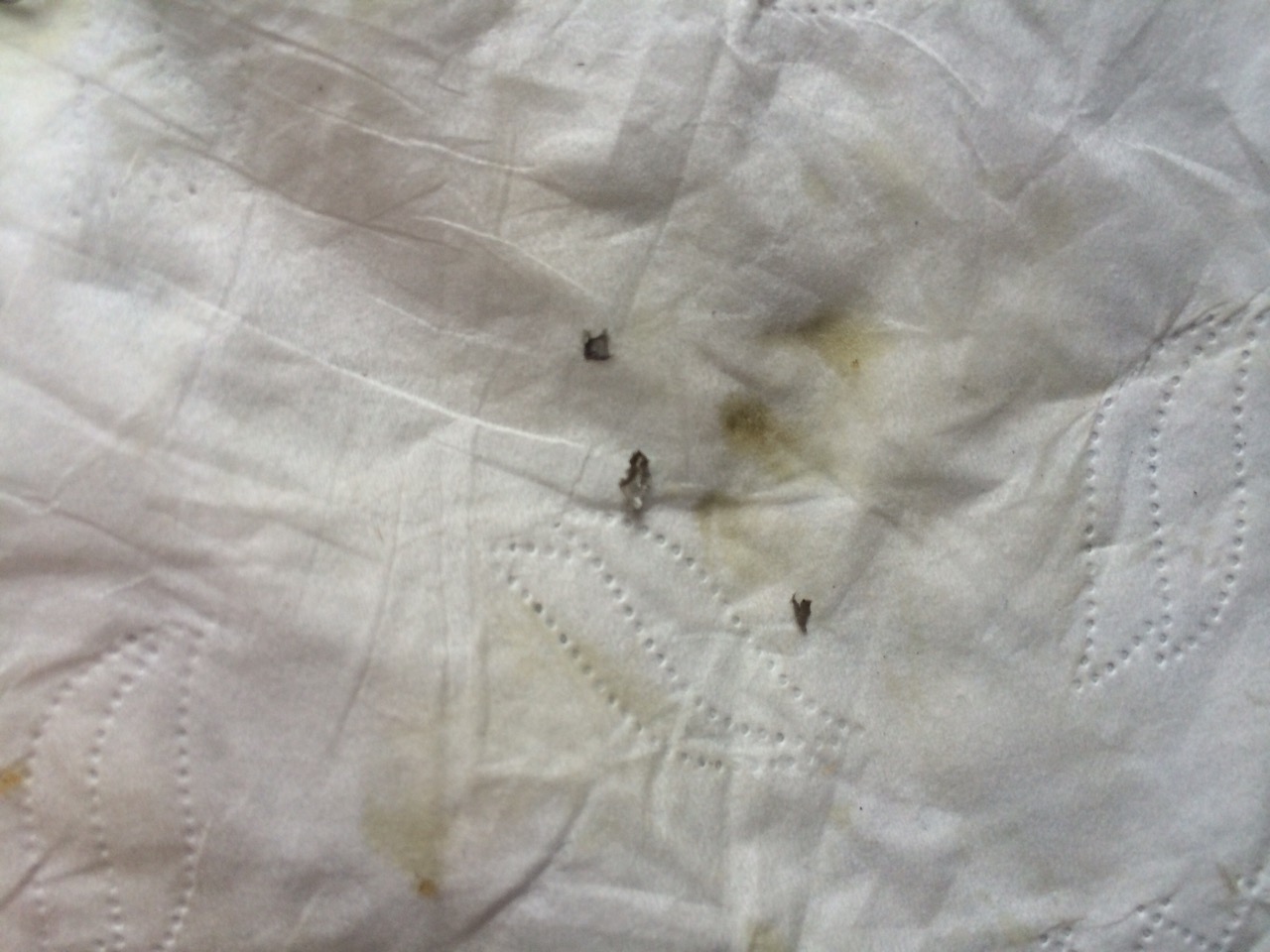

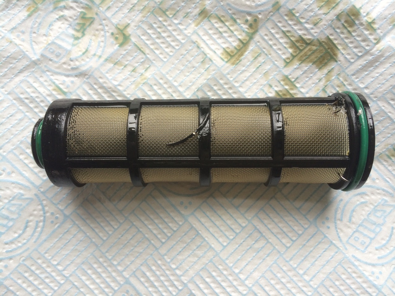

  5. So I dropped the oil and gauze. This is what I found.

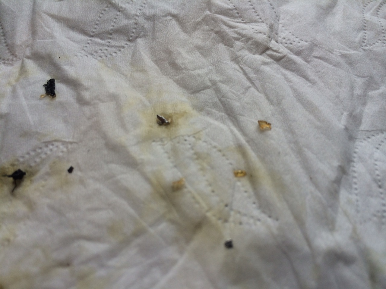

    Could well be a bearing is on its way, but no paste. Aside from the metal shards that obviously were part of a ring or metal there are some transparent amber bits that look somewhat like what I've seen holding ball bearings in place in this vid:
    • On the magnet I found the same as before: splinters and flat pieces of metal.
    • From the gauze, the large ring fragment is black on one side, metallic on the other - perhaps this gives some clues what part its from?
    • What I thought was paste was some non-metallic grey material. Plastic? Gasket/sealant?
    • Curly black objects appear to be non-metallic too, spring back to shape, some sort of plastic washer?
    • Flat, black, non-metallic material.
    • Some amber, transparent, hard pieces.
    Amber bits:
    The other side of the 'ring' is shiny metal
    Curly non metalllic bits top left, grey bits centre:
    Gray non metallic bits:

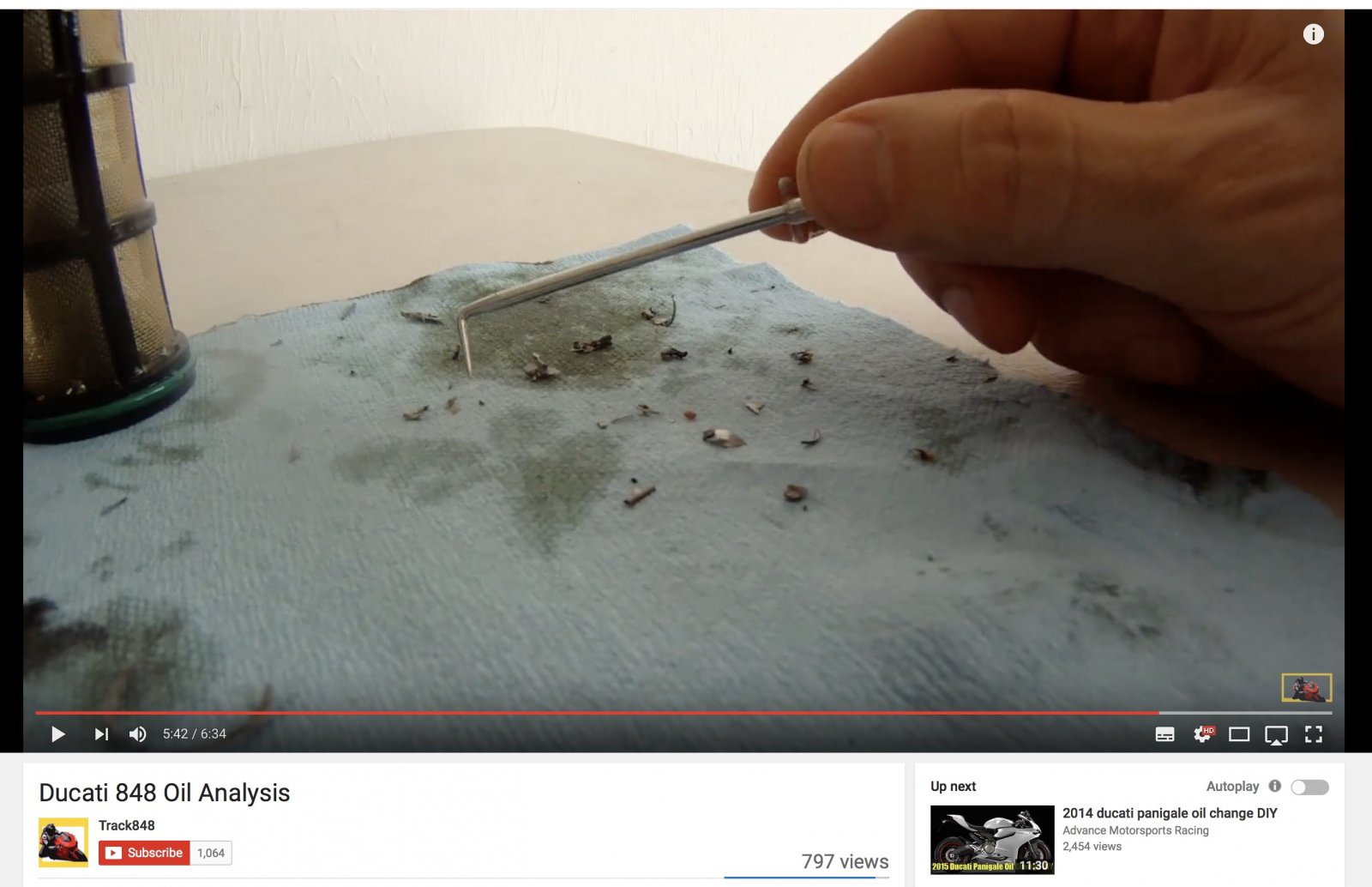

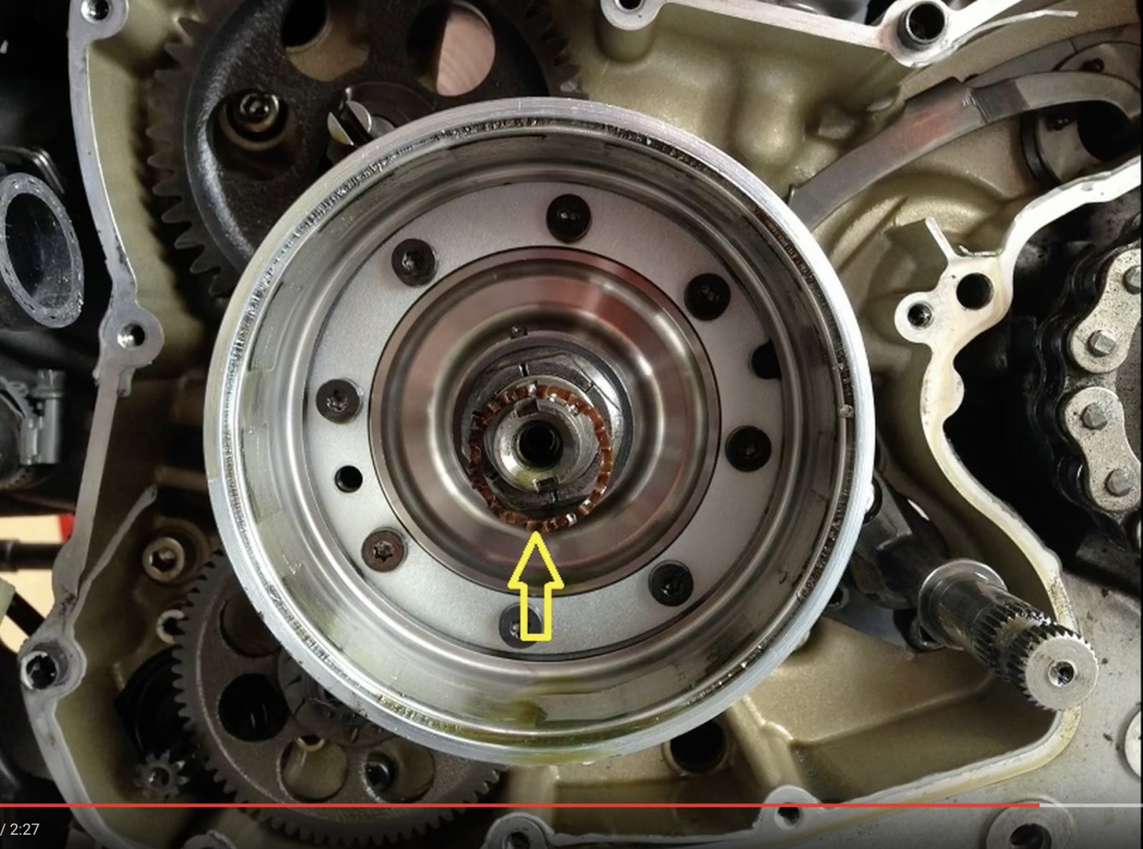

  6. Here's a grab from that vid showing the amber part, save watching the whole thing. Not 100% convinced its the same material though.
  7. Had a chat with Rich (Louigi Moto) and we're still none the wiser. Doesn't look like a big end bearing as no metal pieces were bronze/copper coloured. One idea suggested was that the clutch spring are rubbing on the inside of the clutch cover, hence the black plastic shavings.
    I'm fairly sure the grey pieces are just liquid gasket and the amber bits must be from a bearing cage. I found another video from the same US guy (Track848, he has quite a few good videos up on YT) examining his oil debris, and it looks very similar to mine: metal shavings, flat bits, grey bits of gasket and... amber bits. Turned out it was the alternator side bearing on his bike, so I'm going to be checking this on mine.
    This is his debris:

  9. I was told that the grey / clear silicone stuff was what they used in the factory for sealing. Shouldn't be owt to worry about.
  10. Yep, 99% sure that the grey stuff accounted for. Got a tube of it on order ready for pulling off the covers. That said it, even if I do have a look myself there's not much I can do about it. Need to book it in to LM asap.

    Pop the small cover off the flywheel side. And have a check of the support bearing. If the mains are on their way out it normally flogs the hell out of that small bearing. Good luck buddy. Hope it ends well.

  20. If the small (generator support bearing) has failed or well on its way. The main bearing have gone I'm afraid.
    If your mechanically minded/sympathetic. Remove the generator cover. And see if you can feel any float in the crank. By either trying to move it up and down by hand. Any play will be small. Or. Very carefully with a lever try and lift the flywheel with you finger pinched between the flywheel and the cases to detect any movement.
