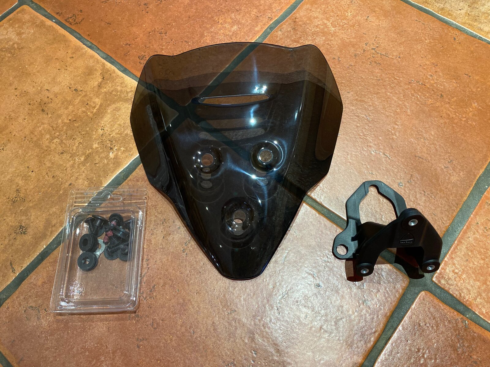

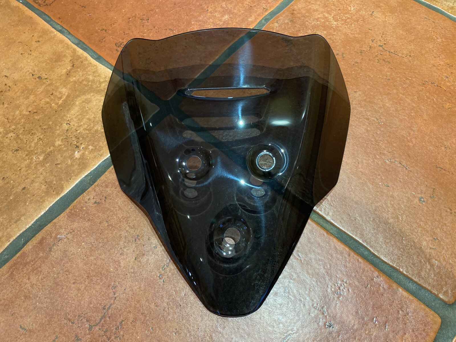

  2. This is what you get when the kit arrives. I keep thinking 'Cyberman'. No instructions, but what could possibly go wrong?

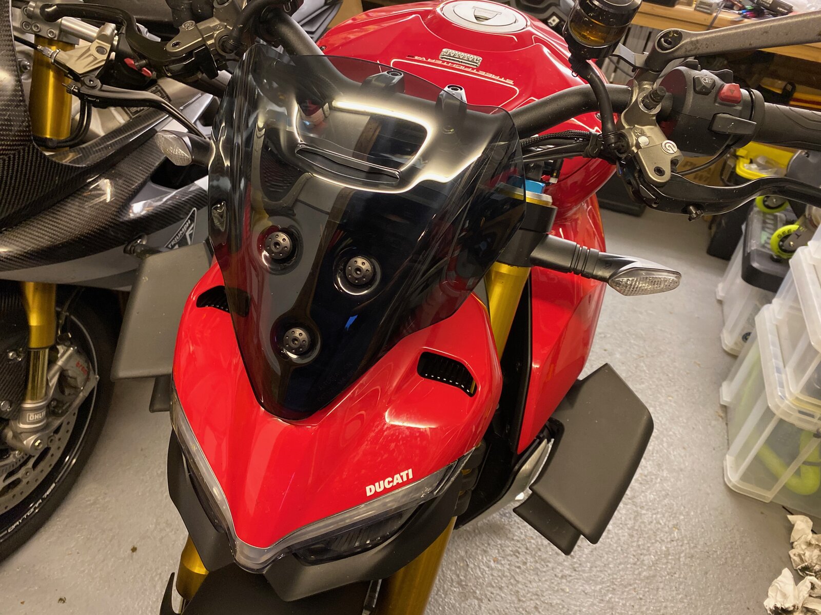

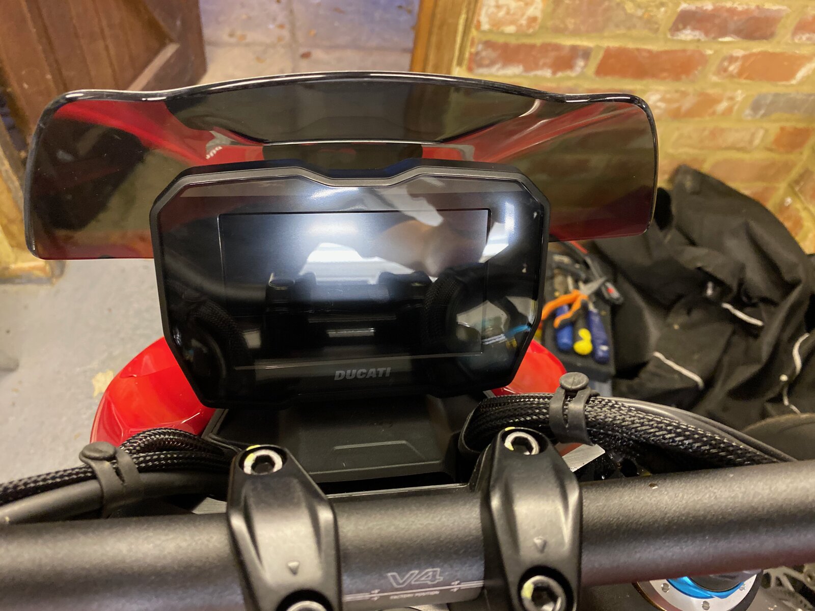

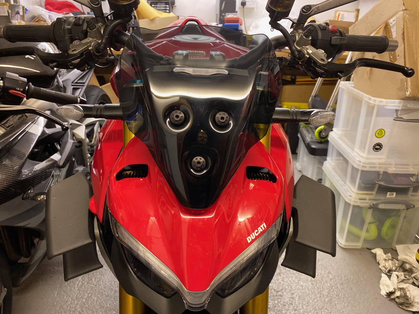

  9. Here's pictures of the fitted screen. Will take some shots outside of the cramped confines of my parking structure tomorrow. Fitting is pretty easy. Pull open the back of the instrument panel (amazingly/worringly easy) and then attach the screen bracket to the existing instrument bracket making sure the shouldered screws seat properly. Then attach the screen. Then as you type realise you have not refitted the plastic shark nose piece you have to remove at the start... Bollocks. (It fits in the trough just below the leading edge of the screen.
    I think it looks just right.
  10. Looks the part.

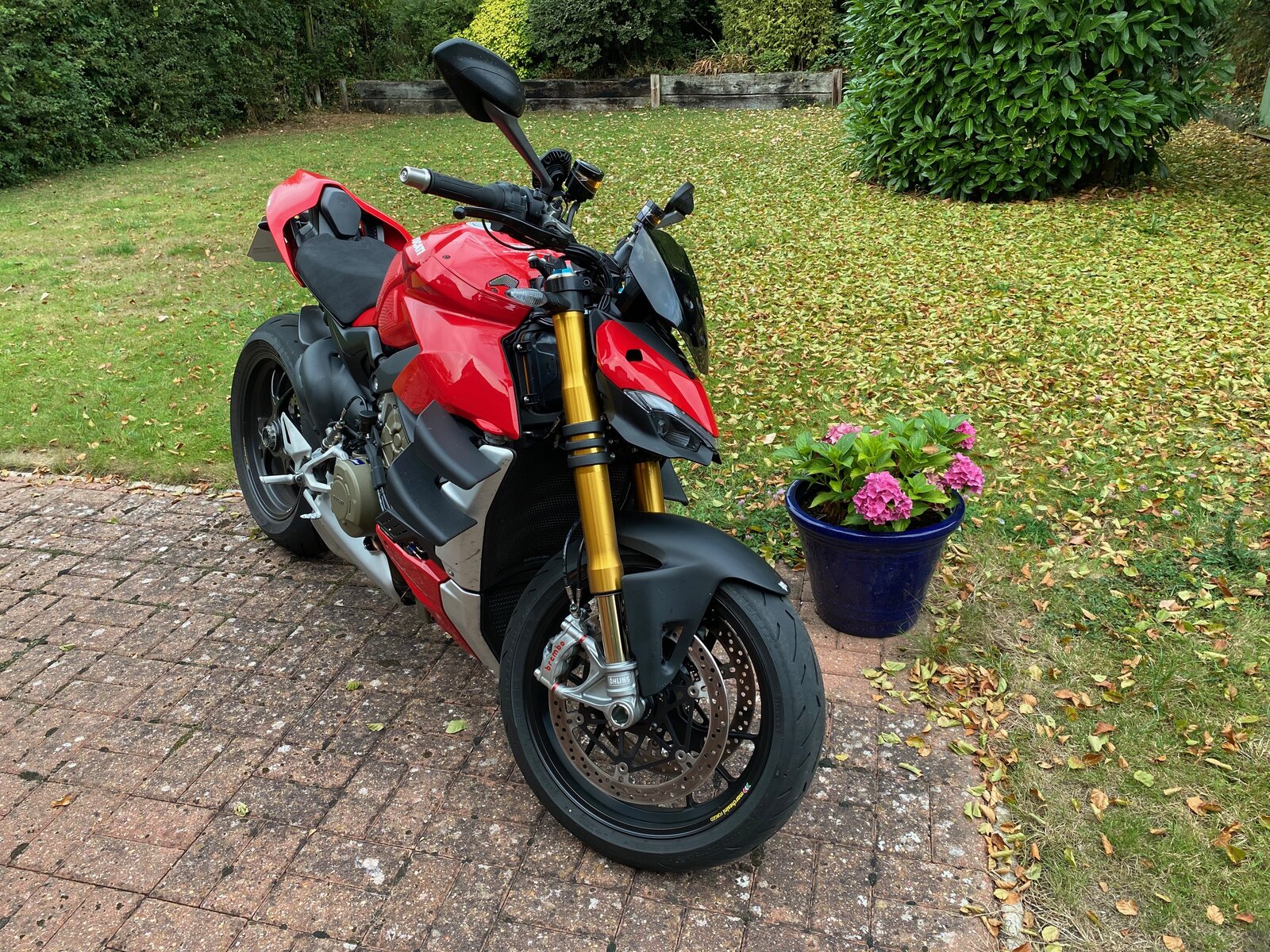

  11. And a wider shot. There is a shot with a bin in the background available for those who insist on forum etiquette. It's just not a very good shot of the bin.
    Bike needs cleaning, but I can't be arsed as its coming to bits shortly to improve the aesthetics with some ceramic coated parts.
    Still hard to wheelie. My 2018 Panigale V4S wheelied like a bastard in the first 3 gears - I'm amazed how civilised this is even with wheelie control off. Given the intent of the two bikes I think Ducati got it the wrong way round.
    I'm going to lobby for a fourth engine mode - 'Loon' to give full torque in the lower gears. You know it makes sense...
  12. looking good and second your lobby suggestion. Just done 500 miles over 3 days in Harz mountains. absolutely awesome and perfect streetfighter country :upyeah::)

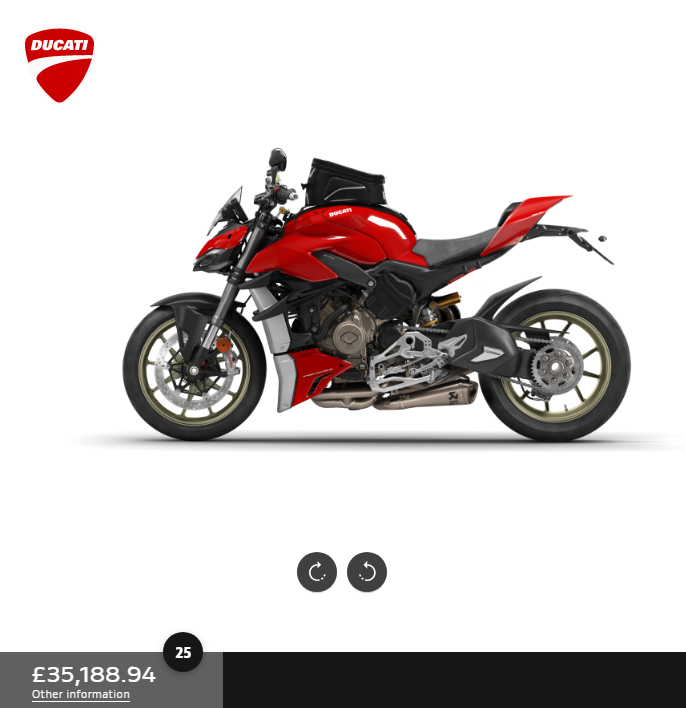

  13. No problem speccing it up to over £35K with a selection of accessories! :cool:
  14. ...but you started with a base model! Get that suspension upgraded to the Swedish gold! You know it makes sense! :)

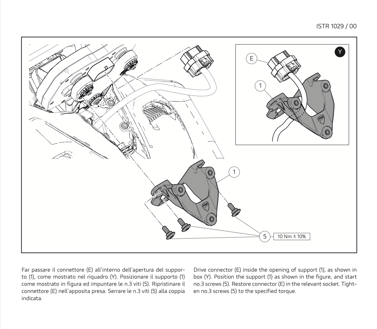

  15. Did you put the bottom screw in the mount? I can’t fathom how to get to it once the black plastic cover is in place (tried going through it but the angle not quite right and the bolt won’t bite) and if I fit it first I can’t get the black plastic cover on as the mount is in the way! Doing my tits in!

  18. You have to attach the mount before you put the plastic cover, as shown in the assembly diagram. Once attached, the cover can be pressed back on. The cover is a bit fiddly to get in, but it does eventually slot into the bushes.

  20. Cheers buddy. Eventually worked it out. As you say it’s a bit fiddly and doesn’t seem any way that the last piece of the jigsaw would fit.
