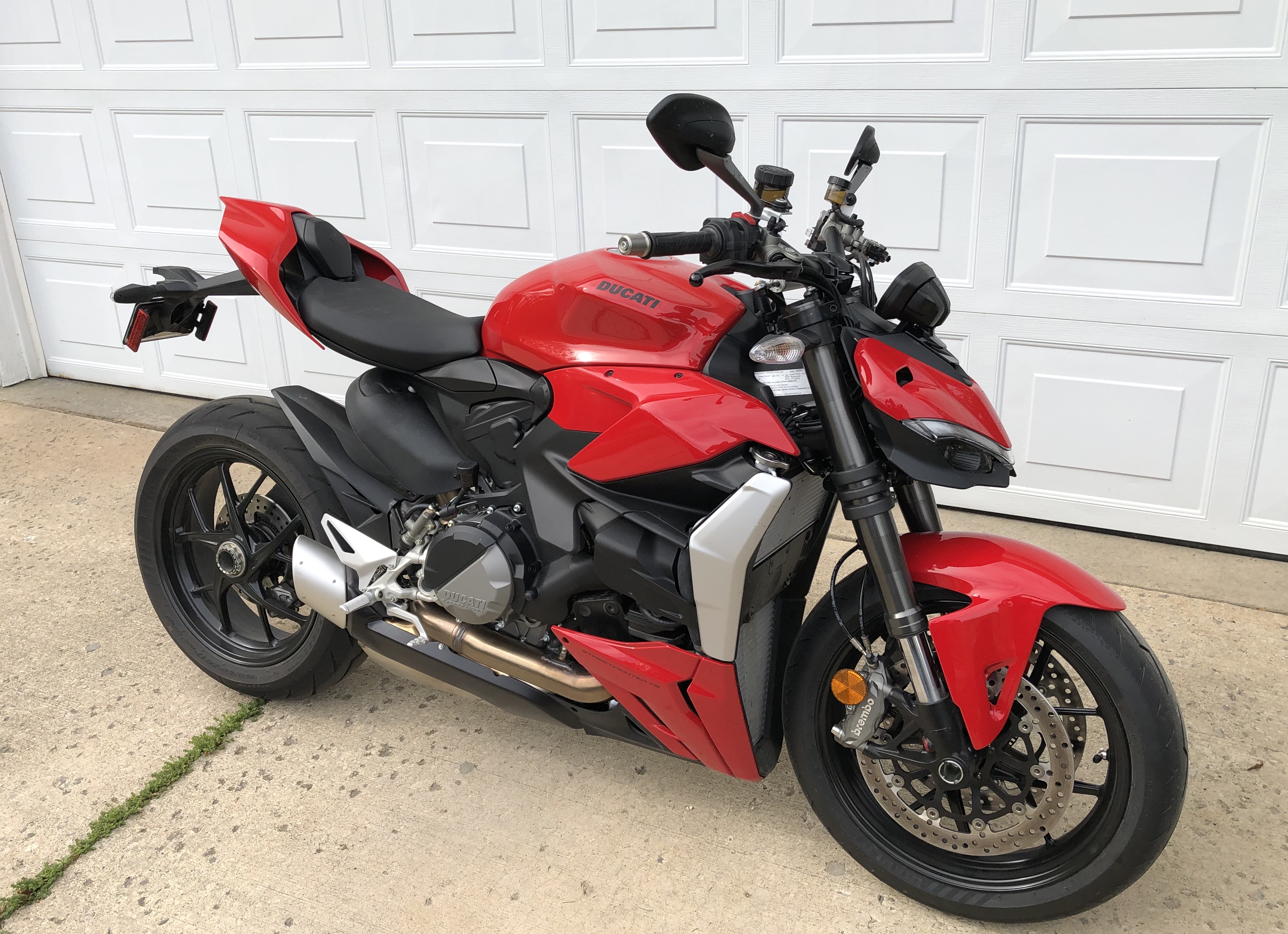

    I removed the passenger seat and pegs on mine today. Added a radiator guard too but right after the pic was taken.

    Bike look great. First one I've seen with a red front guard fitted. Any issues removing the rear pegs bracket?
  12. The rear pegs were a little tricky until I figured out how they go together. You can see that the bracket is countersunk for the two rear bolts - the front of the bracket has the same countersunk holes that bushings attached to the heatshield fit up into. You have to lower the shield as far as possible and push the bracket up as high as possible to get the bushings out, and even then it requires some effort. I split the bracket (it's held together by two bolts) to make it easier. The right side was easier than the left, not sure if that's typical or I just got lucky on the right side.
    Four bolts to remove the bracket, two of them go back in with spacers to reattach the shield, The other two are too long to reinstall and cover the holes. The good news is, if you buy the solo tail it comes with the spacers, and you can use the bolts that hold the strap under the seat to plug the otehr two holes from the peg bracket.
    I'm not sure about the red guard yet. The first bike I saw was right out of the crate and hadn't even been cleaned yet. The stock black fender looked cheap when it was dusty, so I was deciding between red and carbon fiber. I decide against carbon fiber because I want to get all the same brand parts if I go down that road, so I went with red. It's off of some other model, I've already forgotten which one.

  15. I’d be interested in the red mudguard. What was the cost? Let us know which model it’s off, once you remember!
  16. I like the red mudguard as well. Hopefully you can remember which model it was from!
  17. I reckon it’s from the Panigale V4S. We could get a group buy from Snells!

  19. You could be right, 2022 V4 Panigale. Previous years were black.
