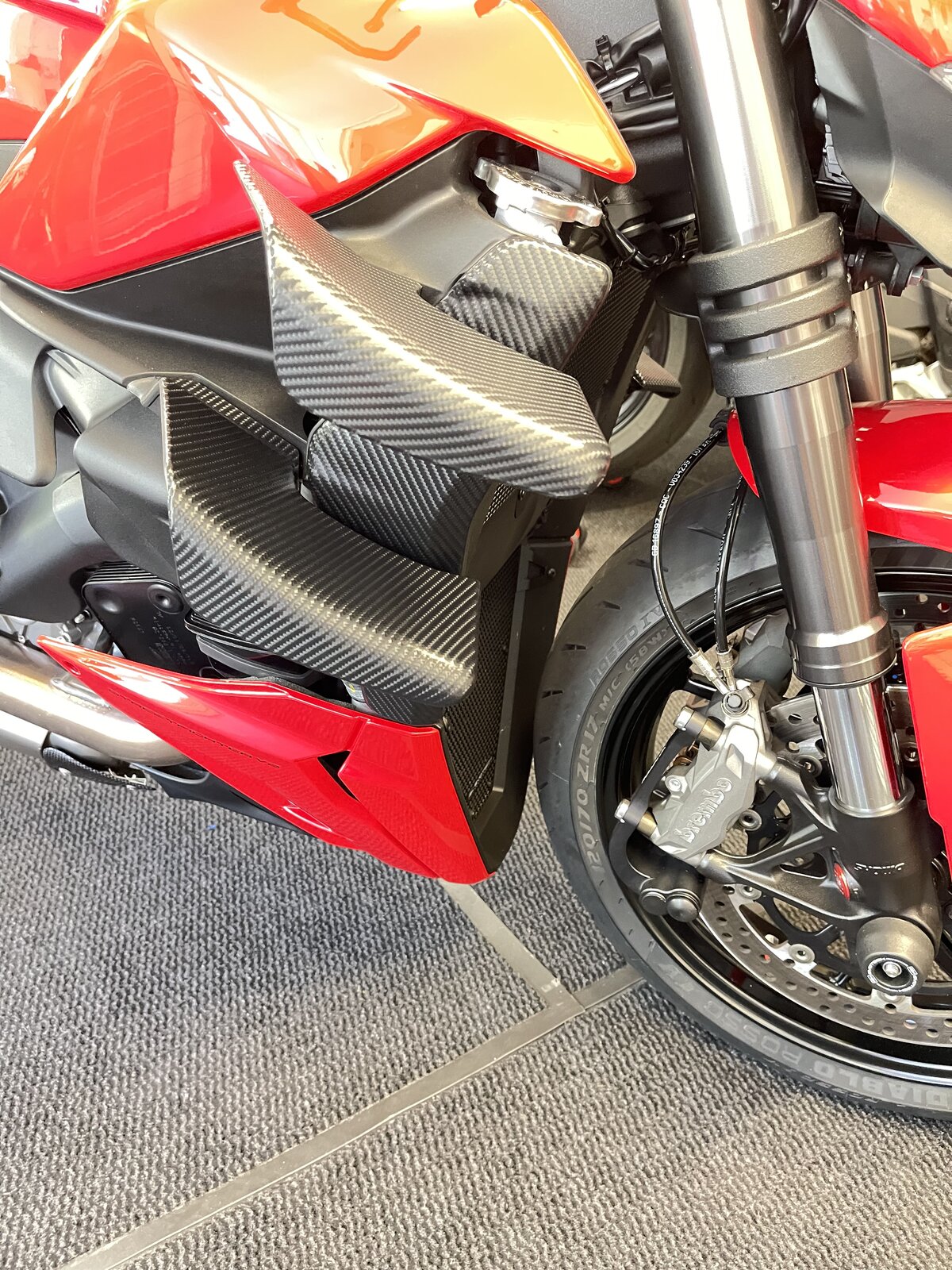

  15. Just got my wings & fins back from Evoboy
  16. He’s on here
