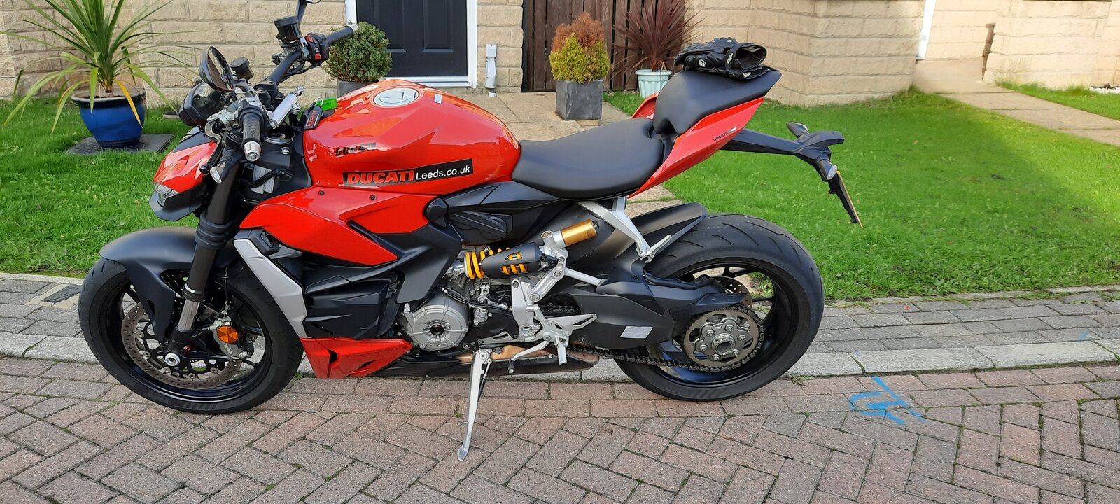

  11. Gritters have been out so essentially ended riding the new bike until next season (I got in 1 ride :sob:). So finding any other reason to play with the bike - first thing to do was remove some surplus items at the weekend. [​IMG]
    Getting the pegs out took a bit of effort. On removing the bolts, there was not enough clearance to slide them out, I thought i'd have to put them back on. I found a post somewhere for the panagale say the plastic heat-shield cover has some flex so managed to eventually get them out by pushing down on it with with fingers (to avoid scratches). It looks simple initially but you don't realise till you undo the bolt that there is a post sticking up that it needs to be lifted above to remove. I saw another video imply you could take them out rearwards while they're still joined-up, i found that impossible, I had to take out the small bolts and take them out side-ways. :joy:Here's a few pics in case anyone else wants a reference.
    Right hand peg removed, no spacer added yet:
    both pegs removed, these are the posts that the pegs must be lifted over:
    1 spacer added (71614961AA):
    cleaned and tightened up:
    The bolt-holes further to the rear are left open/exposed. I will likely get some 10mm M6 bolts to fill the holes when i'm next at screwfix.
    In comparison, removing the reflectors were much simpler. Remove the top bolt, add the spacer (71313641A), torque to 45Nm (confirmed with dealer) - remember to test brakes in 4 months when i eventually get out!

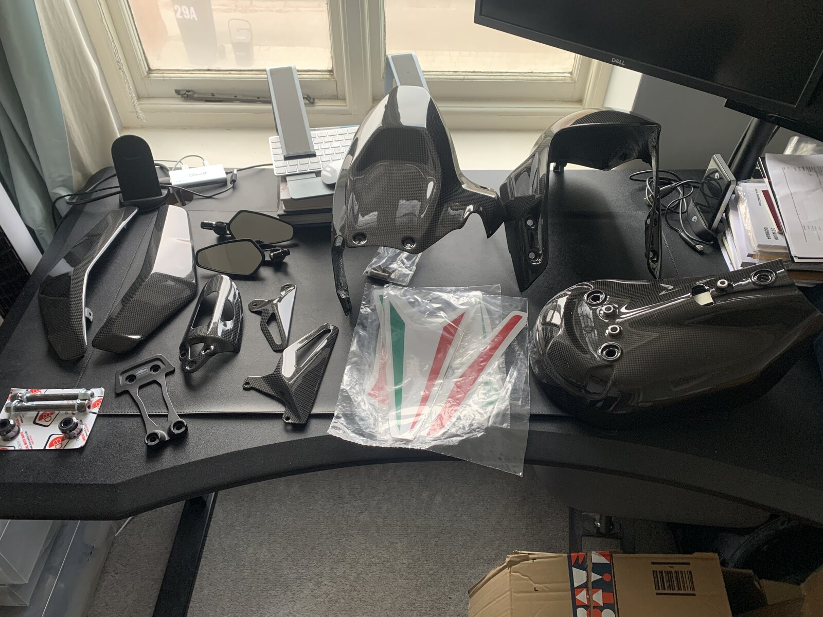

  20. All the goodies have arrived early, so far R&G fitted all round and Rizoma reservoirs. Now arrived are bar risers, loads of carbon and evotech blanking plate and carbon exhaust tip arriving this afternoon.
