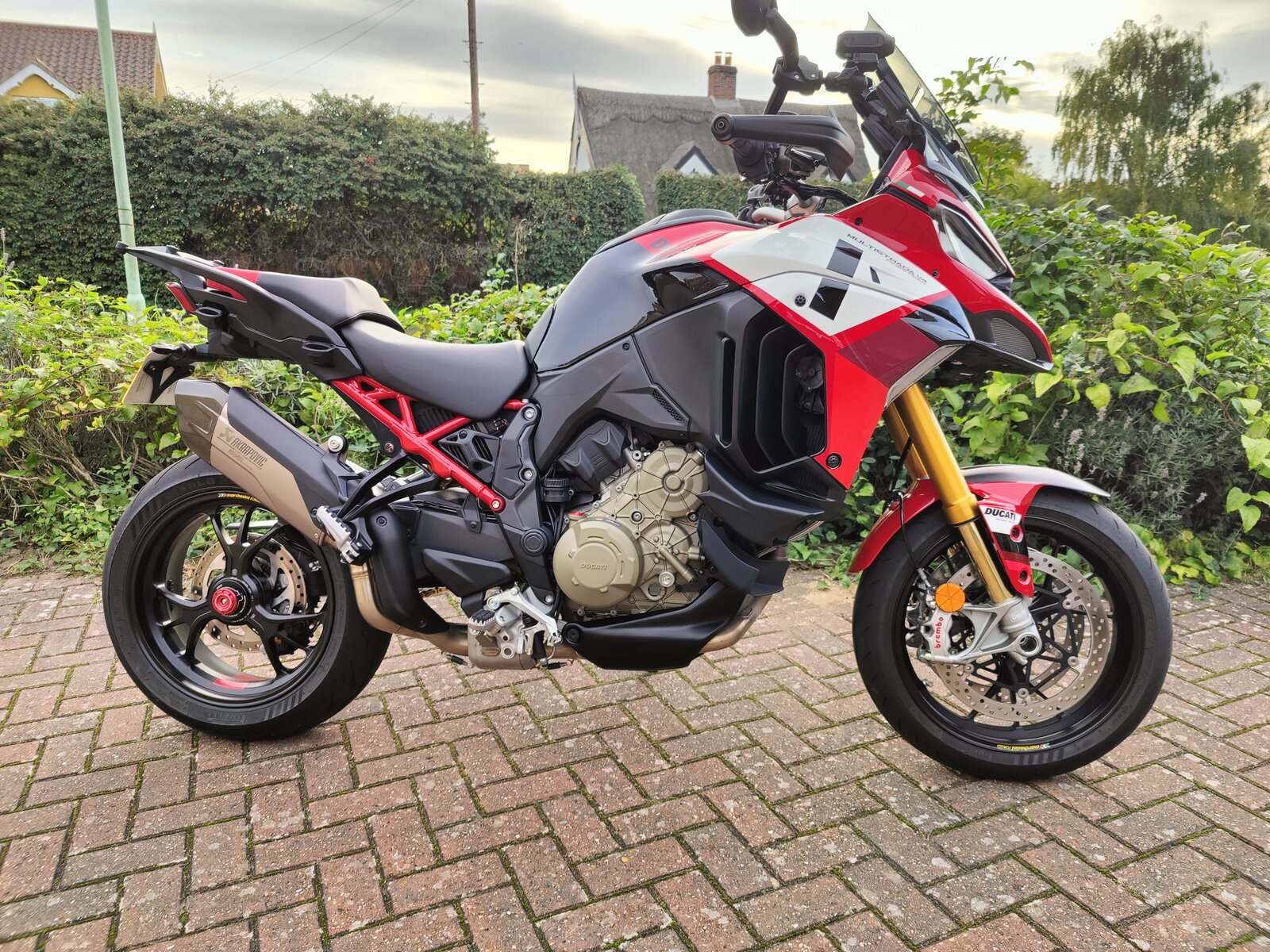

  9. I’ve got LSL gonia bar end mirrors fitted to my V4 as I think they suit the bike. Don’t stick out too much either :) upload_2023-10-12_17-49-8.jpeg

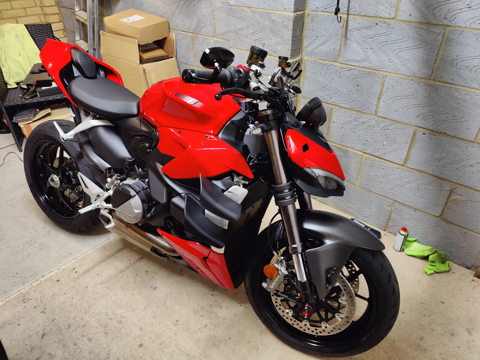

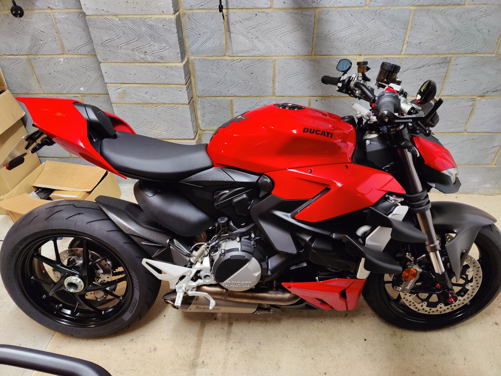

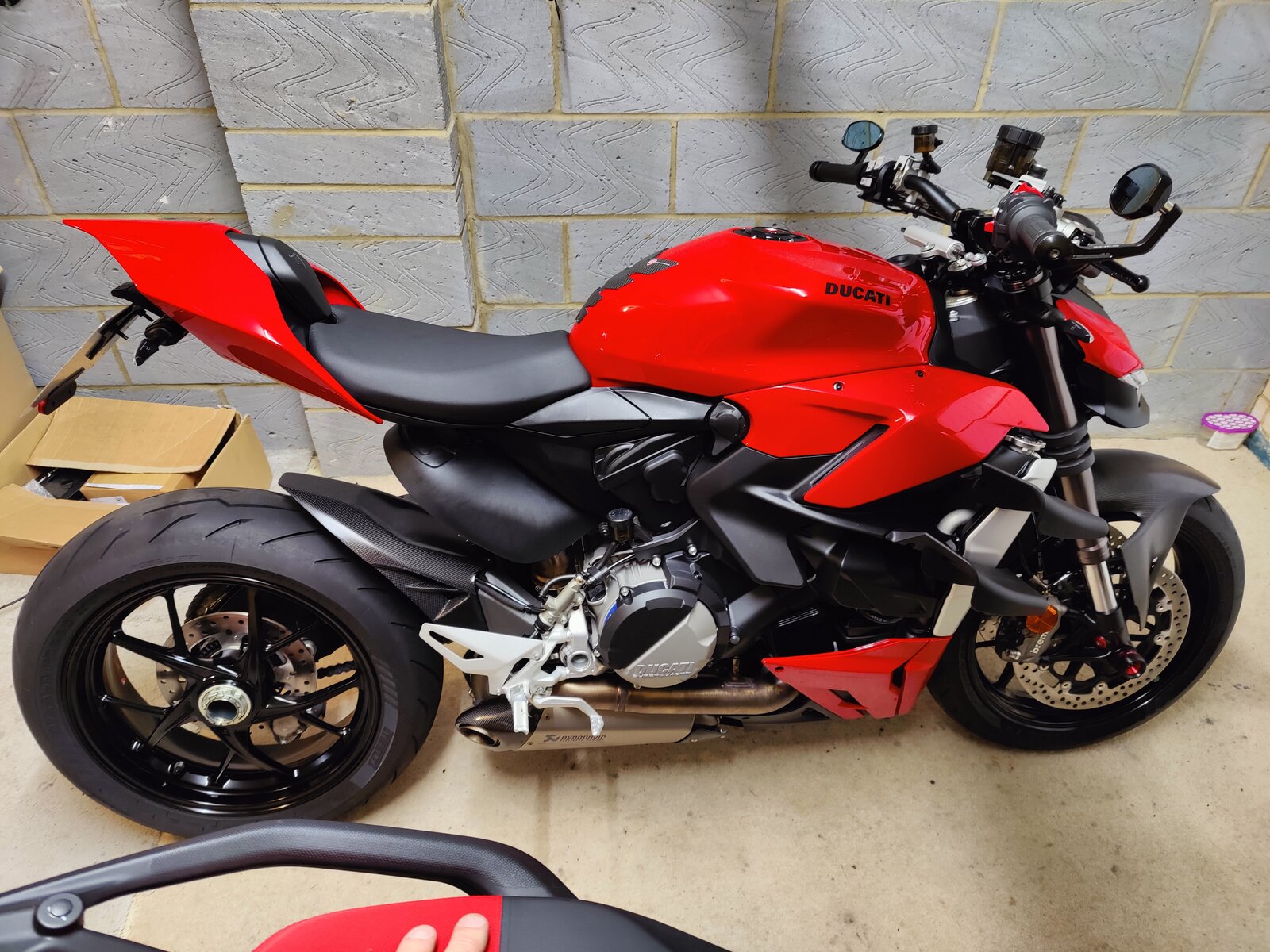

  11. Here is a couple of pics - not ridden it yet as its raining here - maybe Saturday I can take it out for a blast

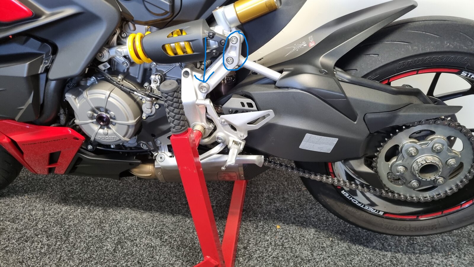

  16. Hi all, need help. I've recently had an issue with movement in one of the rear shock linkages. (see attached pic) It's the big one that the arrow is pointing to.
    The bike shop has just replaced the bush and there's still movement. If anyone has an abba stand or similar that takes all the weight off the rear wheel & shock, could you please check and see if there's any movement in yours.
    When the bike's up on the stand I stand behind the rear wheel and just gently lift the wheel up and down a bit and I can hear and feel the movement in the linkage. I doubt you'll be able to feel it with a stand that doesn't take all the weight off.

  17. I imagine in reality it's just the tolerancing. There will be room around each of the bolts that secure it, around the bushings, and also for the spherical bearing, so it'll add up to a little movement. If it's not there when the linkage is loaded and they've replaced the bushings then I wouldn't worry too much about it.
    • Useful Useful x 3
  18. Can now confirm it is 'normal' after checking a brand new one on the shop floor.
    They replaced mine because they thought the movement was over & above the factory tolerances. You can actually hear a knocking noise if you get it in the right spot with no weight on the wheel.
    I've owned plenty of bikes, including another Ducati, but never seen this before.
    Anyway, with this bike, all appears normal.
