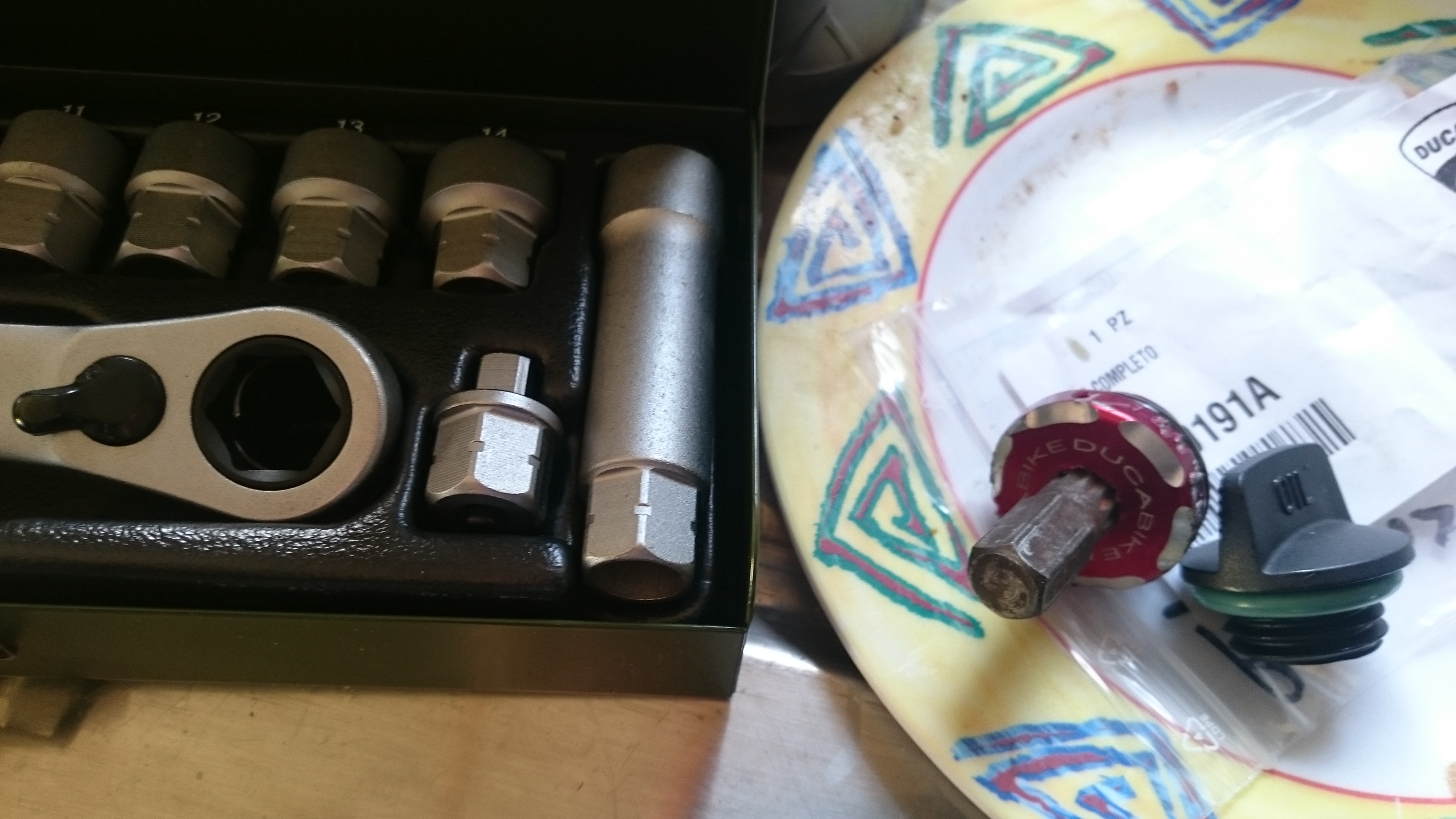

  5. Or get an old torx bit & knock it into the rounded part. Then carefully unwind the sucker free!
    Here's one I did earlier...now back to the original oil cap type!
