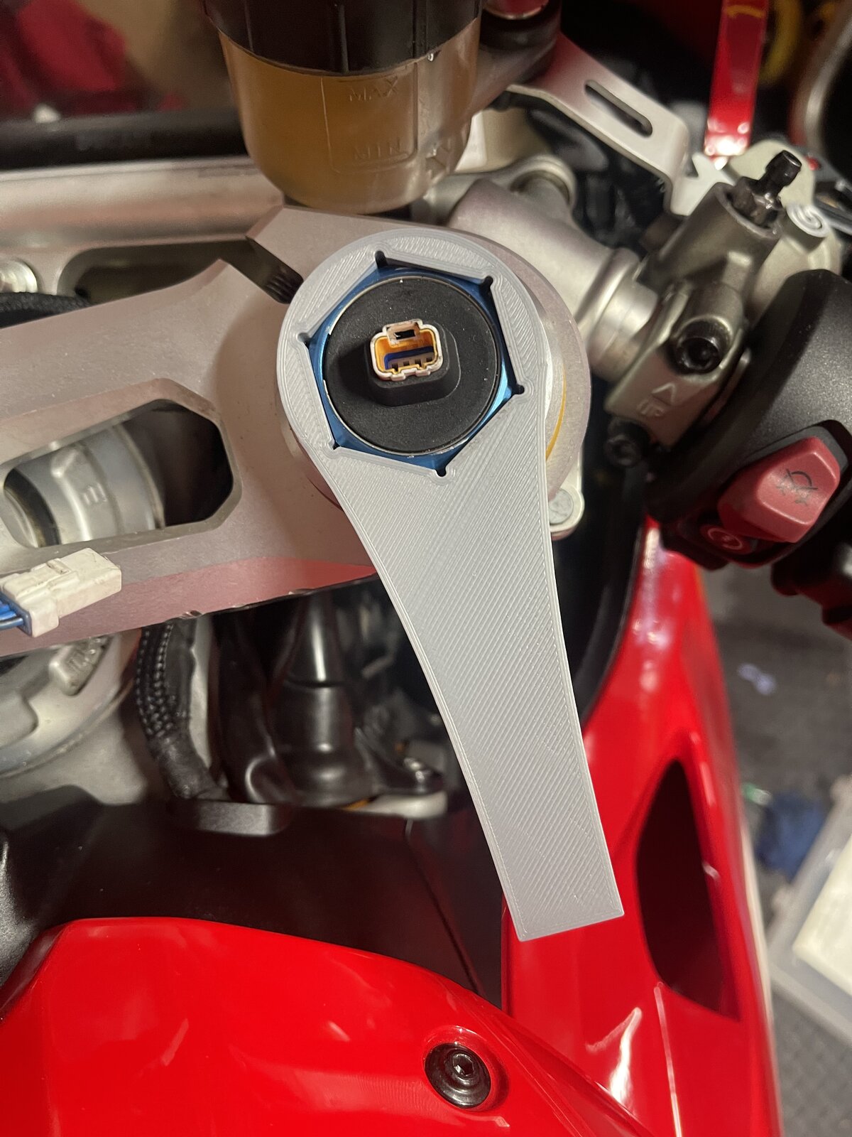

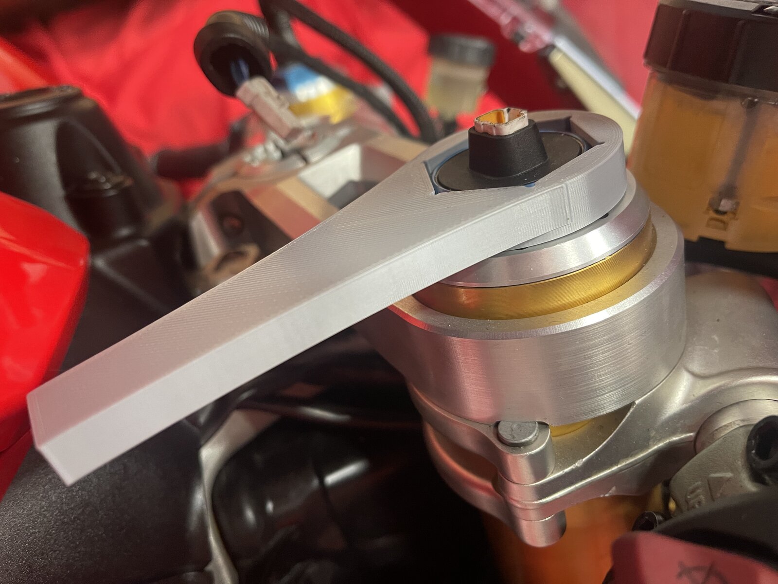

  4. Happy to print one out and see if it holds up. I’ll scan my V4S electric fork top tomorrow and see if I can make one, just in case anyone else needs one.
  5. I would love to have the schematics DRR117 to have one made at a mates with a 3D printer. Its a 32mm socket basically. Been looking for days online havent found anything.

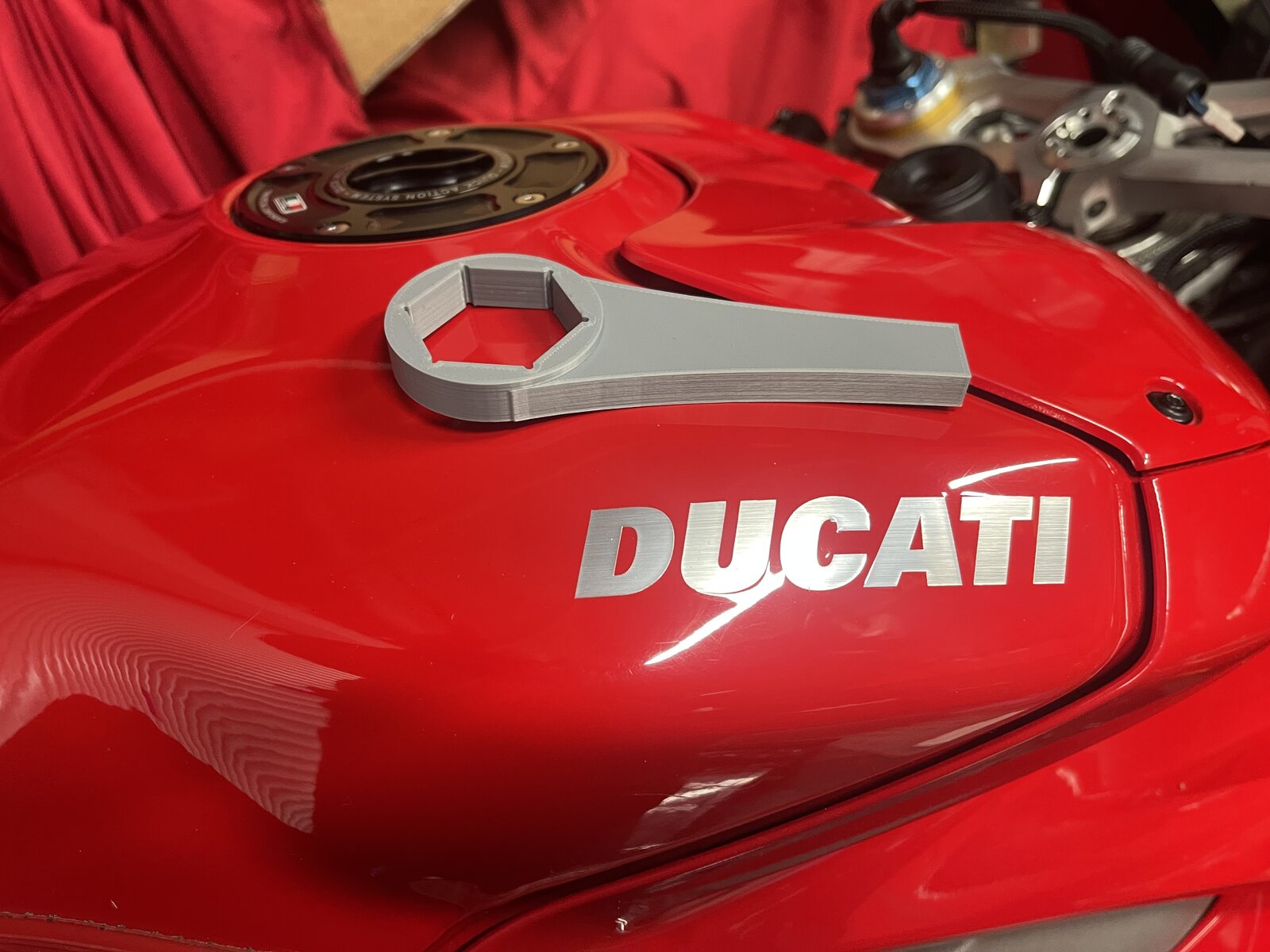

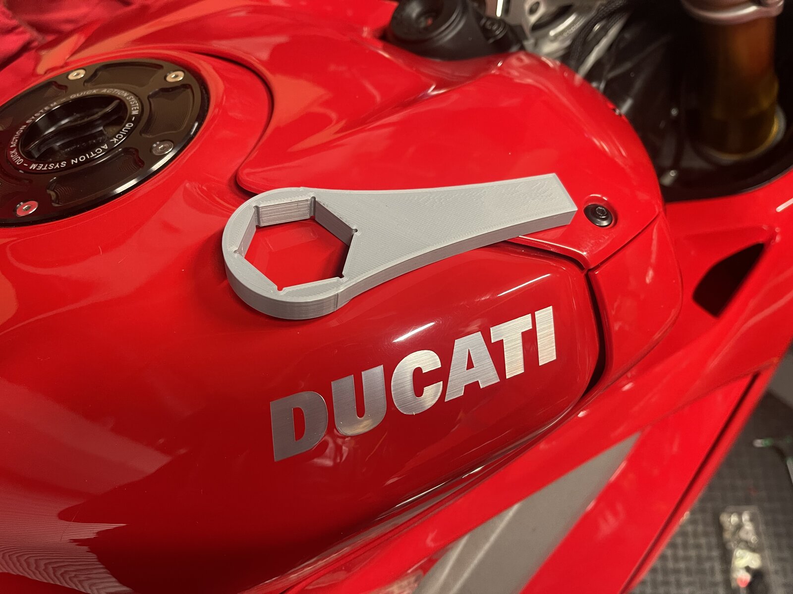

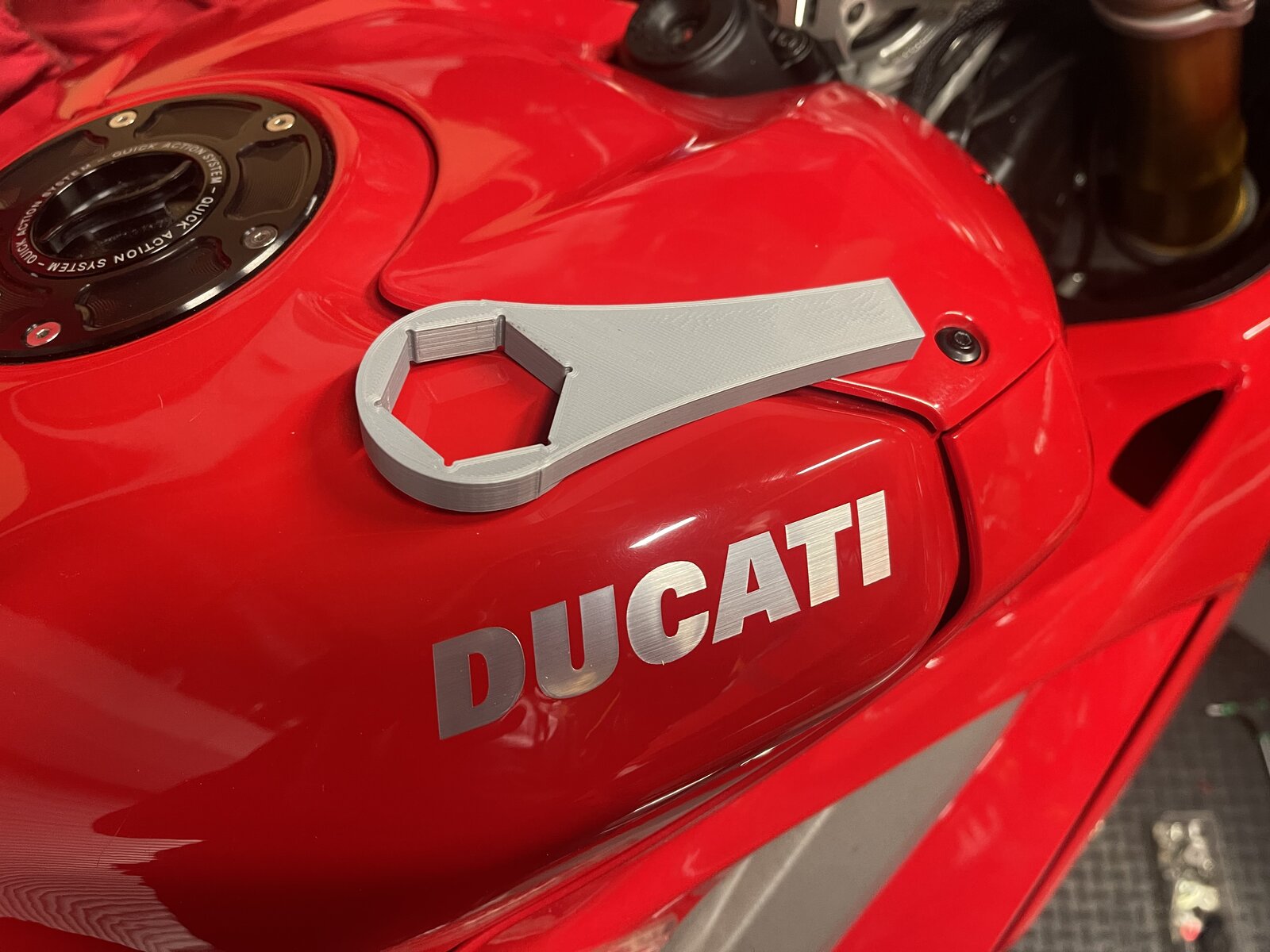

  9. not the most exotic looking of prints but does the job. Also have one for a 1/2” wrench printing aswell. It fits and turns the preload without disintegrated so that’s a start. Only 40% fill, just under 2 hours to print.
