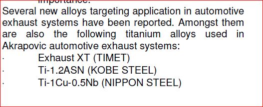

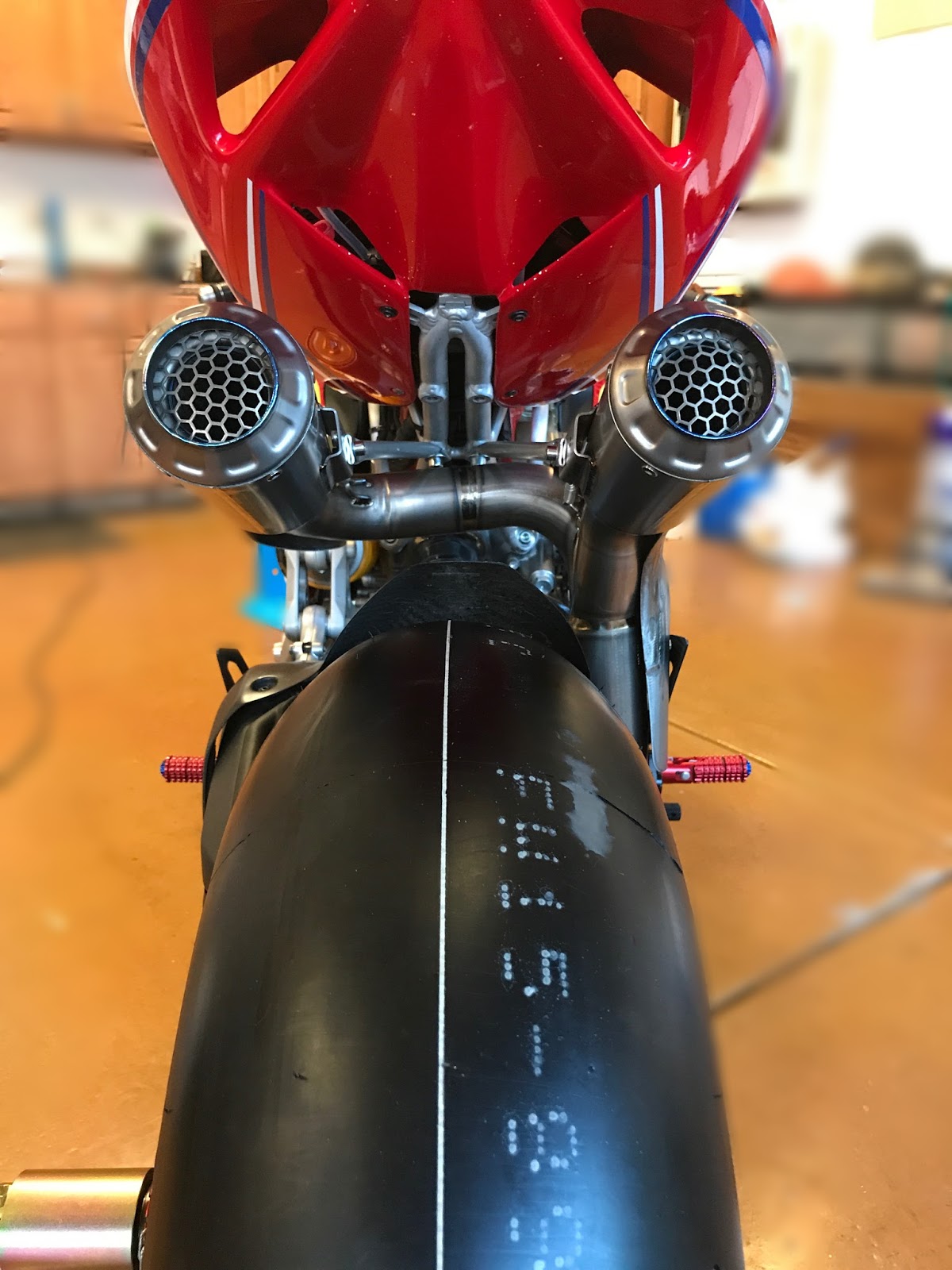

    I know they obviously not idiots from their care and attention, but Ducati, didn't; as far as I know didn't use titanium for the hot sections (headers), and I have seen some headers crack along the welds?
    very cheap price/ nicely made/ great value
    Ti-1CU-0.5Nib Nippon Steel
    #28 breakout998, Sep 27, 2017

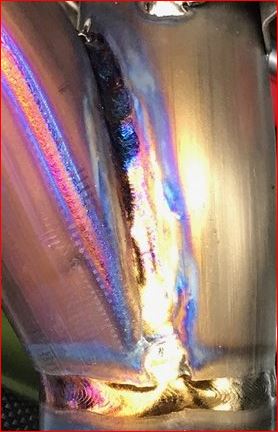

  9. not the outside matters; but what it looks inside? full penetration, no burn thro', and smooth for low turbulence
    look as good as Moto-corse
  10. combination of methods; all the lobster welds would be impossible to replicate manually start/finish is perfect and width penetration is perfect, but the two into one section in photo above is average on the weld edges and is done by hand, The machine welds also show perfectly even heat stain borders. the bottom horizontal weld is a combination machine butt weld finished by hand/eye. Horizontal hand welds appear to show some edge undercut; but believe me not many people can make pipes like this
    I think only; Akropovic or Motocorse, good value but think possibly too loud? So very good value
    #31 breakout998, Sep 27, 2017

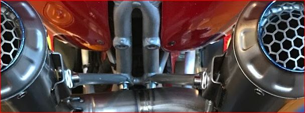

    I think the muffler mounts with cantilevered loads and bending moments at each end of the horizontal members, look like possible failure points. I think that idea is poor but wouldnt take much to improve look at photo, very poor idea
    Instead of two pieces needs one continuous beam that will go from the right to left muffler, then the bending loads at the ends next to the center bolts (inhex, allen) are turned into a bending load on the beam
    a beam folded with a U shaped section with end plates welded for the muffler conection, and the center bolts going vertically through the web of the beam and the two flanges providing the beam strength
    #32 breakout998, Sep 27, 2017
    God! Don't tell Mrs N but seeing this has made my little soldier stand to attention for the first time in many a year.....
  13. All valid points. Redline are keen to point out that this is still a product that can and is being further developed and with that in mind, why not email them with any reservations or observations you have, as they are not averse to feedback it seems. They are pretty quick to respond. More importantly, post up any replies you receive, as I have done.

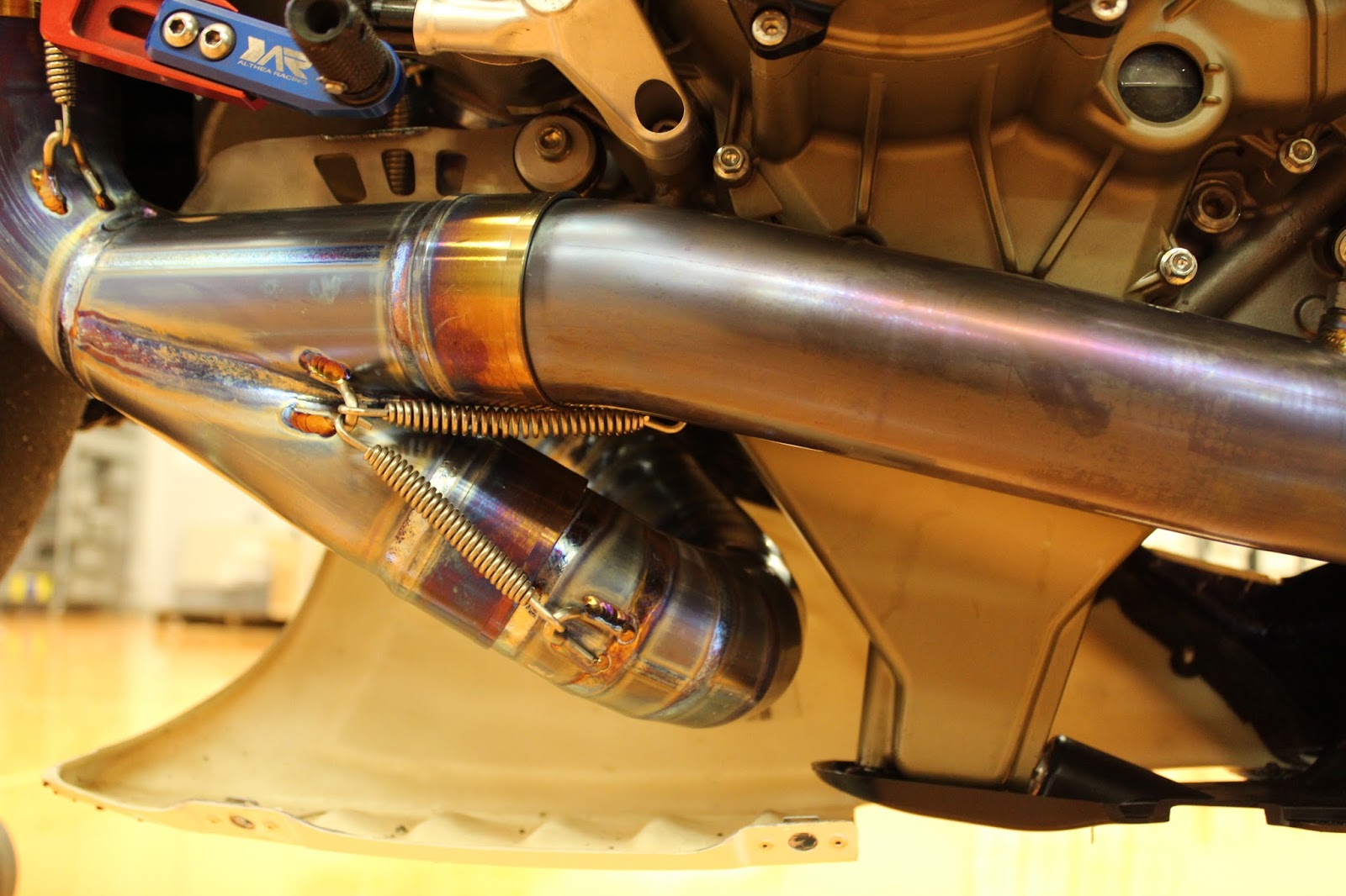

  15. I note in one of the photos the lobsters look a little 'long' which makes the curve less smooth, more construction from straight pieces.
    But I am only nit picking? for its price I can say I have never seen better

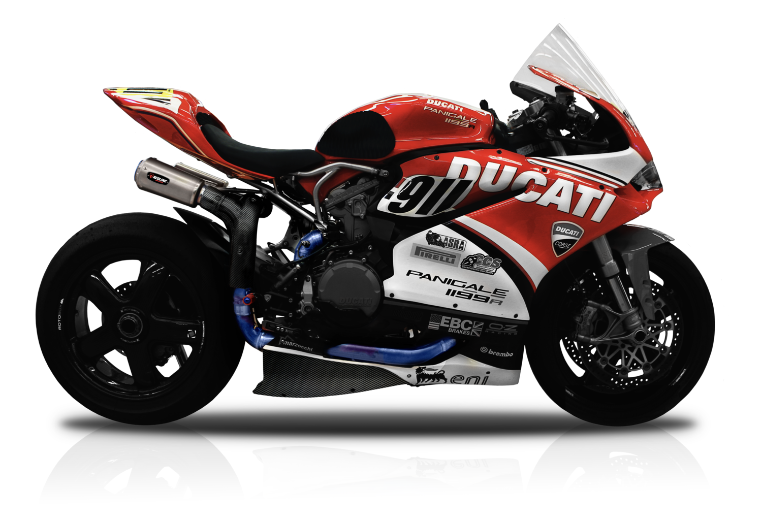

  16. I've emailed them again Sev with a link to this thread. Hoping they will chip in directly to answer any of our questions/concerns. They are apparently on iteration 7 and have 1.5k miles on it so not sure if this is a testament to the headers standing up to the heat/vibration or not. My only other reservation aside from any already raised on here is the bellypan, which for me is a little too bulbous. I'd like to see something more streamlined (as per the one used with the 1299SL full system when fitted). More like this (see pic below), though it might be too close to the pipes for heat being a shallower design.
  17. Sev, I've had this back from redline regards some points raised and the Ti headers. I do know that the headers are Ti moulded, so not sure if they mean the flanges (which would resumably then be machined) and then I assume the header section then welded to them.
    "The current belly pan will not be inline with the bottom, we did put a little shark fin in it. Not so much for depth, but for cool.
    We will be making two versions:
    1. Street use, so use with a kick stand.
    2. Track use: smooth and no kickstand hole.
    For the RH heel guard, effectively the RH carbon fiber part IS the heel guard. We were giving some thought of providing a mini one...but there haven't been any requests.
    Headers are full Ti Annealed and reinforced with some beefy welding. Thus far, we have heat cycled and raced the dickens out of the system. Other than performing well, no issues. To this end, we'll go so far as to 100% guarantee these headers for a year (barring crashes etc).
    If cracking were an issue for Ti and heat, why are basically every other bike header made from Ti????? We saw this as either an Akrapovic design flaw and/or an excuse to cut costs.
    Last, the pesky mounts...they are aluminum tubing. We are probably going to carbon fiber for this release in November."
