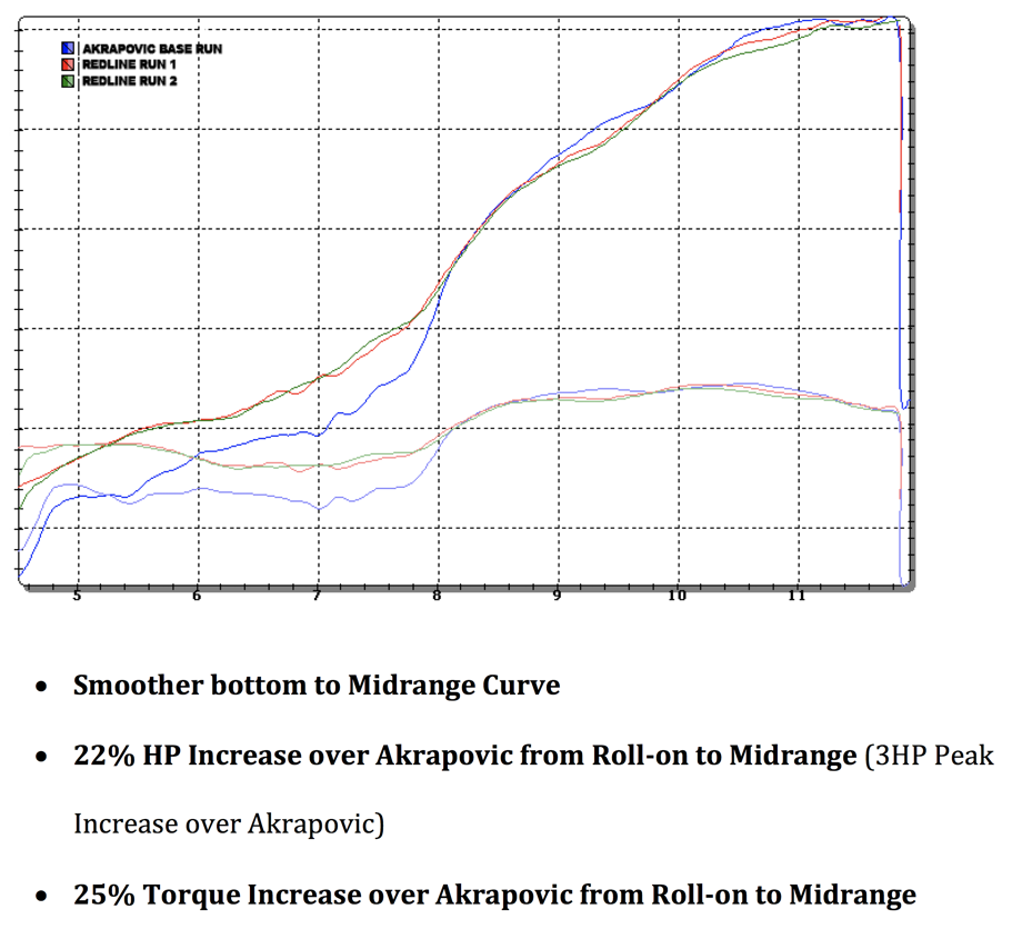

  3. Our Dyno data is in! We have compared an Akrapovic full titanium system vs our own. We even won two national championships over the weekend with our system. The numbers don't lie and neither do the results
  4. OK so your actual rear wheel max measured bhp figure and max torque figure were what? Your chart shows no info other than the increase, but you are going to have to publish some numbers ultimately. There are plenty of stats on the full Akra system for us to then compare your system to. Also do you have the Db figures yet, since these will dictate for many UK riders if they can even contemplate this system for UK trackdays. Lastly how are you coming along with the redesigned bellypan and the exhaust Db killers (baffles)?
  5. The stock numbers peaked at 177. This is with the Akrapovic system. The Redline system peaked at 180hp.
    We got our dB done, at half RPM from redline was 108dB. UK racers will likely need baffles which we do not have a date on yet but before the end of this year.

  16. Still dodging the numbers and I've not seen an actual belly pan yet....... no one else not notice the fact that the carbon belly pan on their website is a photoshop?
  17. Was this number the one your looking for? or asking about DB? or the weight of exhaust? I believe the weight is 10LB and as for DB even tho its not 100% I think its 107DB at 5000RMP at 45 deg at 10 feet which is odd. For DB killers still waiting for final answer. Hope this helps Cheers!
  18. With all due respect they don't have any numbers on the Dyno print out. Most Dynos I've dealt with all do, in fact you have to go into settings and manually remove the numbers from the display graph. I'm sorry, but if you go to a Dyno to prove a point and sell a product, you don't then go out of your way to delete said figures. As it stands it's still only someones word who's trying to sell a product!
    As you just pointed out, no reliable sound testing either.
    And the belly pans don't exist, just a photoshop!
    I really want this to be a good product, I would love to have it. I just have concerns over the whole thing......... it stinks if you ask me
  19. I'm on the case Mutt. About to fire off an email to them asking them to post up a chart with figures intact plus some official paperwork to support the Db readings. Else, as you say, it is all just hearsay. I too would be interested in this system but a lot rides on their credibility and if tomorrows unveiling of the V4 doesn't have me reaching for my cheque book.
