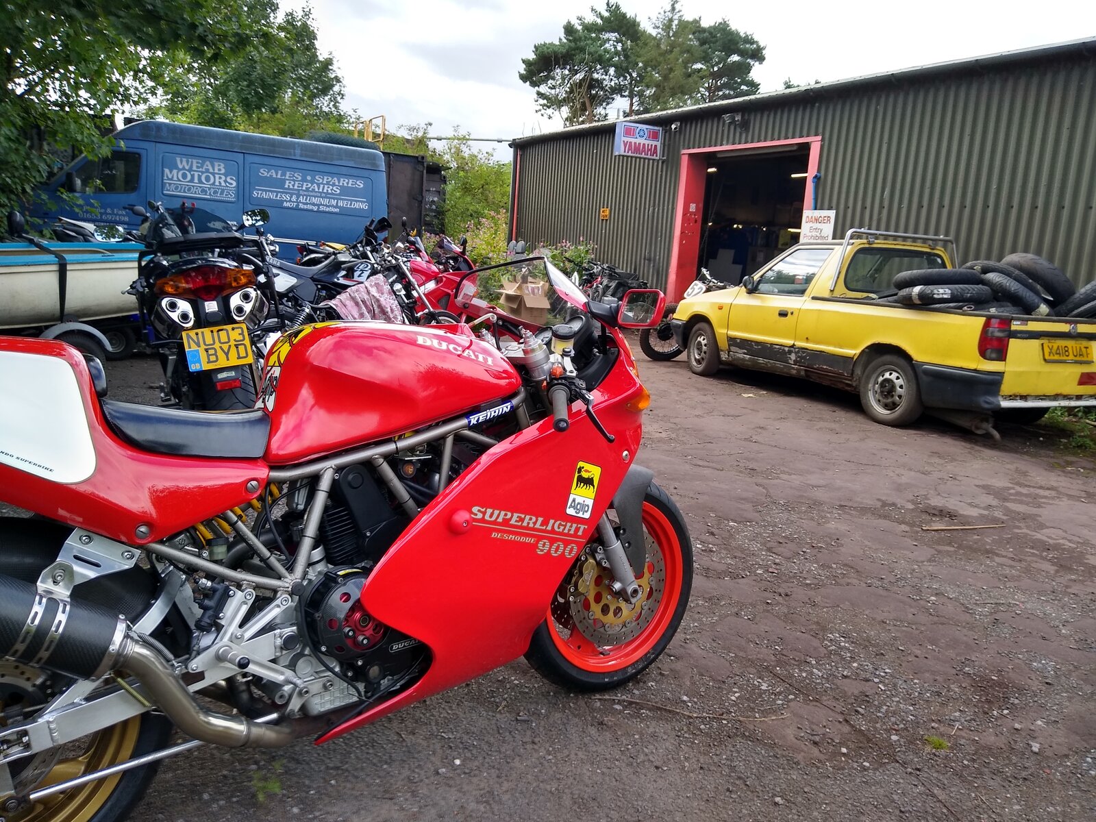

  16. MOT passed this morning with a couple of advisories as I expected, but what I didn't expect was a strange rattle from the back wheel. On closer inspection a steel bush from the centre of one of the cush drive rubbers had dropped out, but more worrying is that one of the pins has also snapped! I'm going to order a used sprocket carrier to salvage the pins from, and I'm hoping I can glue the steel bush back in for the time being until I get the wheels powder coated, when I'll fit new rubbers.
    It was an eventful ride afterwards, where I lost bolts out if the seat unit (dammit) and also the hugger, but more worrying is that I noticed the swinging arm pivot bolt trying to make an exit! o_O
    The clamps were tight but luckily I'd taken a few tools so I could push it back in, but I'll have a better look at it.
    There's a good 39t sprocket in the box of bits that I got with it so I'll throw that on to replace the existing 37t whilst I have the wheel out.
    The chassis is lovely, although the Harris clip-ons are not good on my arthritis at slow speeds. It feels a lot like my sorted KR-1, just a little bigger. :upyeah:
    I need to do a bit of work on the jetting as the power seems to stop dead at 7k (FCR41s on what I believe to be a stock motor and ignition, jetted as they came from Sudco), and the tickover is lumpy but I've just ordered some 52 pilots.
    Maybe I'm just used to the Katana and my Z1000....
    I need to do the belts but I'll triple-check the cam timing, just in case. Who is the go-to for belts etc.?
    I did say I wanted a project! ;)
  17. Oh, I forgot to mention. My MOT man has Superlight MkIV no.333 in for some work. :):upyeah:
