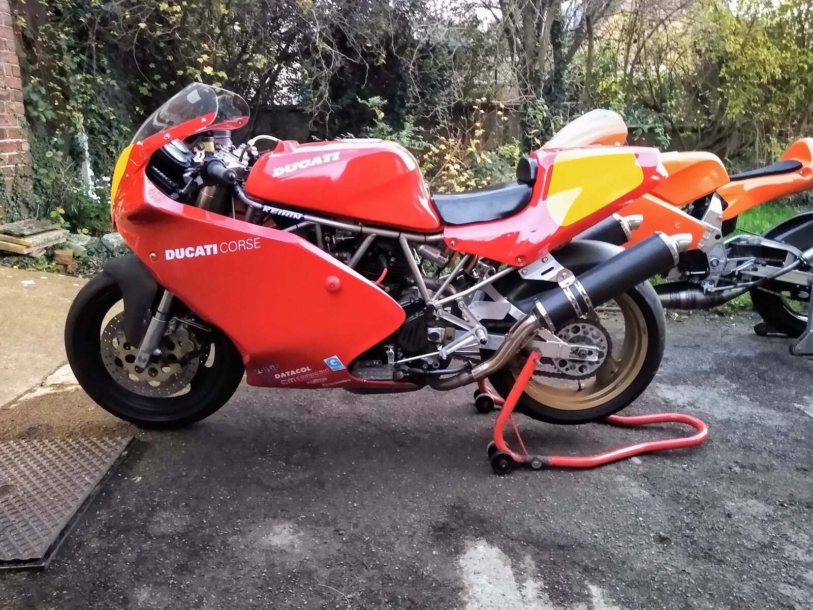

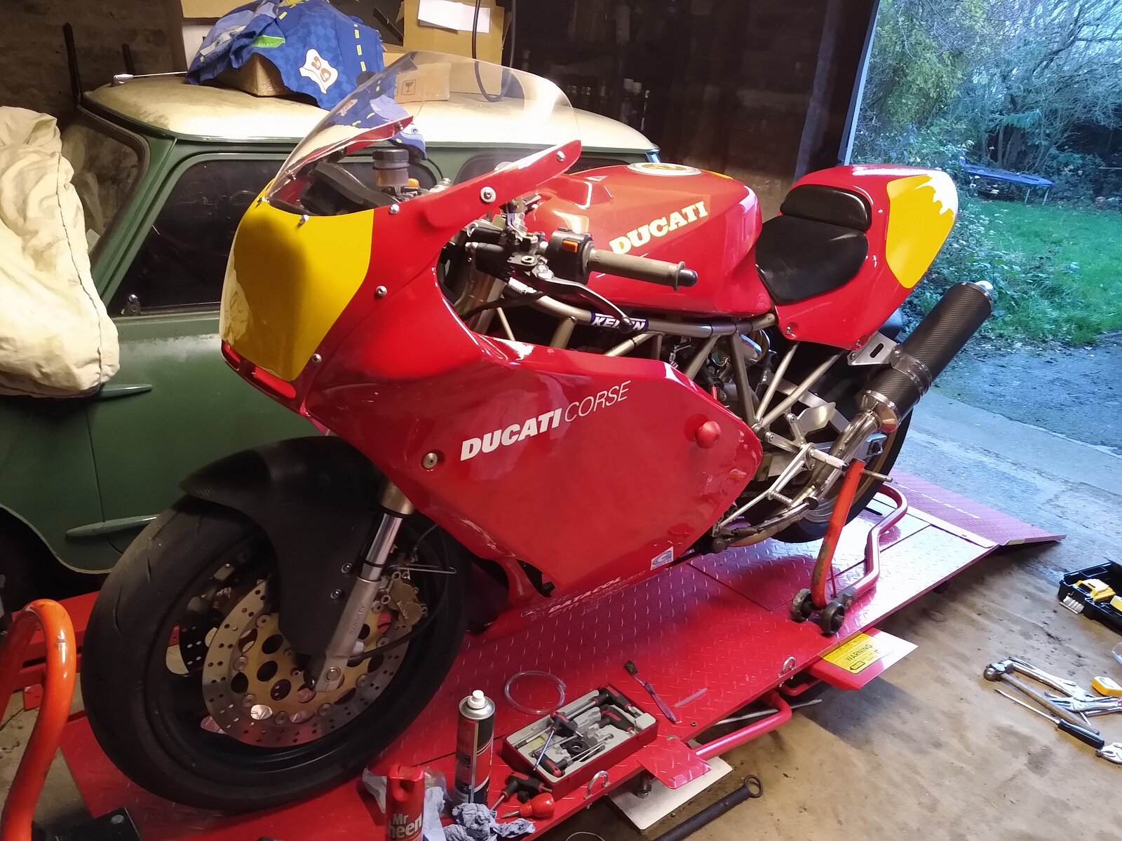

    Anyway, in between lockdowns I picked up a nice set of pattern bodywork for the SL from a forum inmate, where it's been sat on a shelf until this week. But on Friday I finally got around to fitting it, and I'm a very happy man. Thanks again, you know who you are... :):upyeah:
    Roll on Spring, and hopefully the restarting of classic track days!
