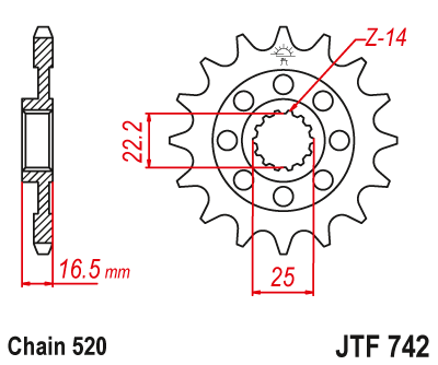

  3. At just shy of 10,000 miles the gearbox sprocket on my bike is showing signs of wear with the teeth beginning to look a little hooked, not surprising since it turns about twice as quick as the rear. The chain and rear sprocket are still good so I decided just to replace the front one and while I was doing so to try out a 14t.
    In looking for a replacement I ended up having an interesting email conversation with Chaz at B&C Express. It appears that the JT sprocket (JTF742) is wrong for the Supersport with an incorrect offset moving the sprocket centre outwards by 1.85mm. The same sprocket had been offered by JT Sprockets as a 520 conversion for the 1098 which is when this error was discovered.
    The Renthal 433-520-14 (or-15 for the 15t version) is correct for our bikes. If you have fitted a JT sprocket the chainline is out. I don't know the situation for the Esjot sprockets.
  4. Absolute rubbish...my dealership fitted me a 14JT front cog & there is No problem at all & my chain is spot on & not out at all...So go back to your drawing board & play some more.

  5. Fair enough. Not my drawing board. This was the information provided by B&C Express who are generally well regarded as a supplier of chains and sprockets and don't usually get their facts wrong. I now have the Renthal sprocket and it conforms with their drawing. It is very possible that the JT Sprockets drawing is wrong but their sprocket is correct. Maybe someone with a JT sprocket can compare it with JT's drawing.
    I will also suggest that over the length of the chain, something like 70cm between centres, side to side play between the sprocket teeth and the chain links could allow for seemingly perfect alignment. The clue would be wear on one side of the rear sprockets and the opposite side of the front sprocket.

  7. B&C Express are not a rival company. They supply both Renthal and JT sprockets and others.
    This is from their emails when I enquired about a sprocket:
    Thank you for your enquiry.
    I have looked at the listings for the 939 Supersport front sprockets and
    have to say that currently we cannot offer to supply one to you.
    Looking at the JT sprocket listing, they claim a JTF742.15 is the correct
    item.
    On further investigation, I have found that the JTF742 front sprocket is
    also listed as the 520 race conversion for the Ducati 1098.
    This allowed me to then look at the Renthal listing for the 520 race
    The sprocket that Renthal produce is different to the sprocket that JT
    produce.
    I know that the Renthal front sprocket produced for the 520 race conversion
    for the 1098 Ducati is correct. This means that the sprocket JT list is
    incorrect.
    It also means that I am unable to trust the JT listing for the 939
    Supersport.
    I hope my lengthy explanation is clear enough.
    If not, please get back to me.
    Regards,
    Chaz
    Sales Dept
    B&C Express Ltd
    And also:
    The problem that I have come across is the JTF742 is not the same sprocket as the Renthal 433-520
    So if we look at a known Renthal listing, namely the 520 race conversion for the 1098, then I am seeing a conflict.
    I have no doubt that the information I was given was supplied in good faith and as far as B&C can see there is a conflict in the information provided by the 2 suppliers. In their experience the fitment provided by Renthal has proven to be correct and understandably they did not want to sell me a sprocket which may not be 100% right.
  8. The 1098, Multistrada and Diavel have the same offset and uses carrier PCD-3
    The Panigale 1199~V4, Monster 1200 and 939 Supersport have the same offset and uses carrier PCD-4
    These carriers can accommodate 520, 525 and 530 chain width. Front sprocket must match of course.

    I haven't yet swapped over the sprockets as I've had plenty else to keep me busy but when I do I will be comparing measurements between the OEM and Renthal sprockets. It would be useful if someone else could do the the same with a JT sprocket.
