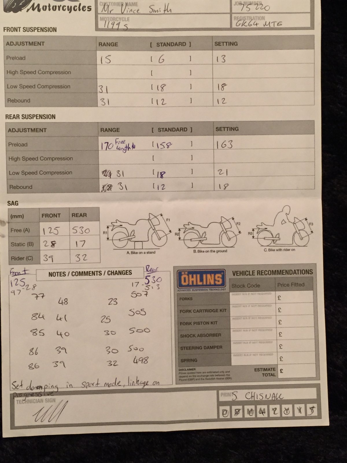

  8. That is what I am trying to sort out, front feels fine and stable its the bloody rear but in all honesty I have not had a chance to play with Comp n Rebound since going back to F setting.
  9. What are your current settings for
    Forks preload / comp / reb
    Schock preload / comp / reb
    Track or road ? Average quality of roads ..
    The pani is very sensitive to small changes .
    The springs are chosen by weight and speed . The heavier and faster the rider , the heavier the springs . The springs should be able to function well with 4 to 6 mm preload at the front .
    With the right springs R and c should do the job from -3 to + 3 .
    Anything more will make the suspension nervous as dive and bouncing back will accelerate..
  10. My paperwork for suspension setup.
    Only difference is linkage now set to F

    I reduced the spring to an 80 and changed to p setting and the sag was checked and adjusted. I have now changed to the F setting but to be honest I need to check the sag settings on the bike before I go any further with changing compression and rebound settings
