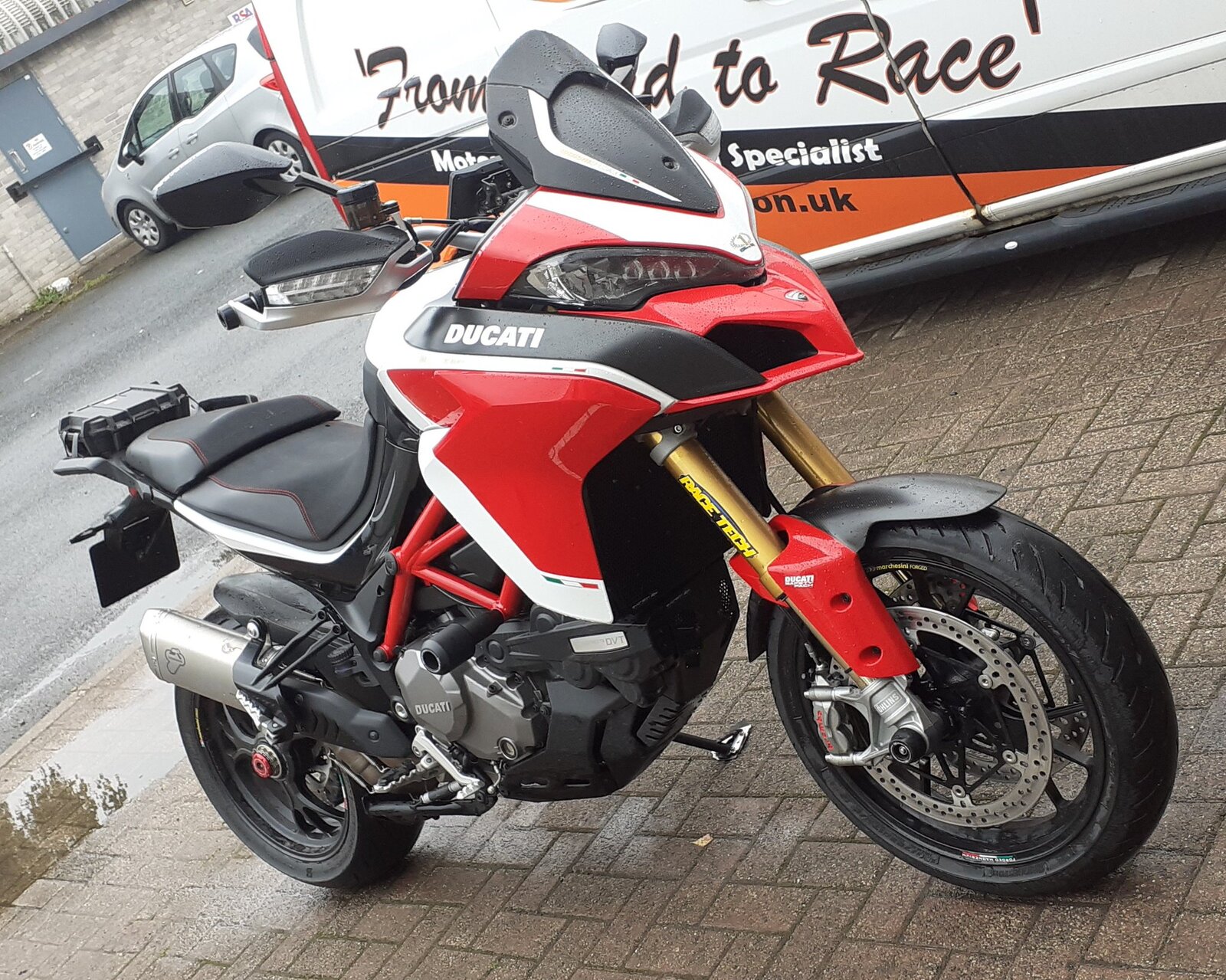

    200 miles after setup - very happy and impressed. It’s the bike it should be. About time dealers set them up properly before you leave after purchase, mine was a joke, dove under braking, way to soft and hopeless steering compared to now :imp:
  7. Mine is the opposite...its Very hard, especially at the rear, if I go over a bump it goes right through you...having said that its an amazing bike (as I can see from your photo you are enjoying too) so I’d be happy to spend £50 and make it even better :)

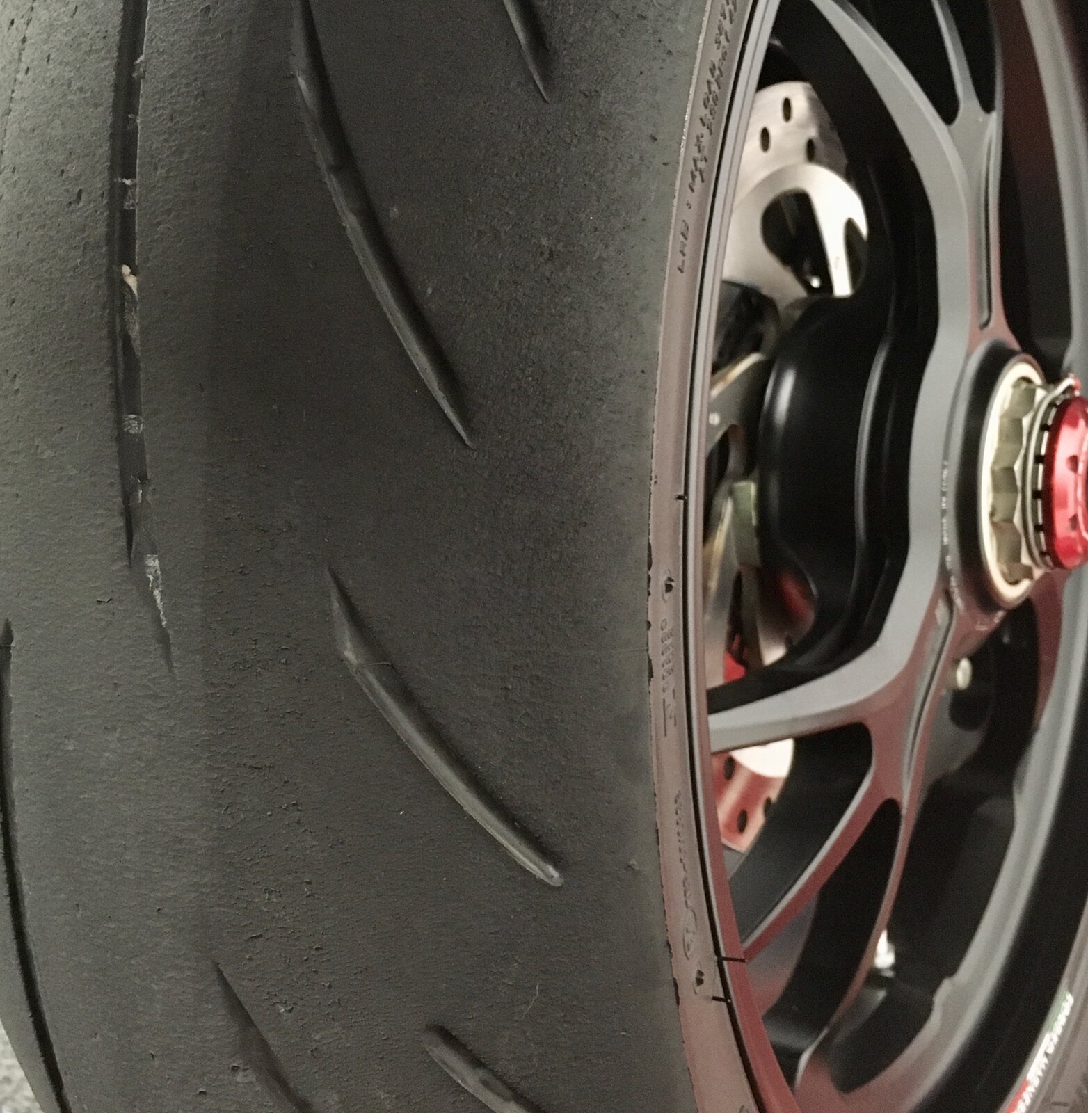

  8. With more practice you'll be able to get closet to the edge of that tire

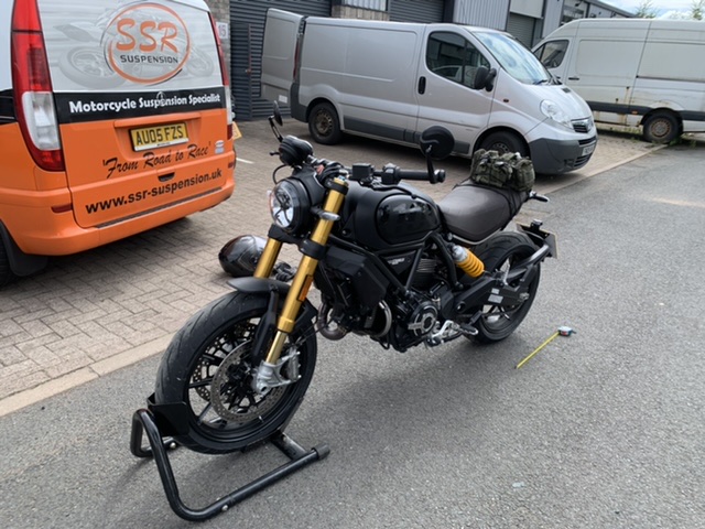

  9. Took my Scrambler 1100 Pro Sport down to him today, top service and it’s gone from good, to excellent. I’d highly recommend the service. Plus the road back out towards Shrewsbury was awesome!

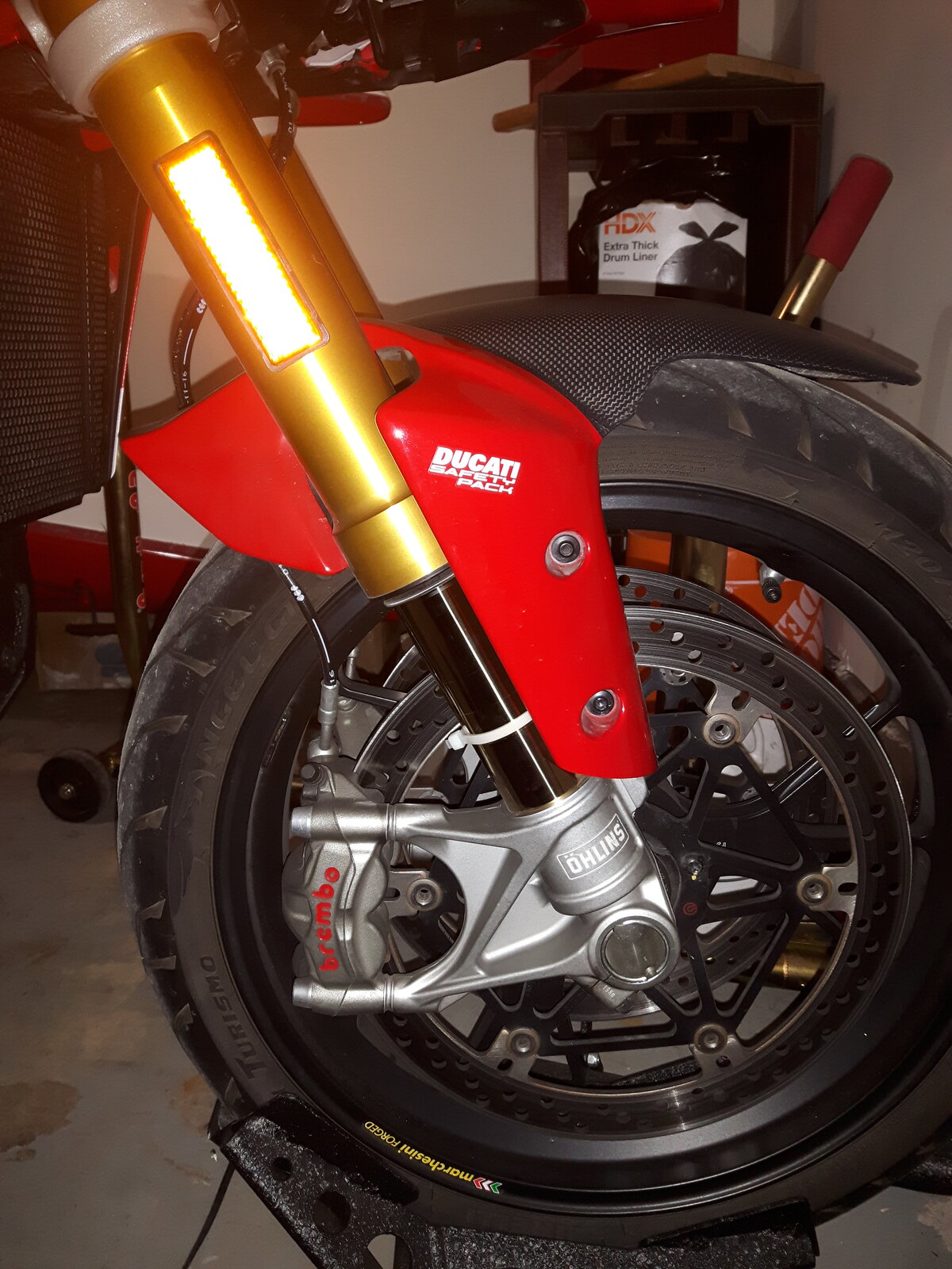

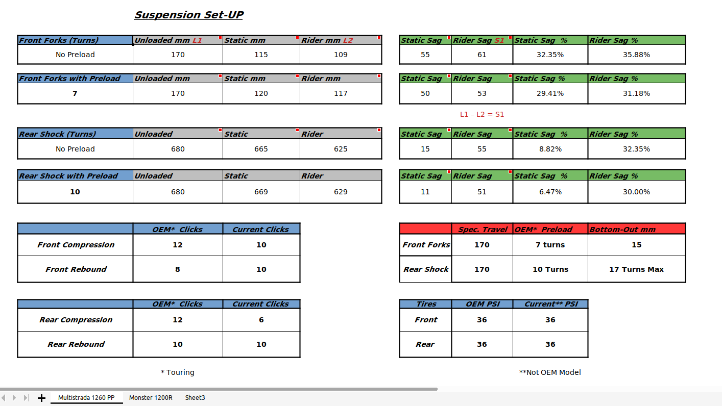

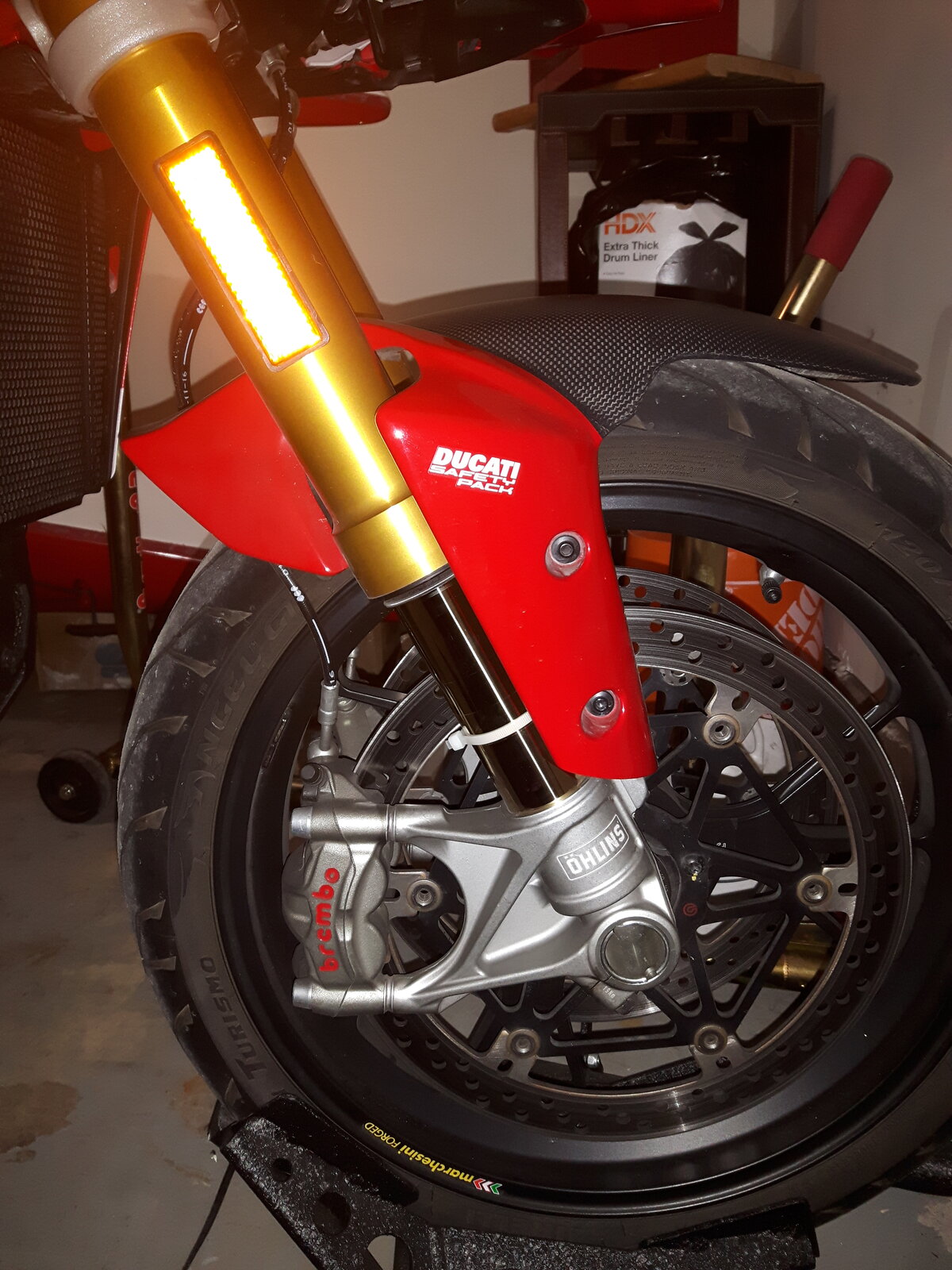

  10. Here's the suspension set-up I currently have on a 1260 Pikes Peak with manual Ohlins which at 18,000 Kms, is slightly more than half-way to a fork and shock service.
    FYI: I'm 177 lbs / 80 Kg in full leather gear (160 lbs / 72.5 Kg without). No pillion, All twisty back roads. Riding on Angel GT.
    I'm very pleased with this set-up so far although it's not perfect as the front static percentage is higher than textbook :confused:. However, the Rider SAG percentages and the fore-aft balance are already near spot-on which is more important. I'm using 10 turns on the rear preload. Eight is bang-on but I prefer it at 10 with a slight forward pitch. I'm using 3/4 of the fork travel measured to the bottom-out mark above the fork casting while riding on smooth roads without pushing it. In an emergency stop, my zip-tie drops to just above the bottom-out mark.
    It's also important that I remember that some of these settings should be reviewed every 3000 miles or so as the oil's viscosity deteriorates.
    Consequently, I consider suspension set-up as a journey, not a destination. I will also be tweaking the compression and rebound settings to see what's best given a particular riding scenario. Keeping a record of these settings is an essential step in this journey.
