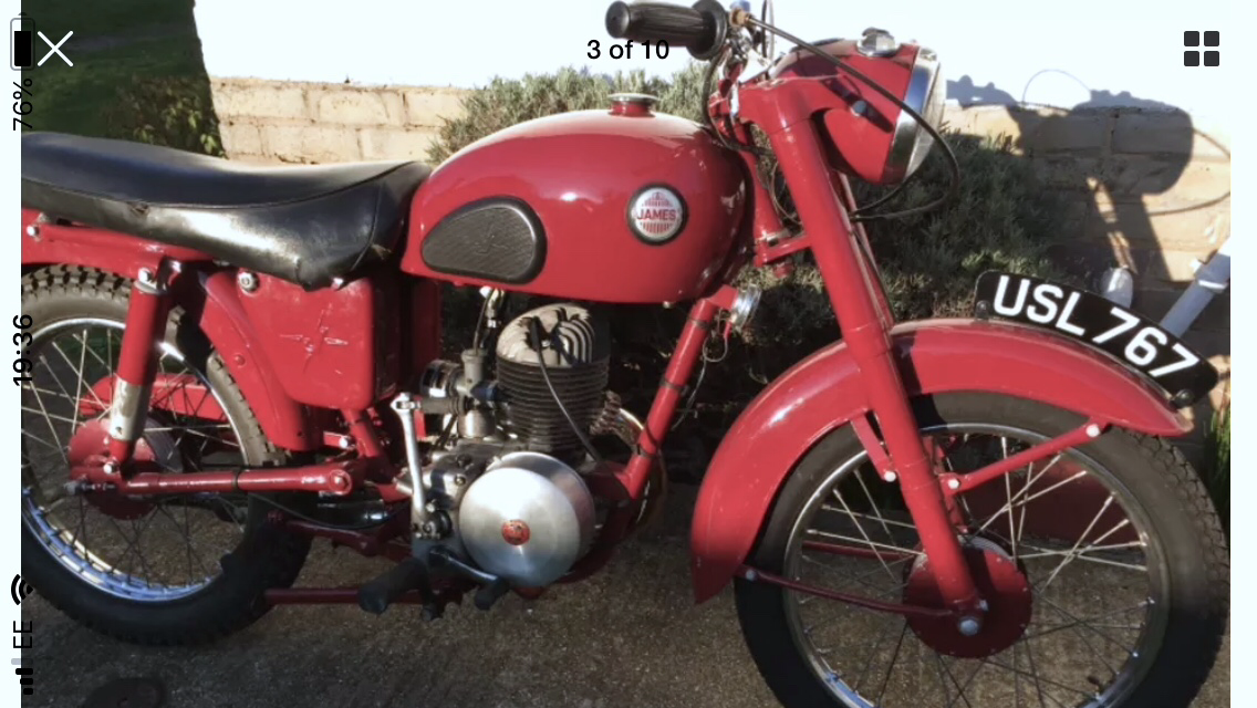

    these are they, any excuse to show a photo! 35BB8C45-B23B-4C69-8680-FB5E3A6284EB.jpeg F5113F62-2089-41EE-8860-3C488450E75E.png

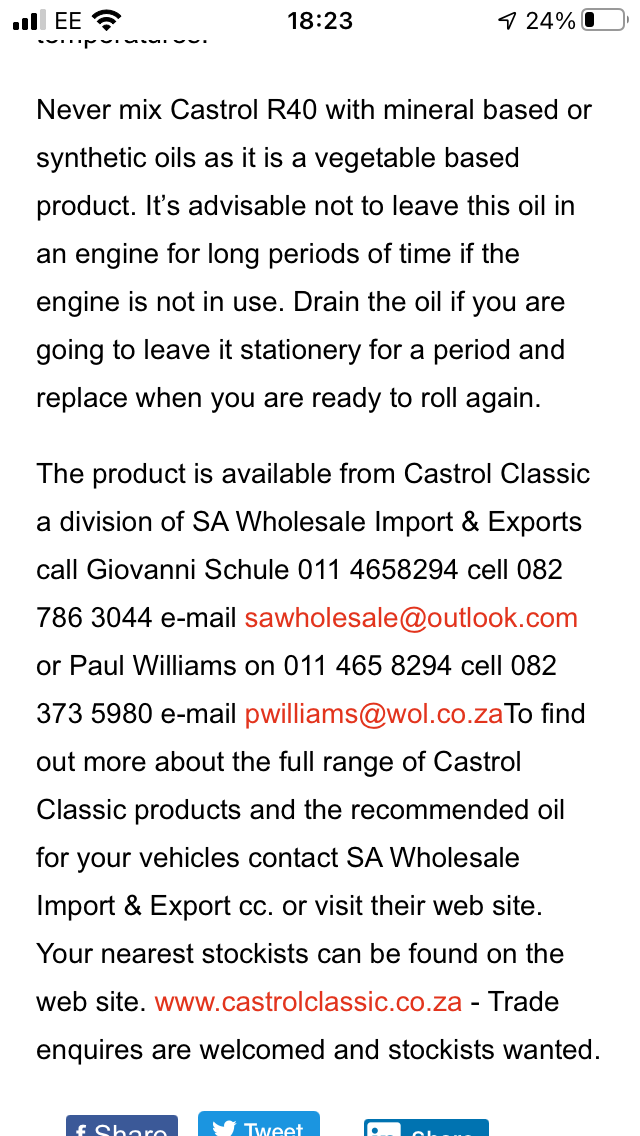

  4. R40 is for 4 strokes , R30 is for two strokes , and if you want the lovely smell ,just put a teaspoon full in the tank .

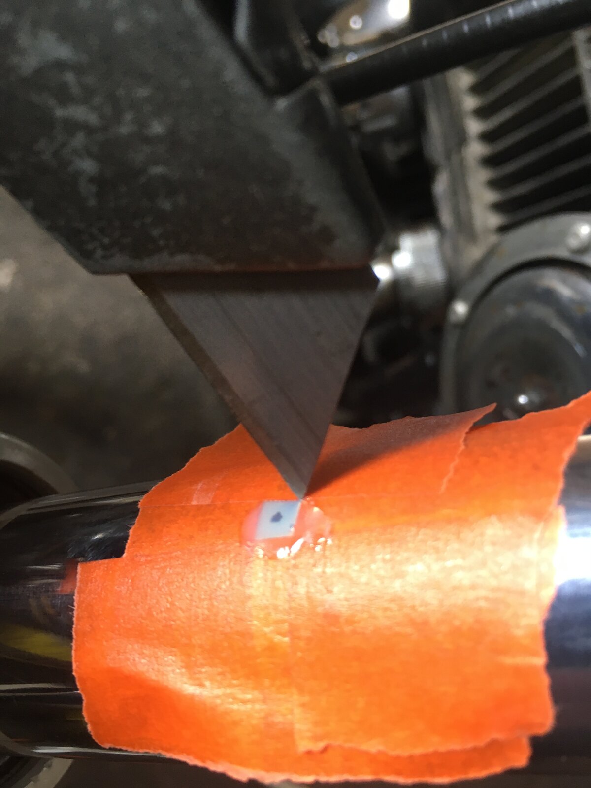

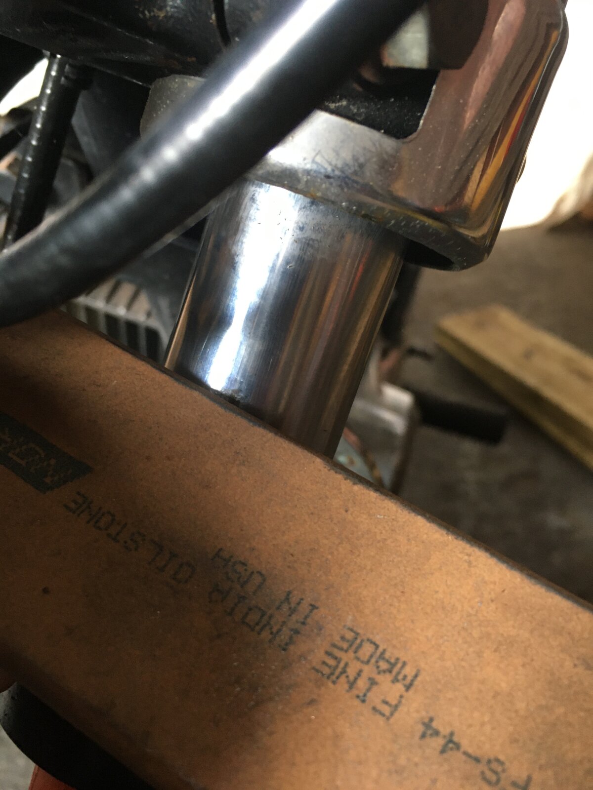

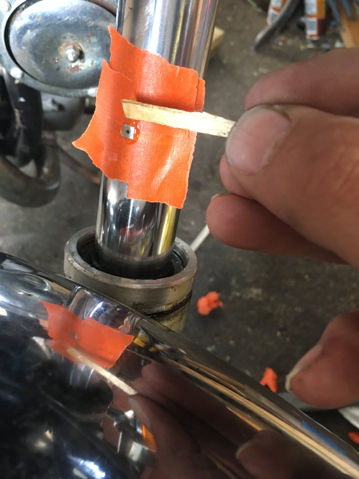

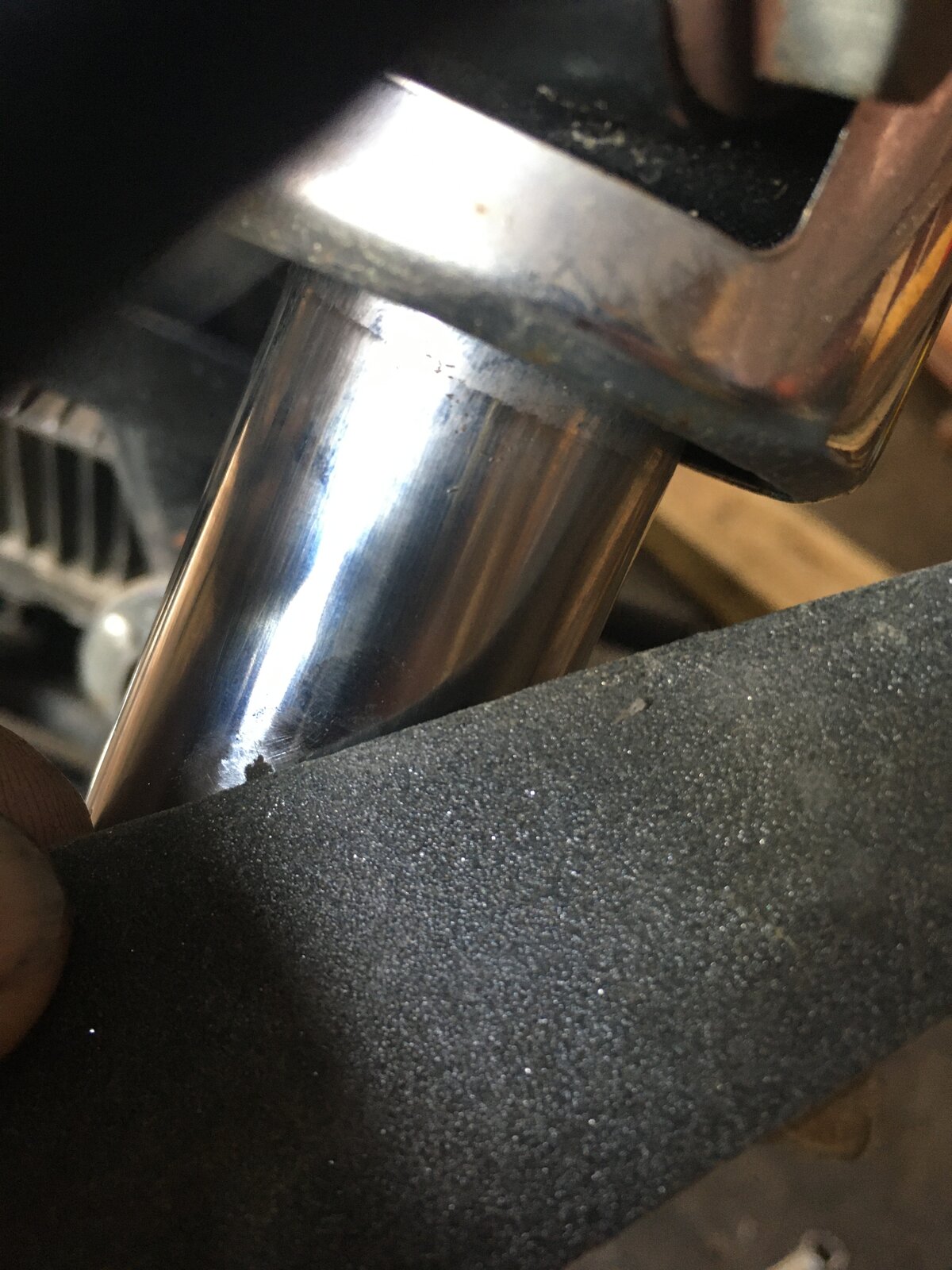

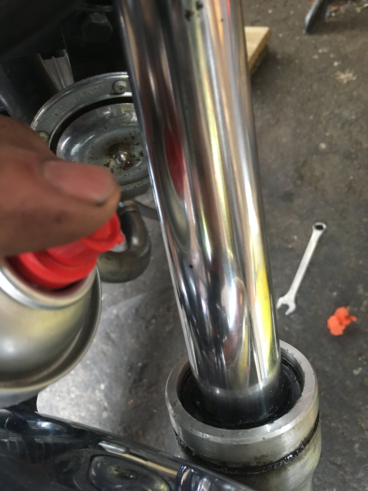

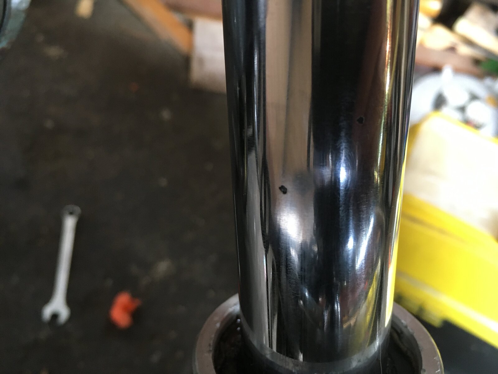

  13. I like to start with “today’s improvement” but today it’s “today’s bodge”, temporary repair to the fork stanchions before sending away for rechroming in the winter, I’m fitting new seals tomorrow so that I can get it MOT’d in a few weeks time.
    Several pits in the chrome which have sliced the seals causing the forks to leak.
    Fix - Go over the edges of the pits with a fine oil stone, and then 1800 grit Emery paper, then 2000 grit to smooth the edges.
    Mask off then apply Araldite, smooth down with 1800 grit then 2000 grit.
    The end result is visible but absolutely smooth, it’s impossible to feel the repair once it’s smoothed so the new seals when fitted should be fine, here’s all the right photos, not necessarily in the right order.
    5991222A-17B5-40EF-8E51-65ED5E4D5CE2.jpeg BD69157F-B89C-4D16-94C4-F17C90531FA9.jpeg 930715AC-1776-4176-B971-6B31A900EF9C.jpeg F98EF466-C551-4927-9E24-51650CBFDDB9.jpeg 79FBB780-DC5C-4E7F-8235-30CA59E29B1E.jpeg 54CA8552-2649-4B0B-BD94-136E62D30C30.jpeg

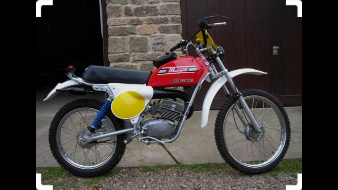

  19. You say that Jez but my Malagutti Monte we leave both in a haze of blue smoke :) 27691F40-05D3-44E5-B8F2-096E75346F3E.png
