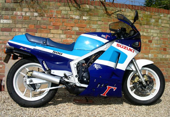

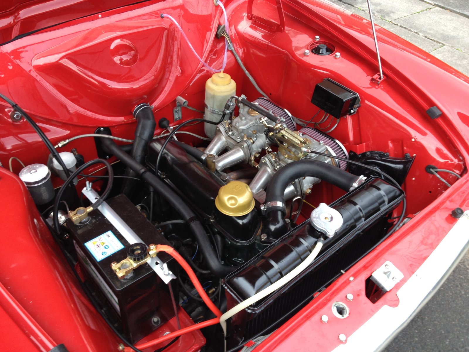

  1. Still got the original motor, but I built it to Cosworth spec so runs a genuine Cosworth a2 camshaft, lotus elan sprint spec valves, lotus rods, lotus oversize Pistons, flower head, twin 40 webers. It's 105hp, original spec was 78 for the GT so nice improvement and goes well. Sounds great too.
  2. That is one hell of bike right there. I longed for one in the 80's :upyeah: Saw this yesterday and although it's very nice I still prefer the untouched look of the original though.
    Ebay

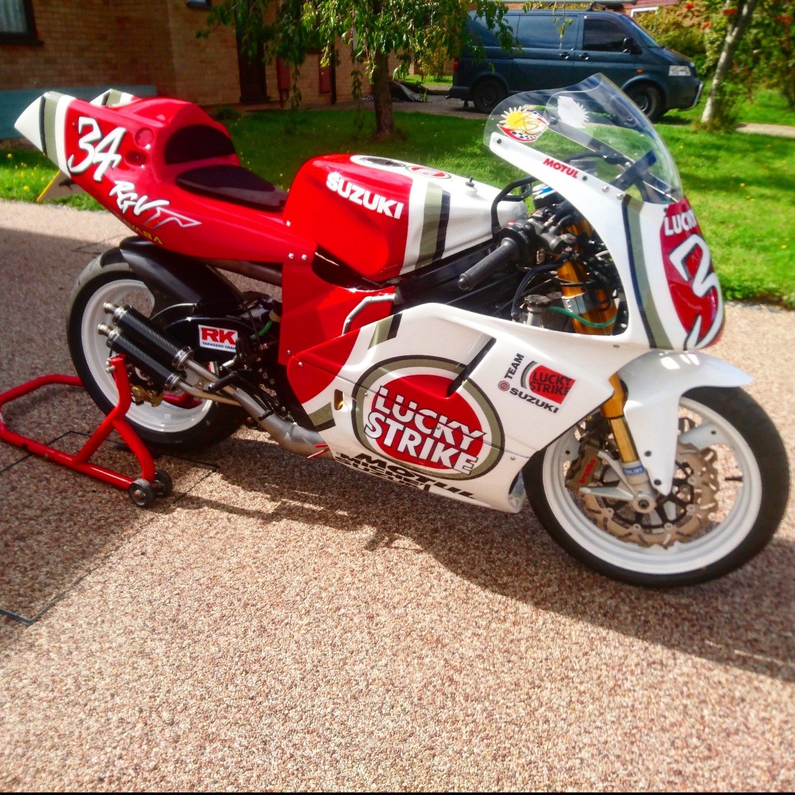

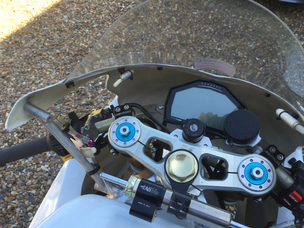

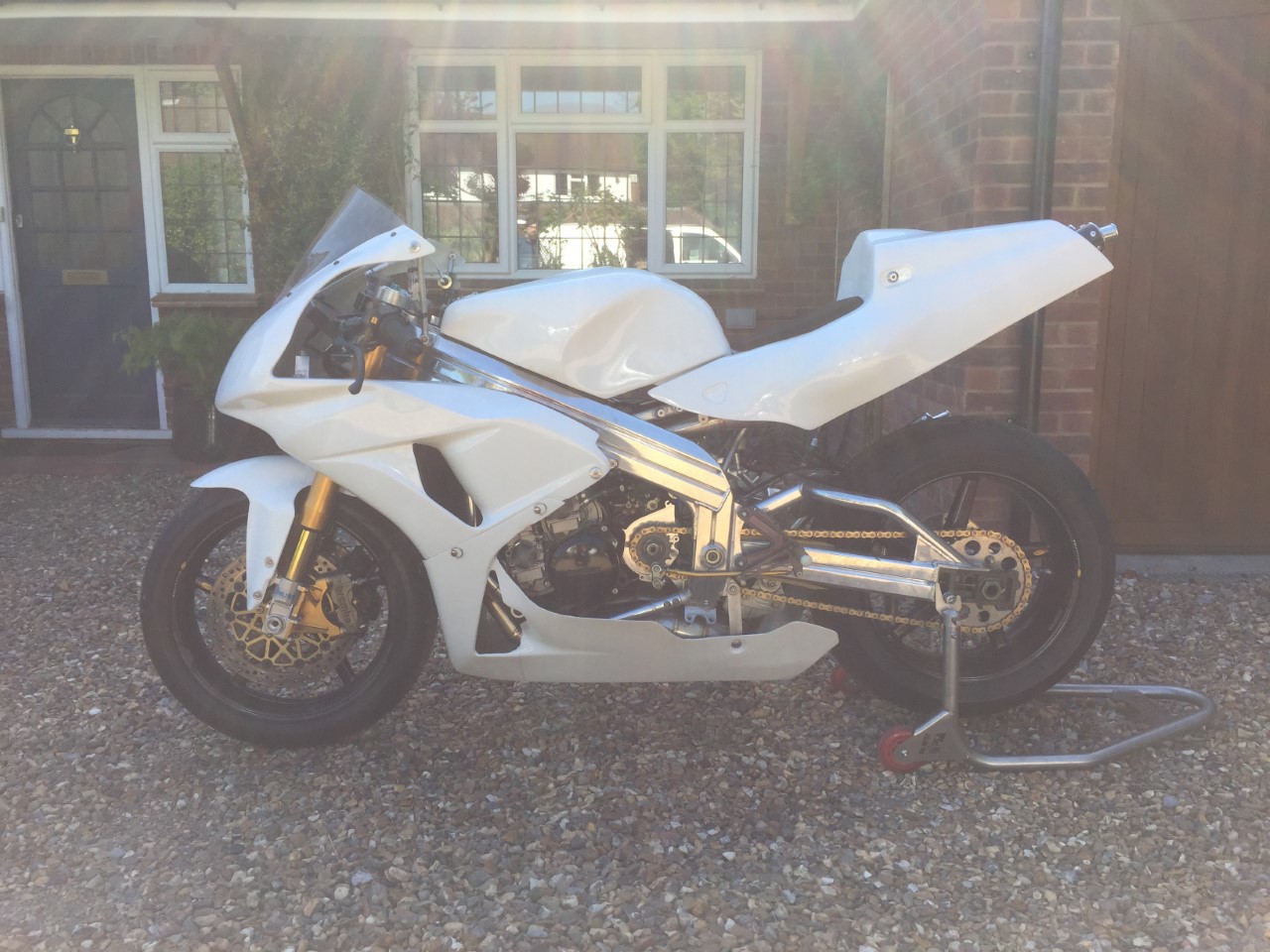

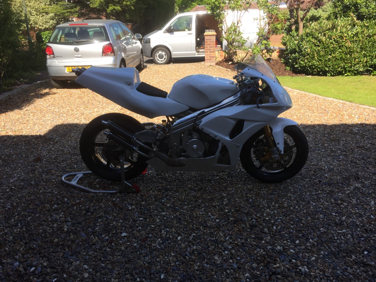

  3. As 2 strokes are being shown, hope it's ok to show some pics of a mates RG Spondon?
    rg1.jpg rg2.jpg rg3.jpg rg4.jpg rg5.jpg rg6.jpg rg7.jpg rg8.jpg rg9.jpg rg10.jpg
    • Like Like x 11

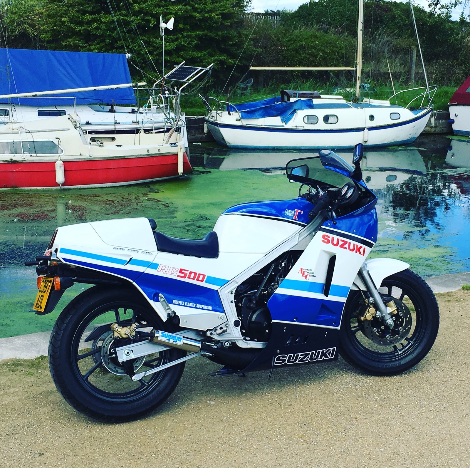

  4.

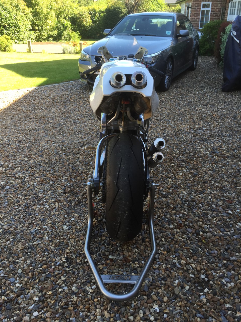

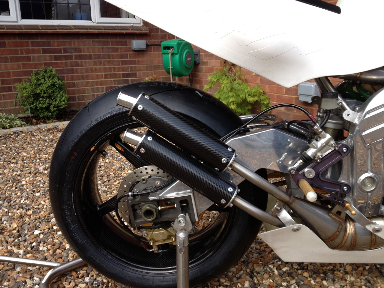

  5. Beautiful bike, just one tiny thing, why are the tail exhausts not central ?? (Or is it just the photo ??)

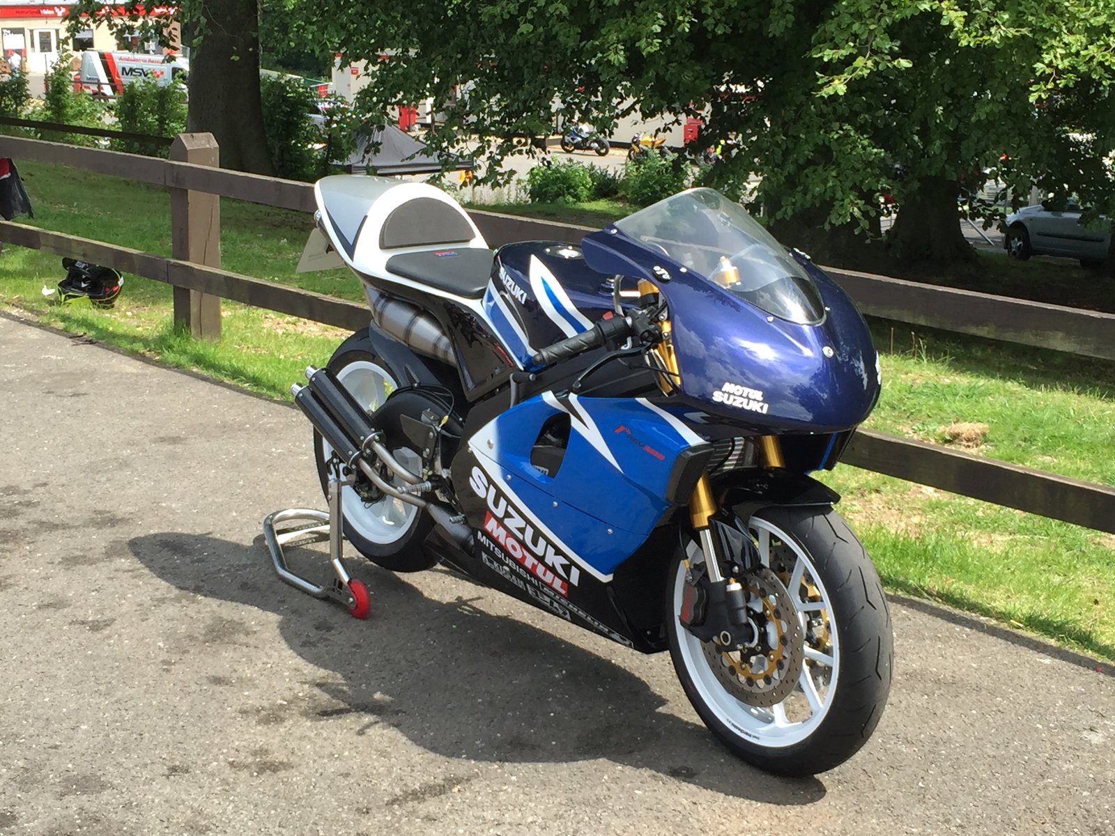

  6. All finished up and ran in now. Had practical sportsbikes editor Jim Moore round last week to write up the article for next months edition. Looking forward to that.
    Bike is running a dream and goes like stink
  7. Ready to flog it now then? :p
  8. Actually, I had a couple of offers but have declined as decided to keep it! A chap in Norway offered me £14,500 for it..

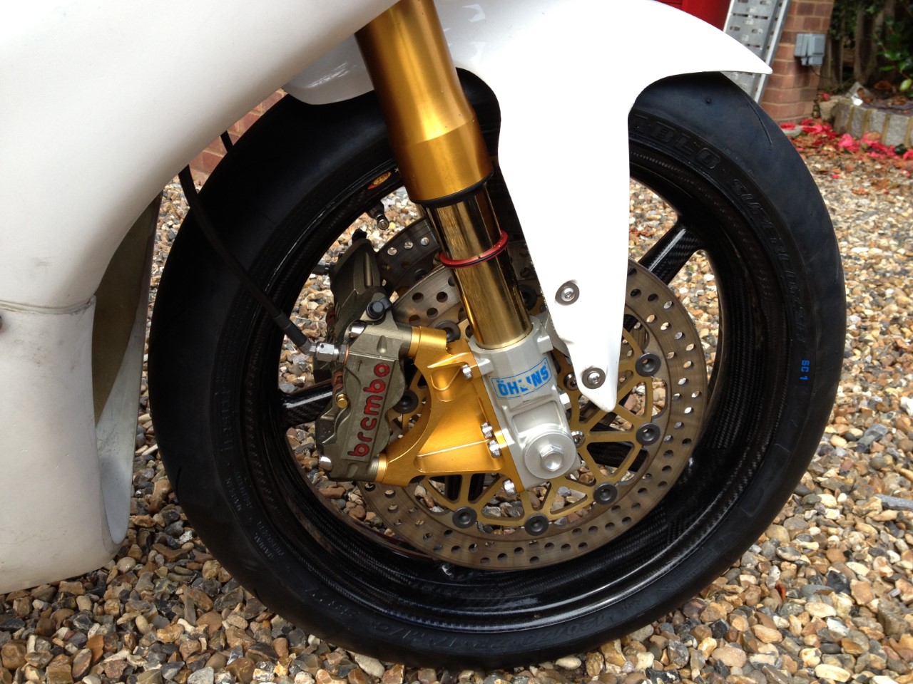

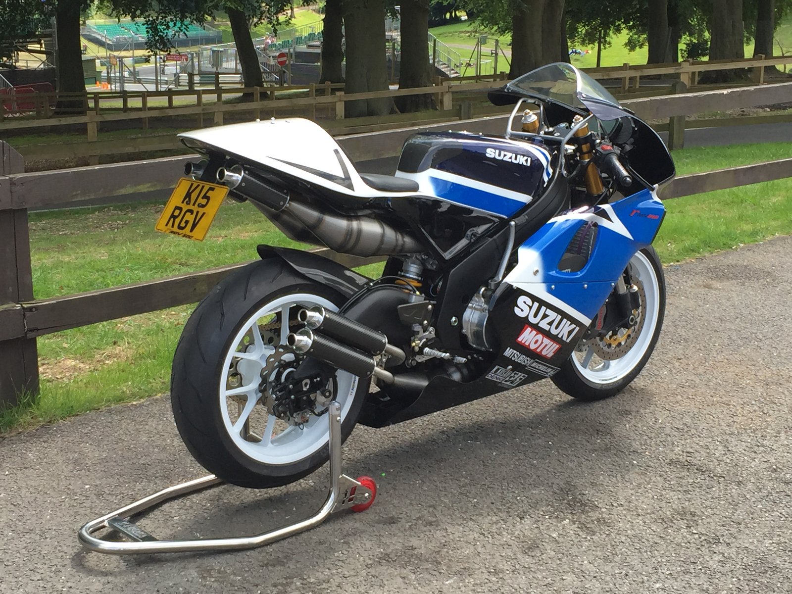

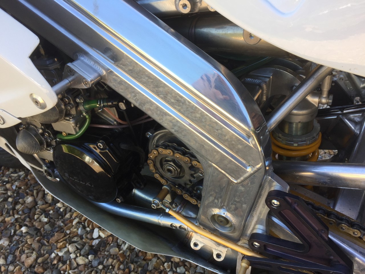

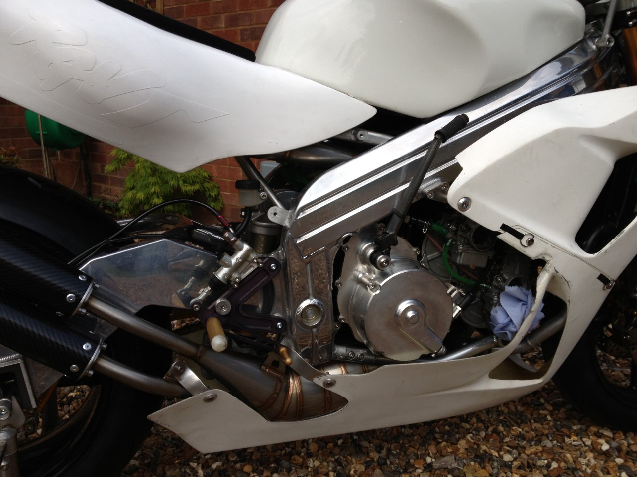

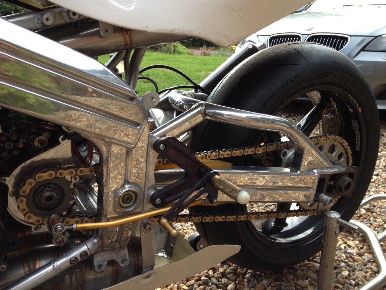

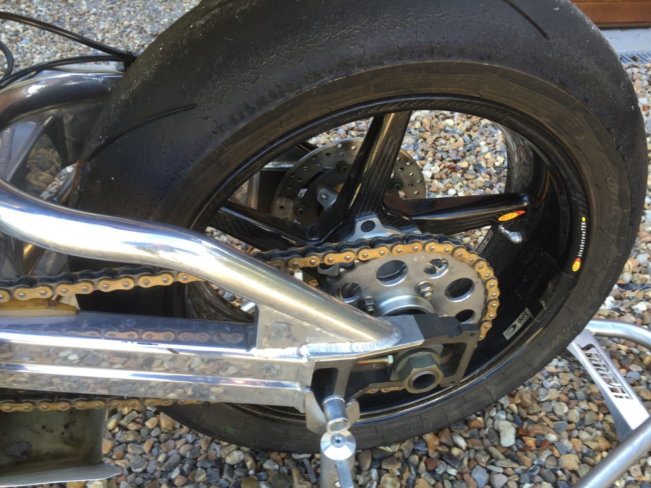

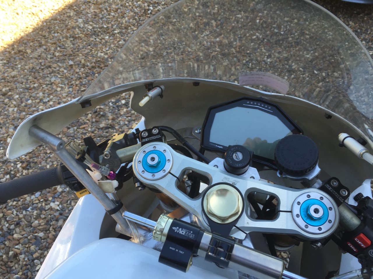

  18. On the Subject of RG5s. Heres my Mark Dent built RG5 motor in a RGV250 frame. Been a Labour of love over the last ten years!
