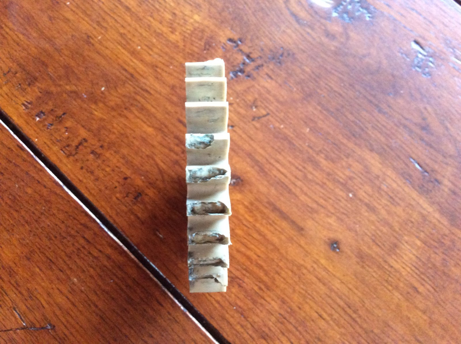

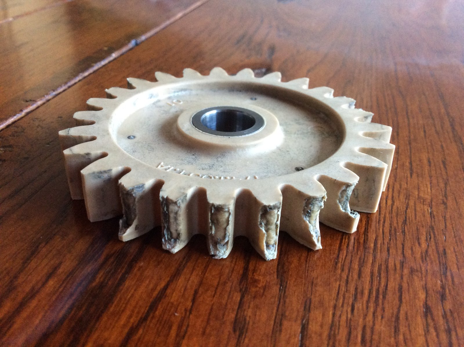

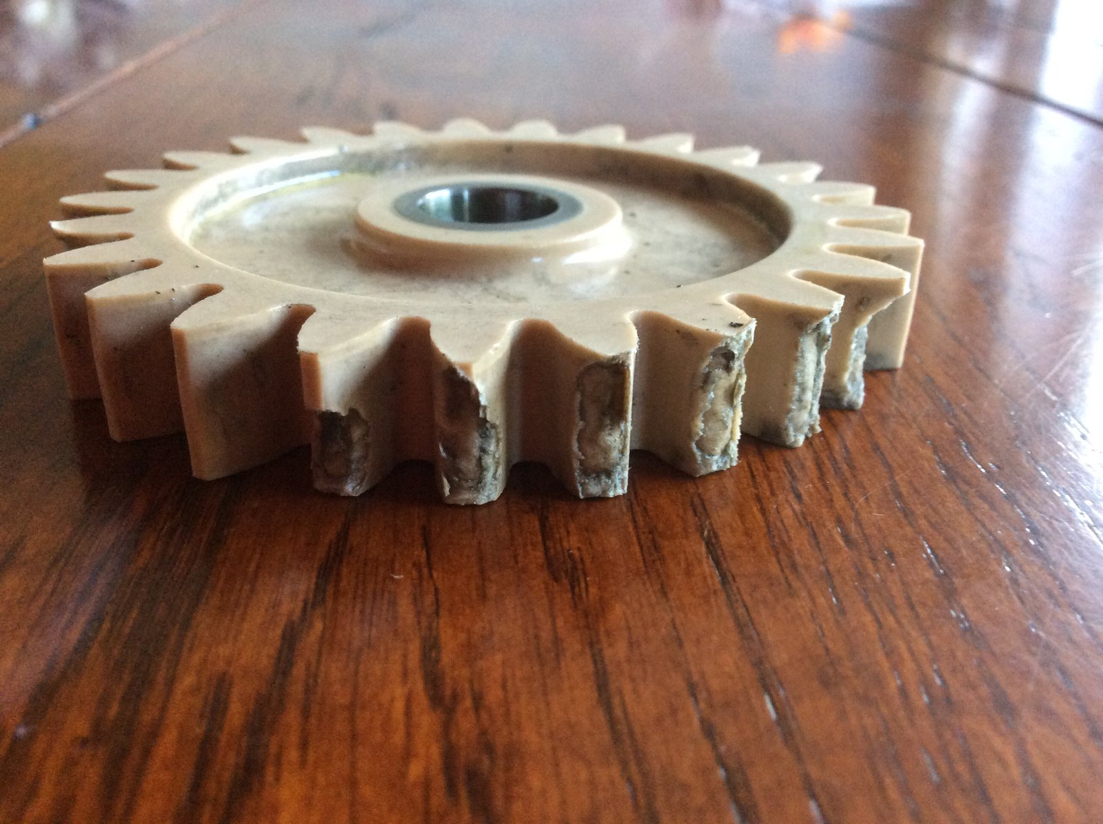

  7. image.jpg image.jpg image.jpg So as mentioned earlier, we’ve got to the bottom of bits in my oil.
    The small rectangular bits in the OP apparently are from assembly of the alternator. That’s not what I had though. I had the missing bits of the water pump plastic cog, see pics for tooth wear.
    This is what happens when you work a V2 Panigale hard. And yes, I’m told it’s the same design in 1199, 1299 and R.
    The advice I was given is if you ride your bike on track a fair bit & work it, you should consider getting this cog checked and view it as a service item. To fix, it was roughly a 3 hour job plus parts. Few hundred quid.
